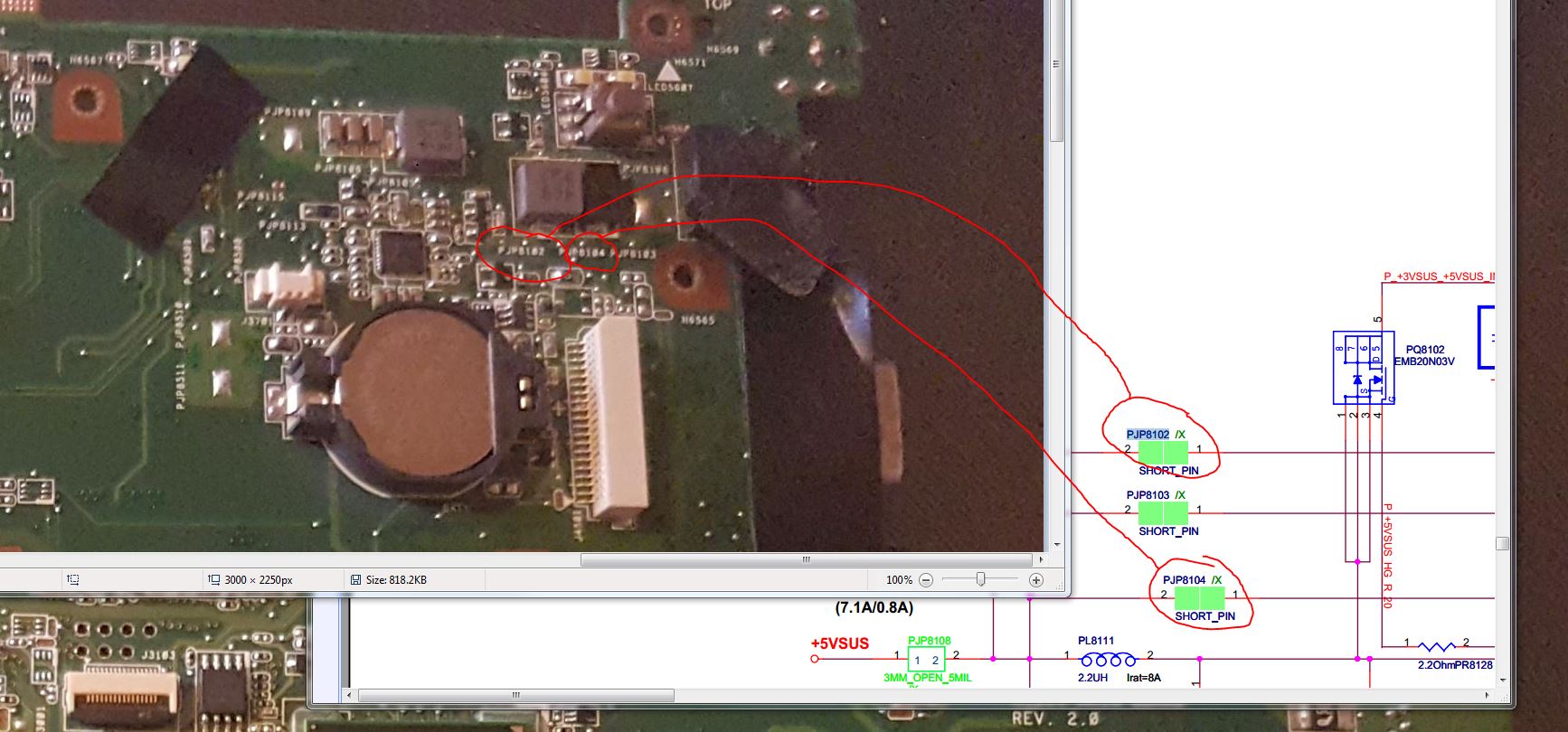

    Schematic page 81, check resistance to ground at coils PL8111 and PL8110.

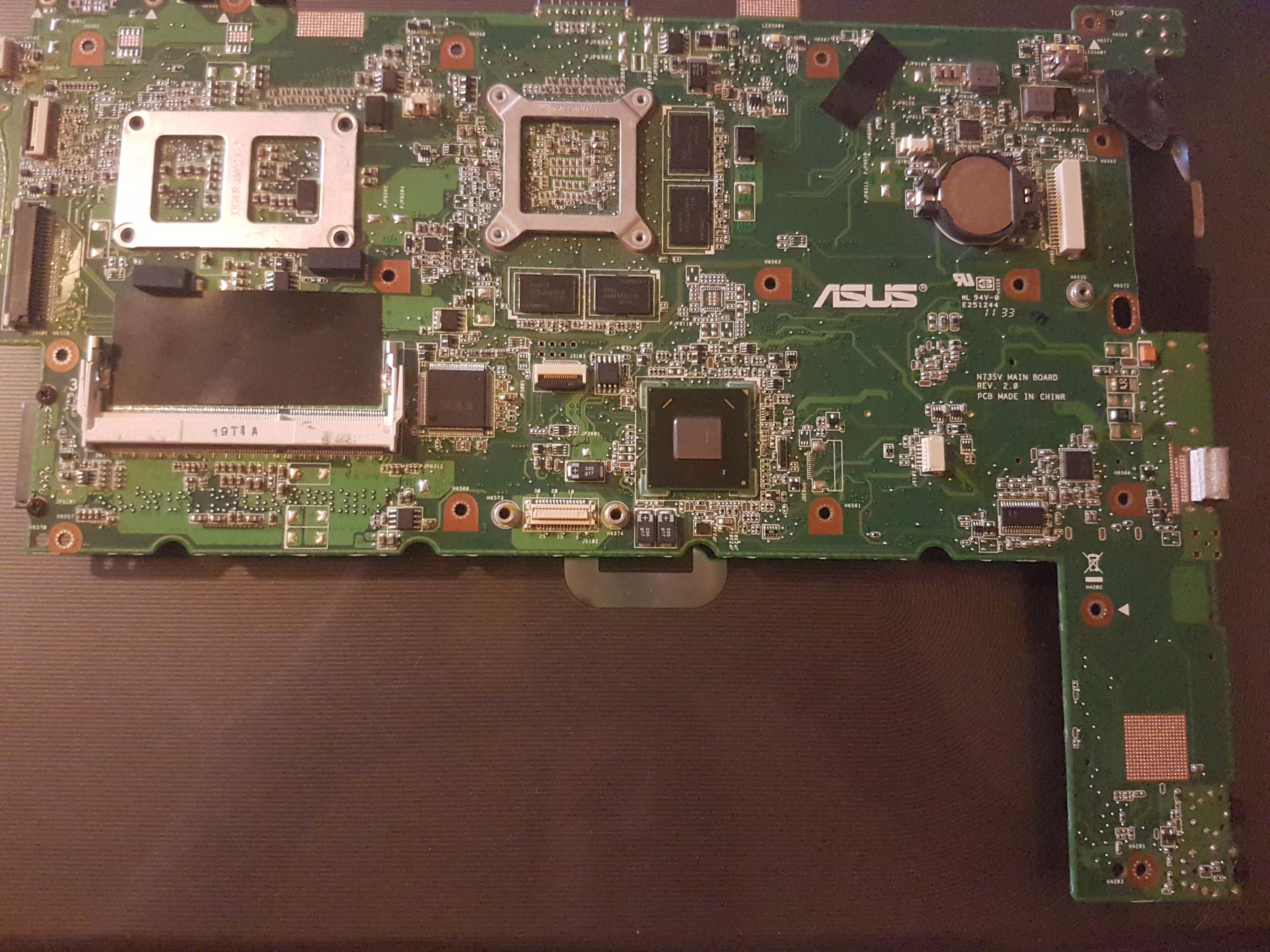

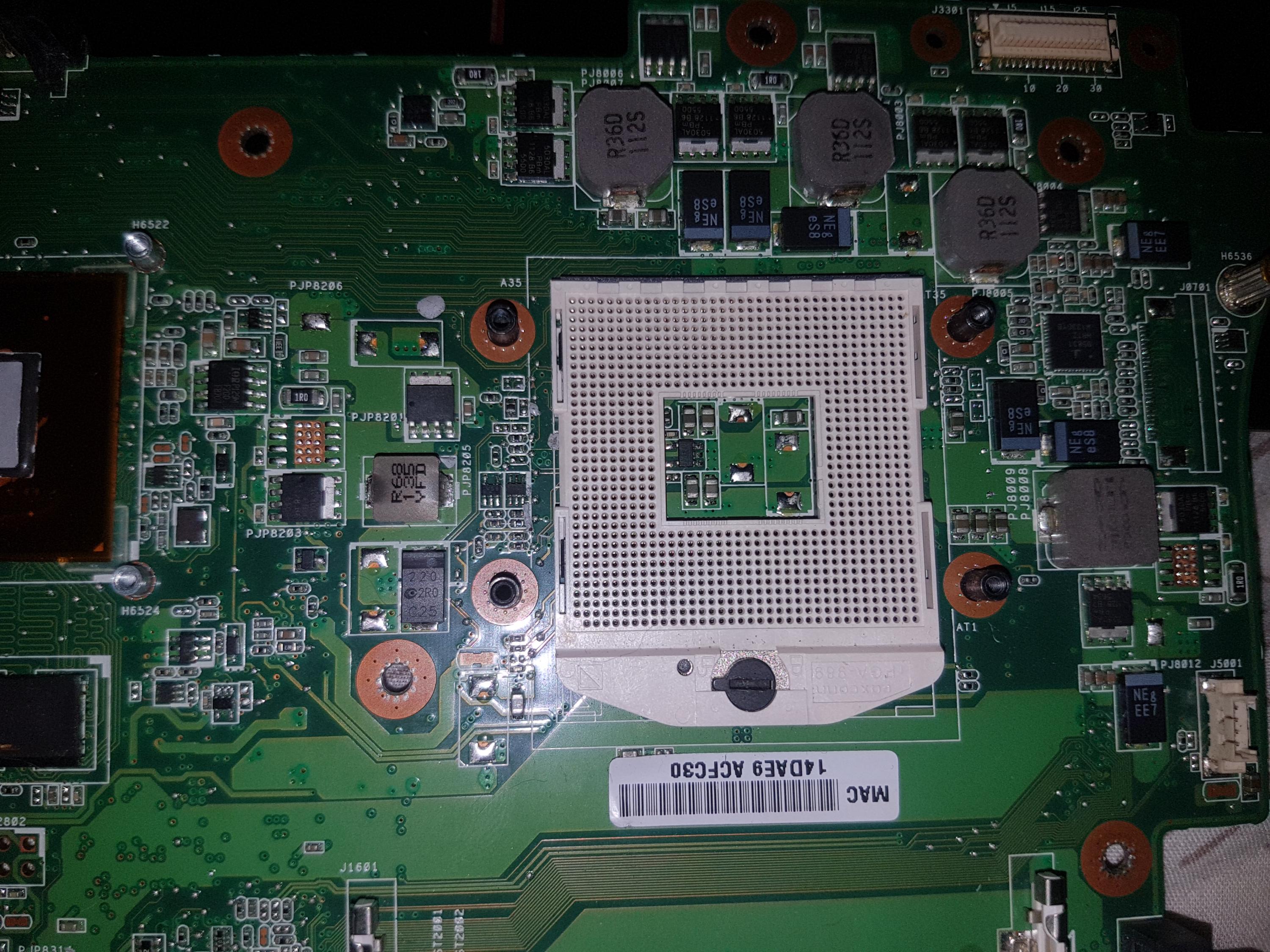

      I cant see it i know its left and right from the cpu... here is the picture can u mark those 2 points for me?

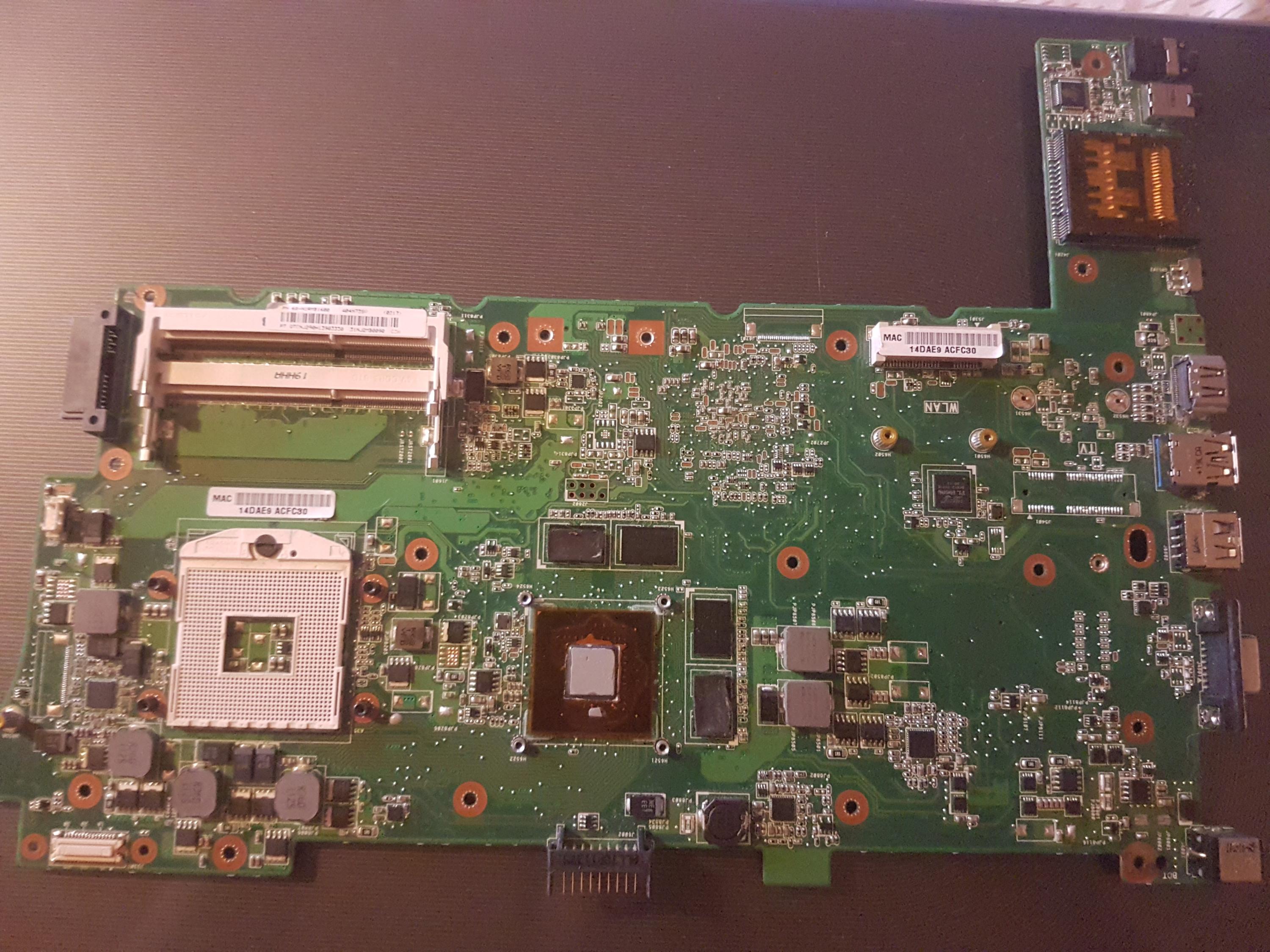

        Re: How can i locate the short on my Asus N73S
        It's not normally near the CPU, why do you think it's there ?
        Can you get decent photos of both sides of the complete motherboard.

          Like i sayd before im really bad at reading schematics... but if i read page 81 it looks if its a round the cpu.. here 2 pics of the mainboard.
            PU8101A in the middle of page 81 is smaller than your small finger nail.
            Looks to be near the CMOS battery.
              Is the schematic ok? because on the motherboard i cant find it...? Mainboard is N73sv Rev. 2.0 and the schematic is rev . 1.0 ...
                It might not be identical but it's close. As you can see from my capture, the markings on the board tie in with the schematic.
