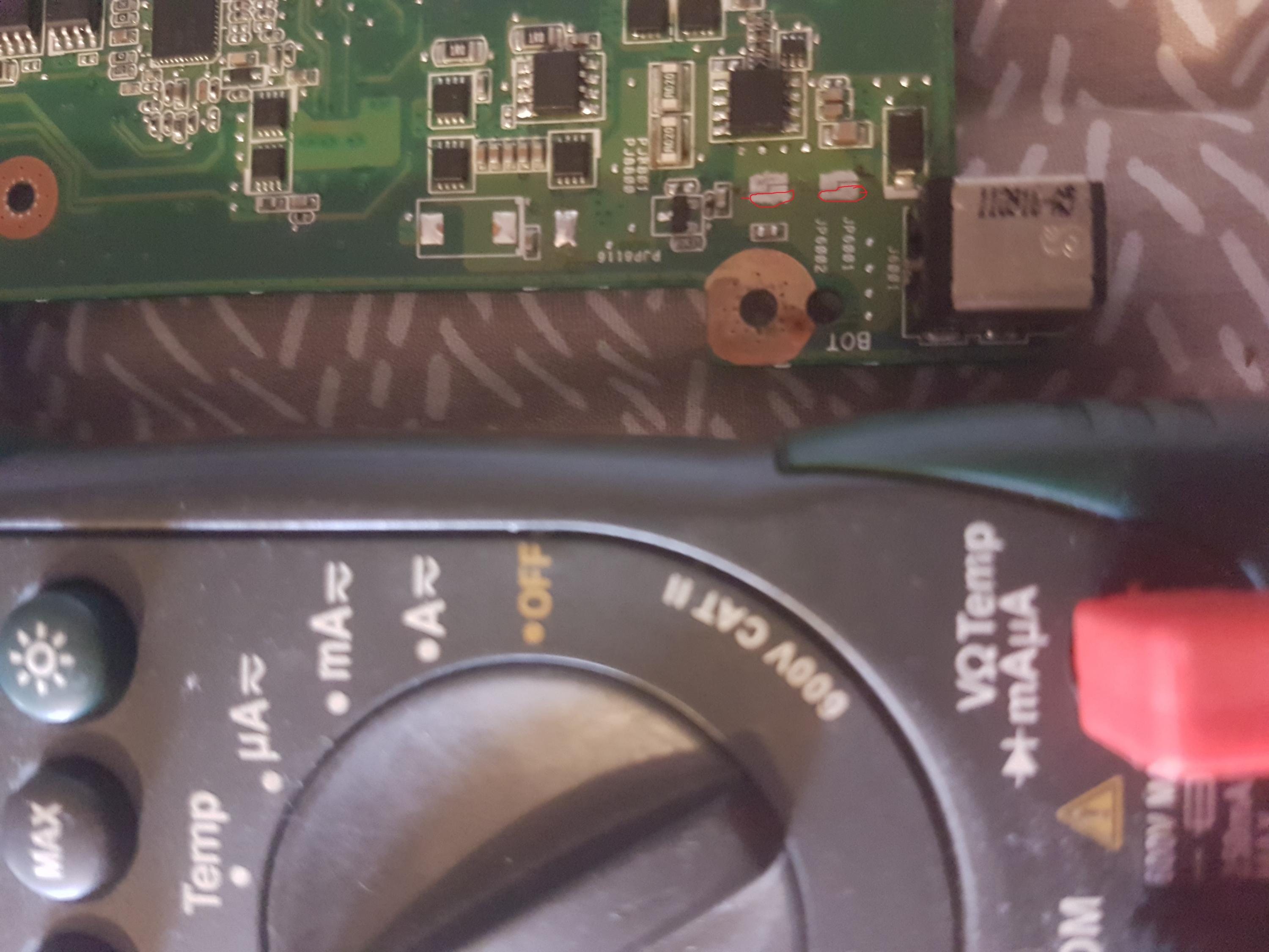

            First you need to determine where is the short, remove JP6001 and JP6002 and with a DMM check the resistance at both sides, maybe PD6000 (TVS diode got shorted), you need to isolate parts of the cirtuit to discover the short.

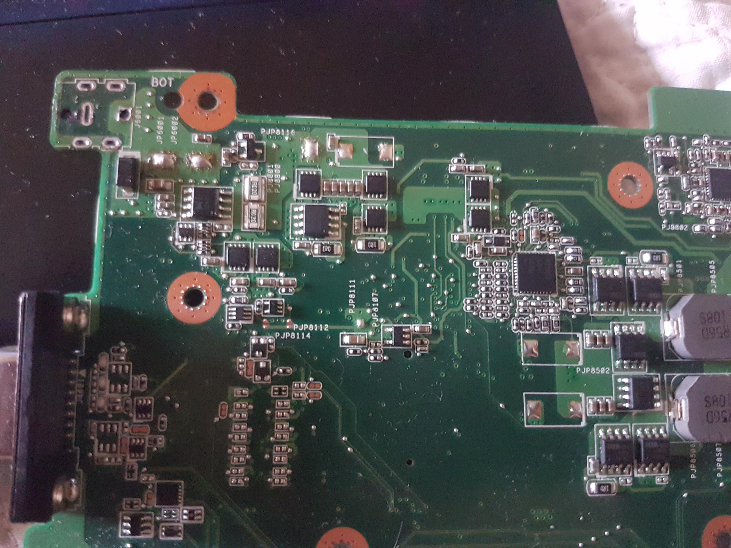

              Can u mark it for me on a picture wich 3 ? When i look at schematics i dont understand it... im handy at some things but not with schematics

                Re: How can i locate the short on my Asus N73S
                pic
                • diif
                  • Feb 2014
                  • 6978
                  • England
                  Top left in your photo.

                    So i need put the power on those 2 solder joints?
                    • diif
                      • Feb 2014
                      • 6978
                      • England
                      No, he's suggesting you remove the solder at these two points which then reveal a break in the trace and you can test which side has the short with your multimeter.

                            I desolderd those 2 pads...wich area should i check? ... is there not a easy way like put amps on it and see if a component heats up? if so where should i solder the wires...

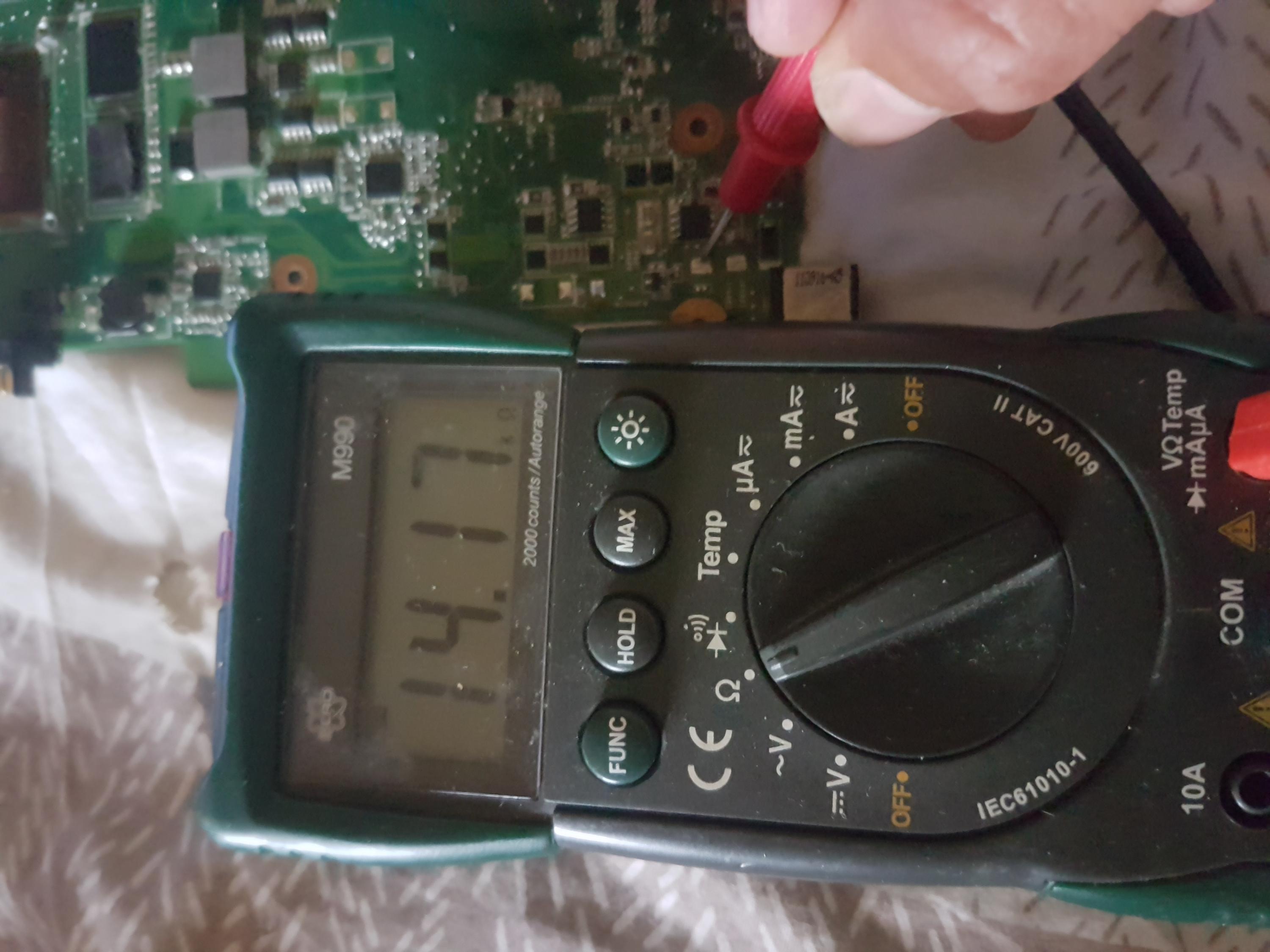

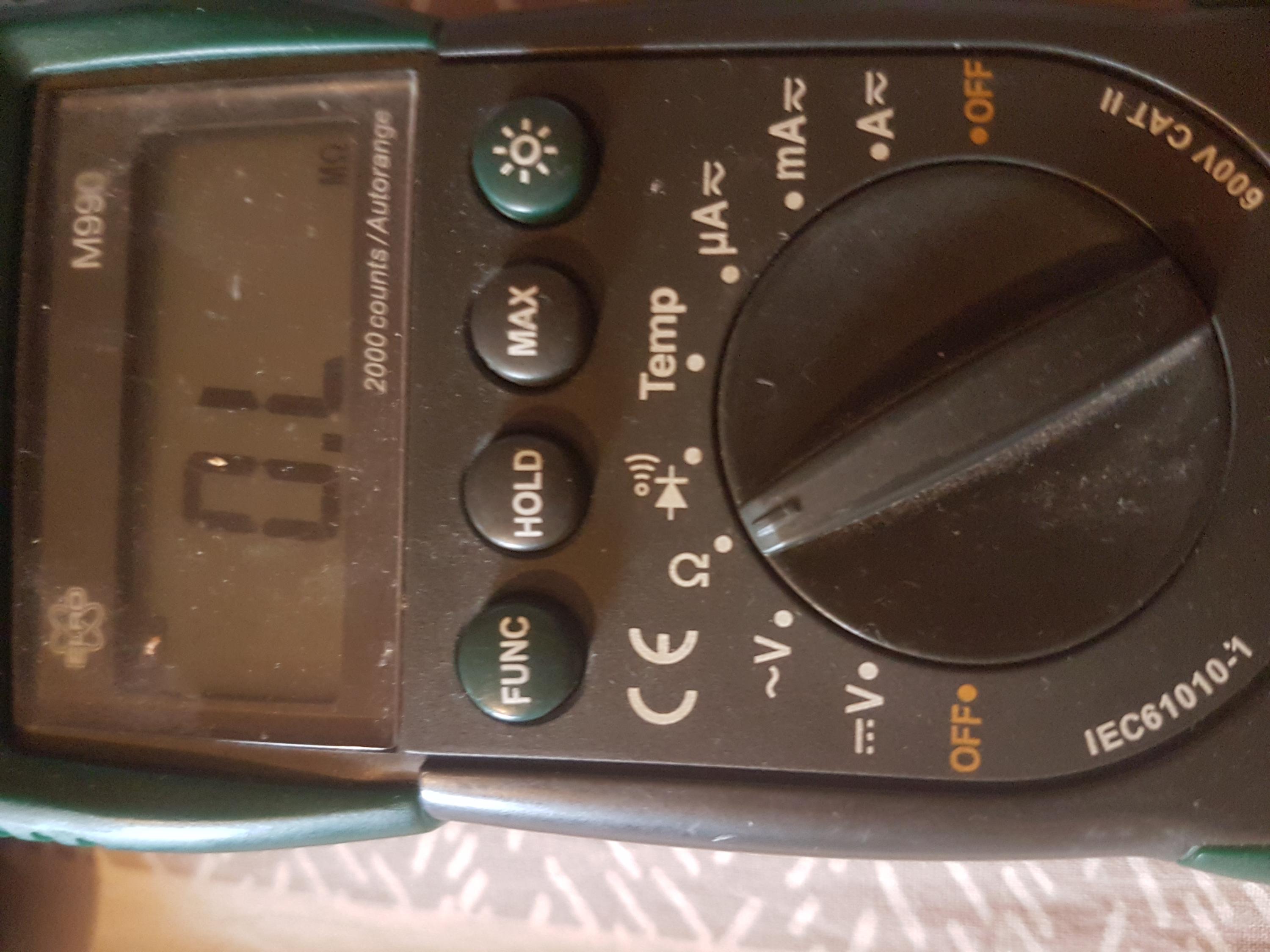

                                I tested it i marked it for you on the picture... on those 2 pads no value in the other 2 i see some... is that the right setting on the multimeter?
                                • diif
                                  • Feb 2014
                                  • 6978
                                  • England
                                  Yes the correct setting. What's it show the other side of those pads ?

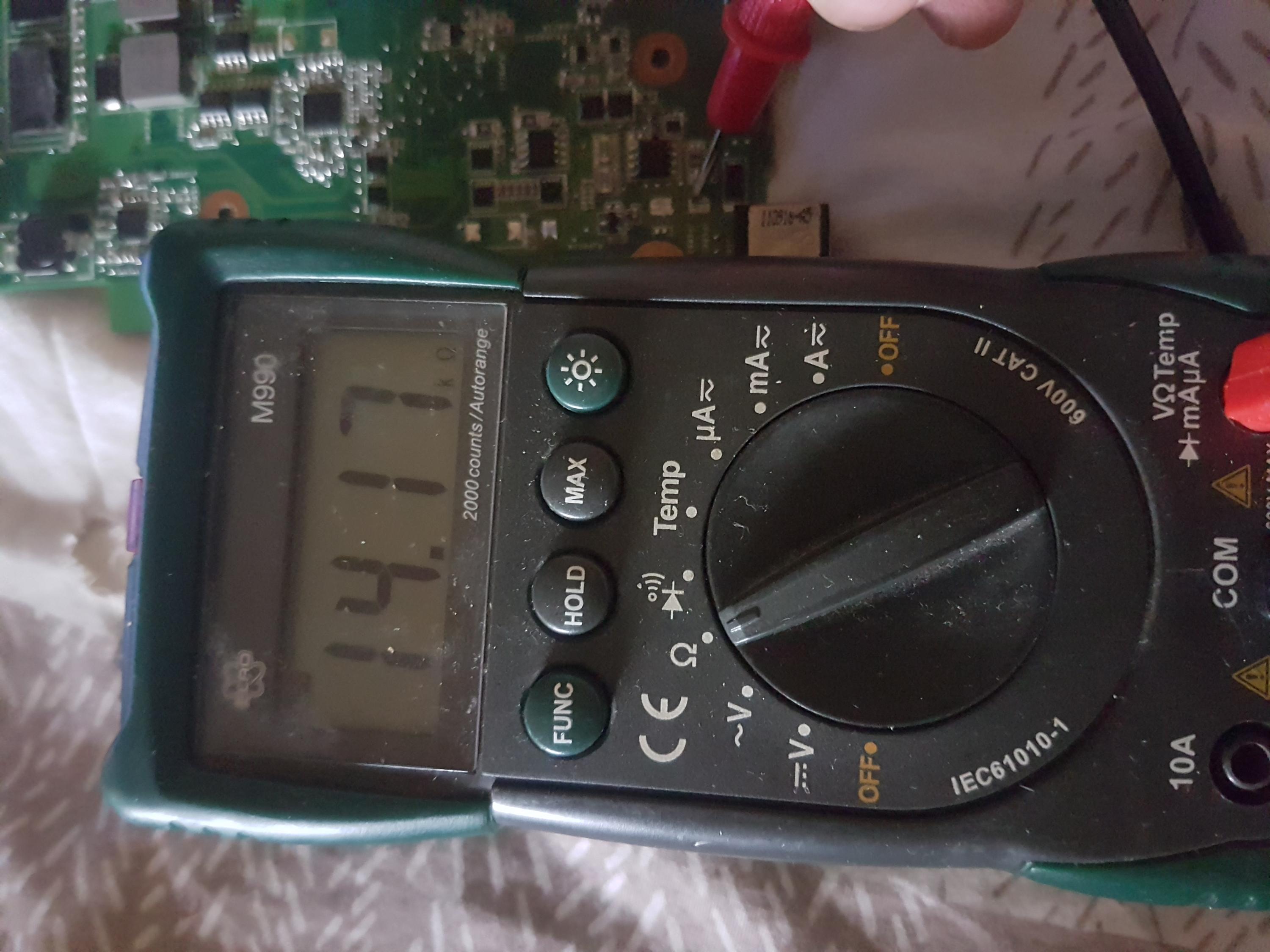

                                    On those other two the value wil climb up to 14.7k see the picture!
                                    What should do next? i tried two find a boardview file but overal i checkked u must pay for it... My schematic reading is bad!!!
