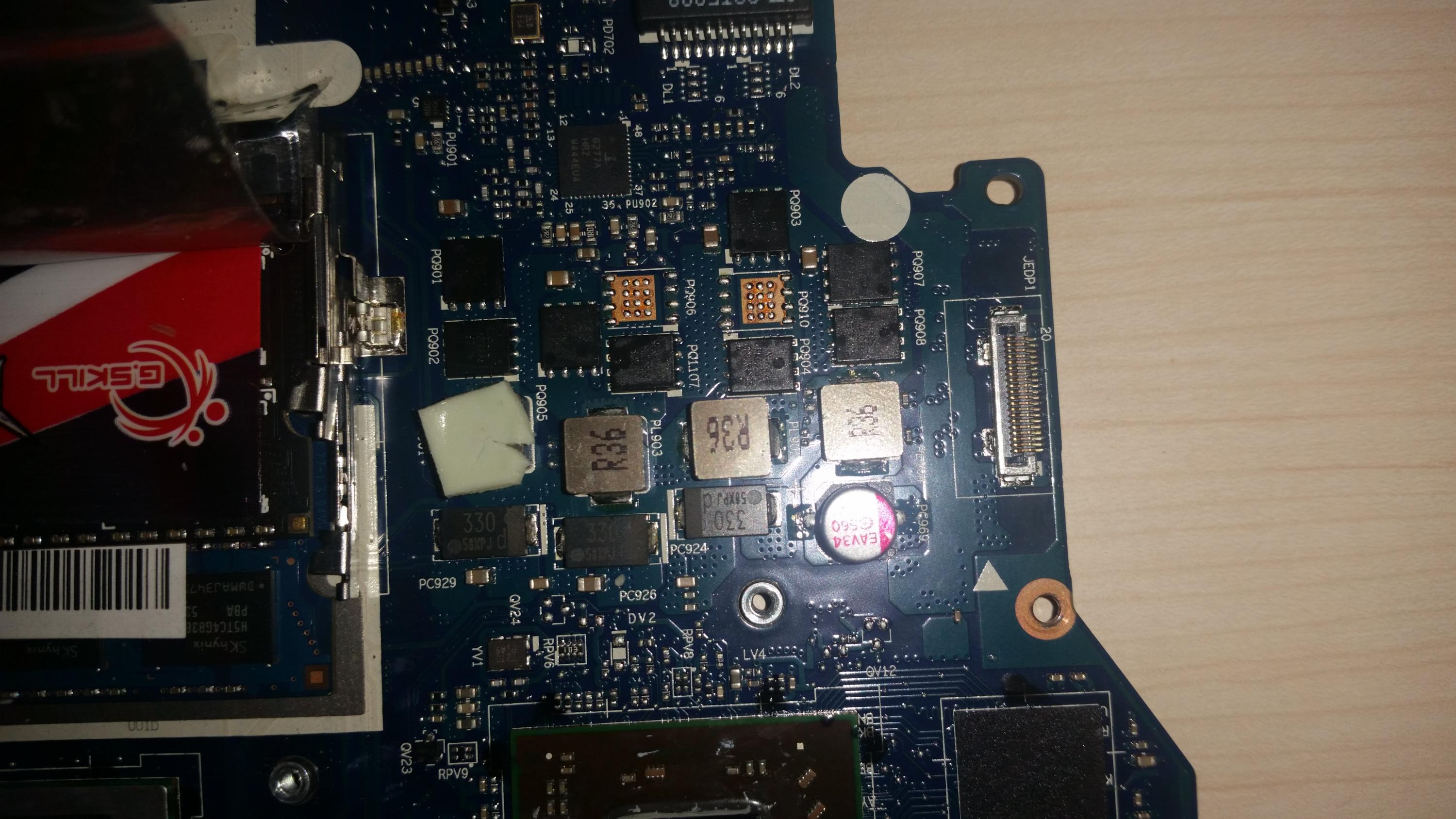

    A little while after replacing my screen (because i got a deep scratch in it), the eDP-Cable broke, probably shorting the pins for the backlight.
    Apparantly it blew a fuse or some kind of 0 Ohm resistor.*
    However i don't really have much experience with PCB, so i hoped you could help me identifying the damaged parts.

    I also attached an image of the underside of the eDP/Screen cable socket.

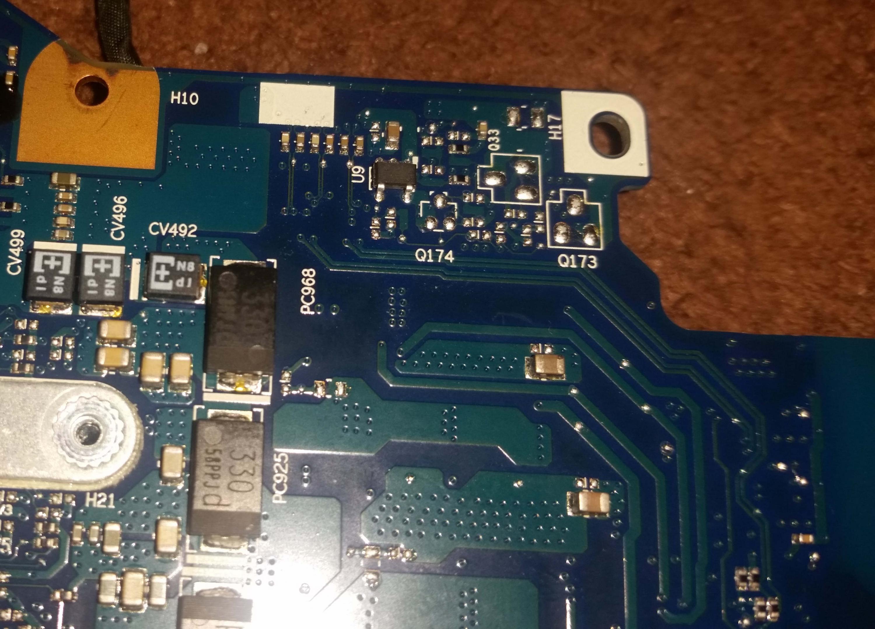

    make a picture of area around lcd connector...
    based on schematic q33 could be bad but it`s not installed...you should check r17 ...Go back from 24,25,26 pins of lcd connector,you should be able to find it and check it`s resistance...

      I uploaded a pic of the connector area now, maybe someone can figure it out for me.

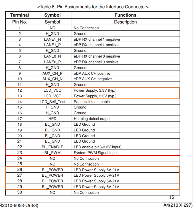

                      First panel datasheet is not available for free, second panel only 41 and not 42, anyway should be the same pinout.
                      For backlight pin 22 (3.3v) and pin 23 pulse width modulation input
                      https://en.wikipedia.org/wiki/Pulse-width_modulation it's important to know what we do .

                          So this time i had the display plugged in and measured the pins on the display itself.
                          I got Pins 12 and 13: 3,25V
                          Pin 17: 2,37V
                          Pin 22: 3,25V (went to 0V when i pressed FN+F2 - hotkey to turn of display backlight - , so it's working as it should)
                          Pin 23: -11mV
                          Pins 26-29: 20V
                          What would be a reasonable value for the PWM-Signal?

                            Pin 23 should be 3.3v
                            Put a jumper on pin 22 and pin 23 of display panel, see if backlight comes at full brightness.
