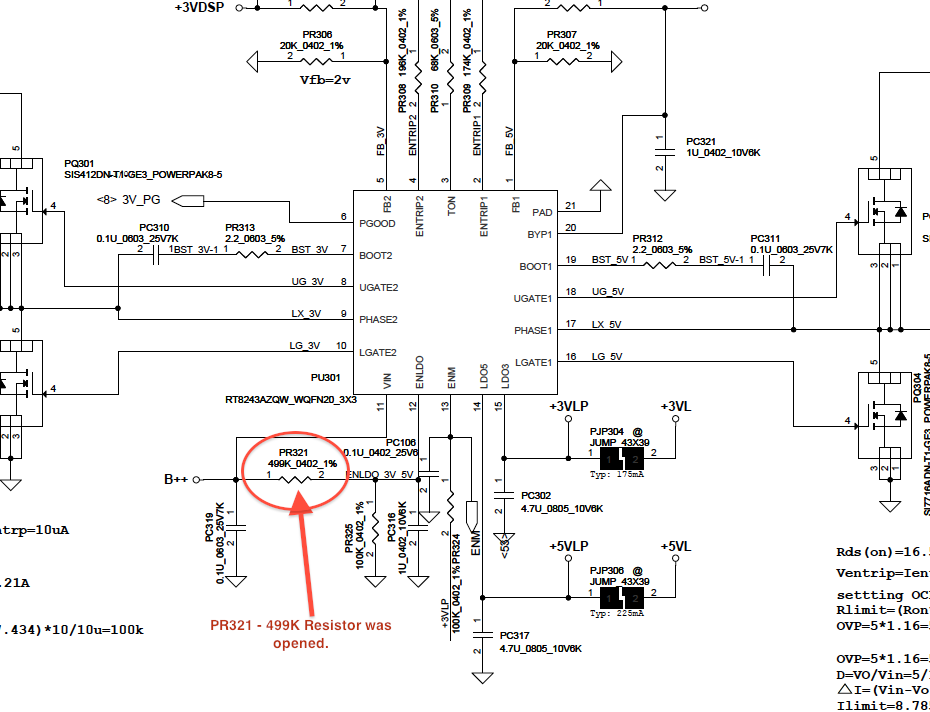

    Hi friends,
    I had a problem on HP Probook 450 G2 Laptop. The charger indicator ( Orange light ) was blink. I checked 19V line and FETs Everything working fine. I replaced the charging IC BQ24736 by BQ24725 ( Checked Datasheet was Same ). But no use its doing the same. I check The DC/DC Converter ( 3V /5V). checked LDO 3V is ok. but on LDO 5V is showing 3.98V and the output coils( 3v/5v ) not showing and voltages. So i try to find the replacement for RT8243AZQW. But i couldn't find and finally i ordered it on ebay. after two days i got free time to check this again. I check all resistors and capacitors around RT8243AZQW chip. Finally i found PR321 ( 499K ) was opened. I replaced it now the laptop working fine.

          Re: Case studies
          Originally posted by raajkumar
          Hi friends,
          vin and enable signal si first to check, but good work

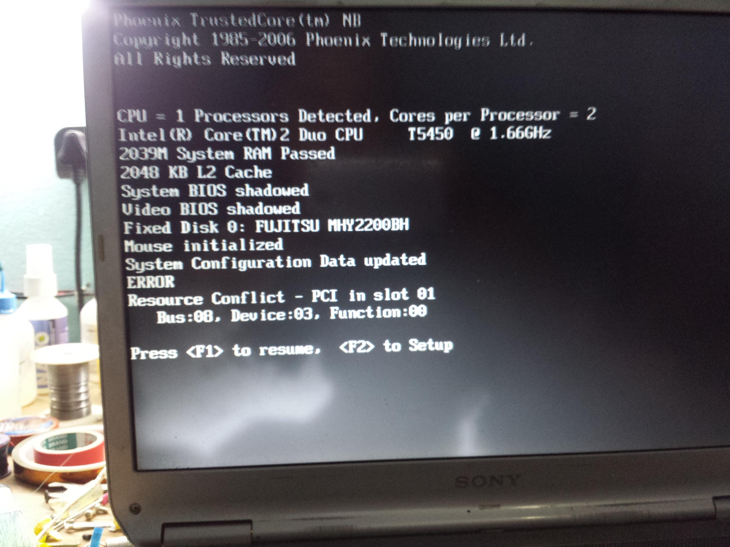

                    Re: Case studies
                    Sony laptop (forgot model)
                    Problem: power on but sometime display sometime no display.
                    If display comes bios post produce error "Resource Conflict -PCI in slot 01 bus:08, device:03, function:00"
                    Solution: Removed card reader ic, problem solved.

                      Re: Case studies
                      Problem solved?
                      NO
                      • dspok
                        • Jan 2014
                        • 553
                        • Nepal
                        Re: Case studies
                        Yes problem solved. 100%
                        • ktmmotocross
                          Boardkiller
                          • Feb 2014
                          • 3627
                          • slovakia
                          Re: Case studies
                          so your card reader work without its chip?
                          NOT SOLVED
                          if u solved it, then your card reader will work
                          • dspok
                            • Jan 2014
                            • 553
                            • Nepal
                            Re: Case studies
                            NOT SOLVED
                            Hahaha, you are right inbuilt card reader will not work but at least no display and display error is solved.
