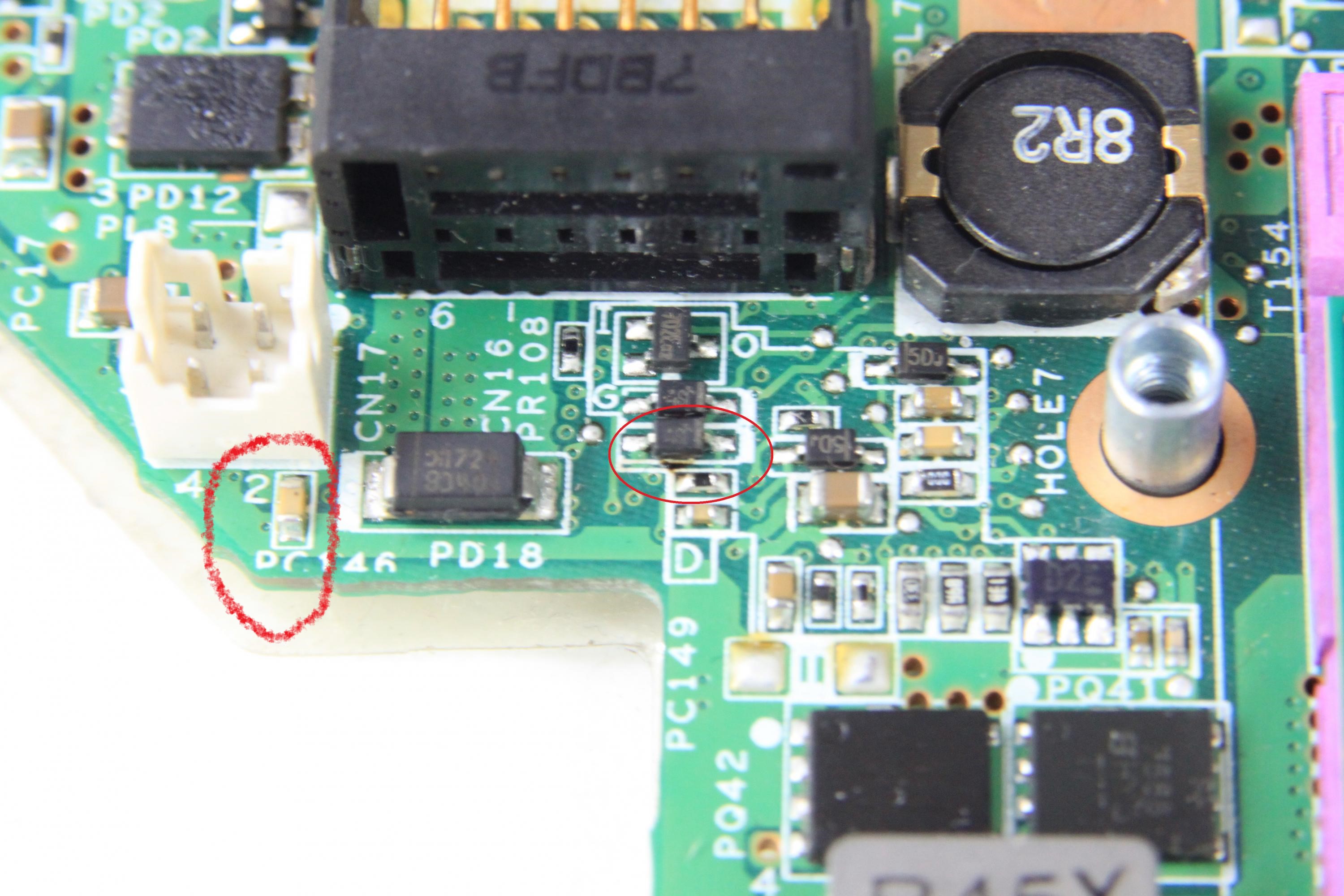

    Hi there,
    I was trying to start my friends DV6000 by shorting the terminals where the flat ribbon connectors locate to the power button and the cap circled in red next to the power in plug blew.
    My knowledge of schematics is not so good and I was hoping some could identify this caps value so I can try replacing it.

    Re: DV6000 Intel
    these laptop starts with shorting two triangles between conectors with these ribbons
    firs cap have under it label/looks like PC146 dont see first digit because of red line/
    second is in D. so look for D label on board where is labeled its label

      Yes I see the solder triangles but was trying to short the ribbon connectors.
      The Cap is the one next to PC146 but I do not see it in the schematic to obtain a resistance value

        Re: DV6000 Intel
        the cap net to it is diode PD18
        • rigeback
          • Mar 2011
          • 421
          • Malta
          Re: DV6000 Intel
          Yes but PC146 = 10U/25V_12 on the VIN line, this does not seem to be the correct value of the cap that blew

            Re: DV6000 Intel
            why?
            • rigeback
              • Mar 2011
              • 421
              • Malta
              Re: DV6000 Intel
              10uf is correct?

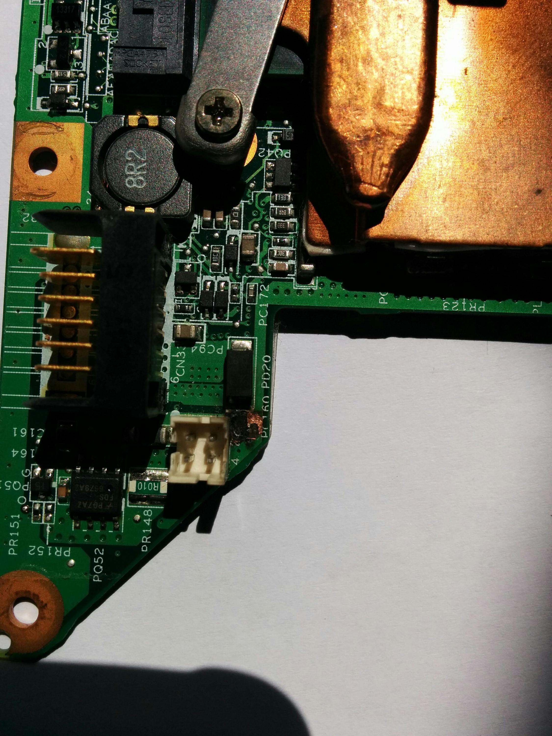

                  My board looks this after the cap blew. might not be the VIN line
                  • ktmmotocross
                    Boardkiller
                    • Feb 2014
                    • 3627
                    • slovakia
                    Re: DV6000 Intel
                    yep. it is vin shorted to ground

                      Re: DV6000 Intel
                      I'll try and solder a new cap but running out of space unless I remove the complete plastic plug. The board with jack might also have a problem since the blue led is not coming on.
                      • rookieme
                        • Oct 2014
                        • 399
                        • Greece
                        Re: DV6000 Intel
                        Do remove the power board [dc jack] from the main board and try it again with the power adapter to check is blue led lights up.
                        Maybe your mainboard is still shorted and also shorts the dc in.
                        The PC146 is not very nessesary to be placed again by you sure need to clean the burn and check that not longer shorts there.
