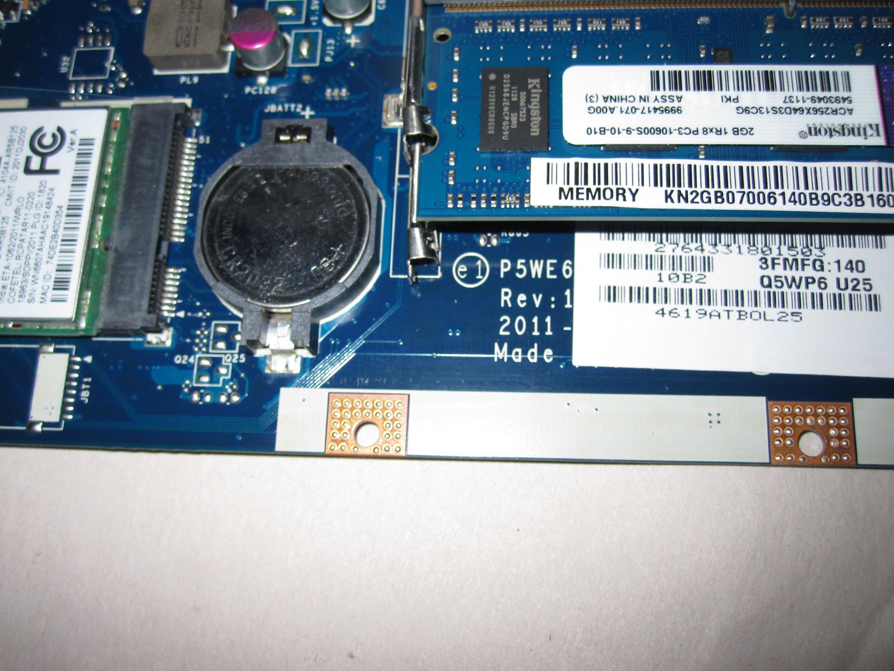

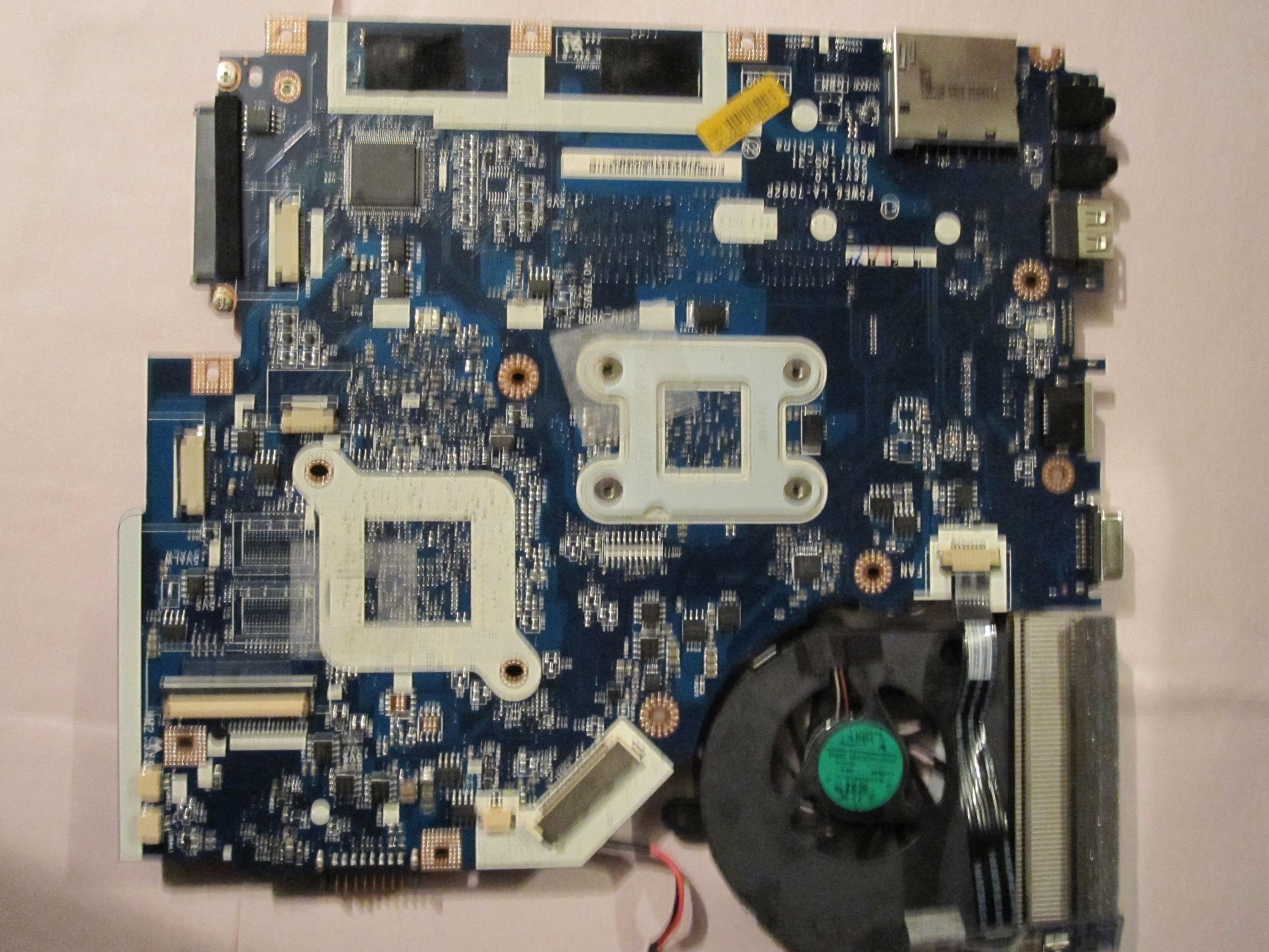

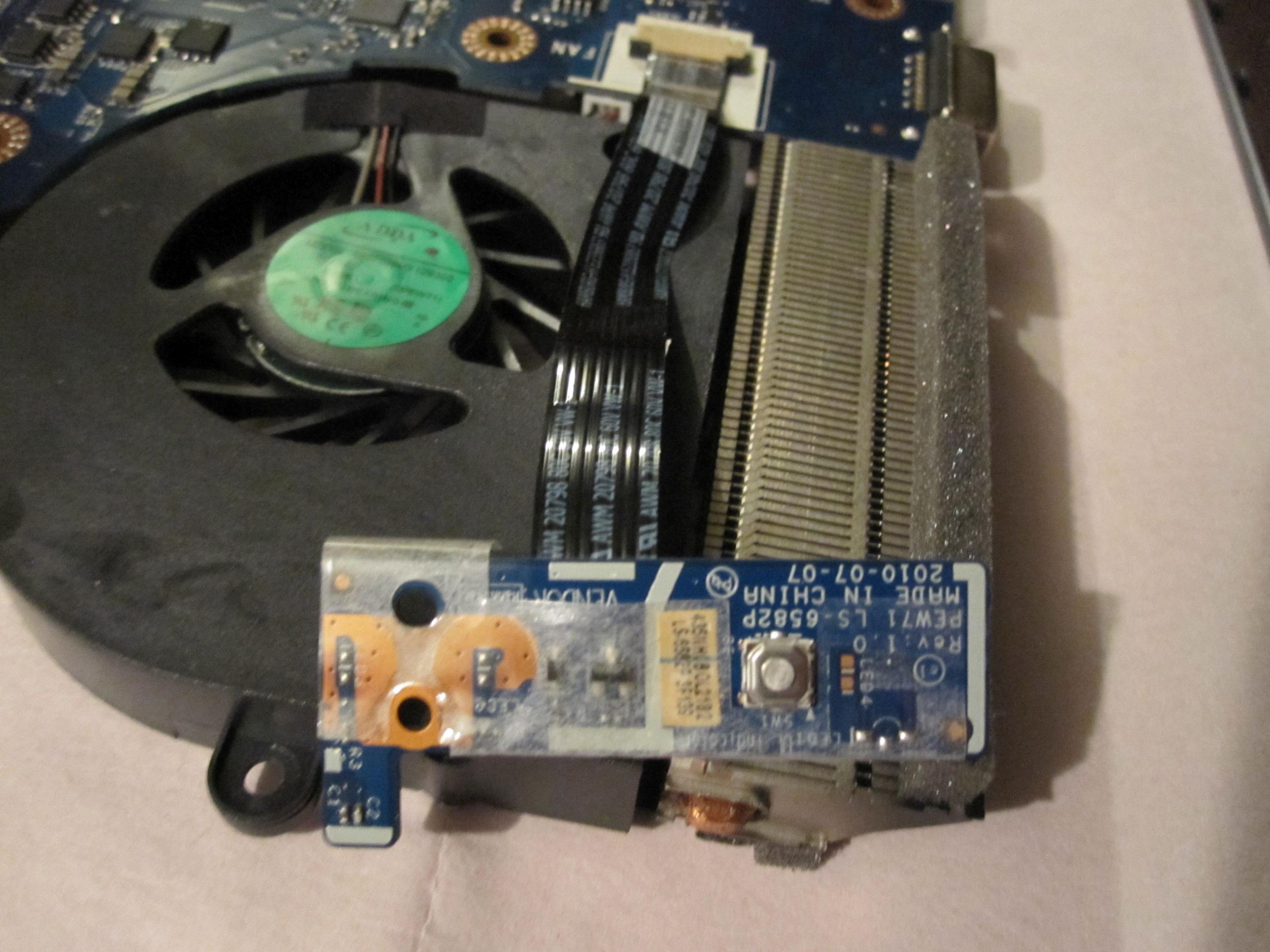

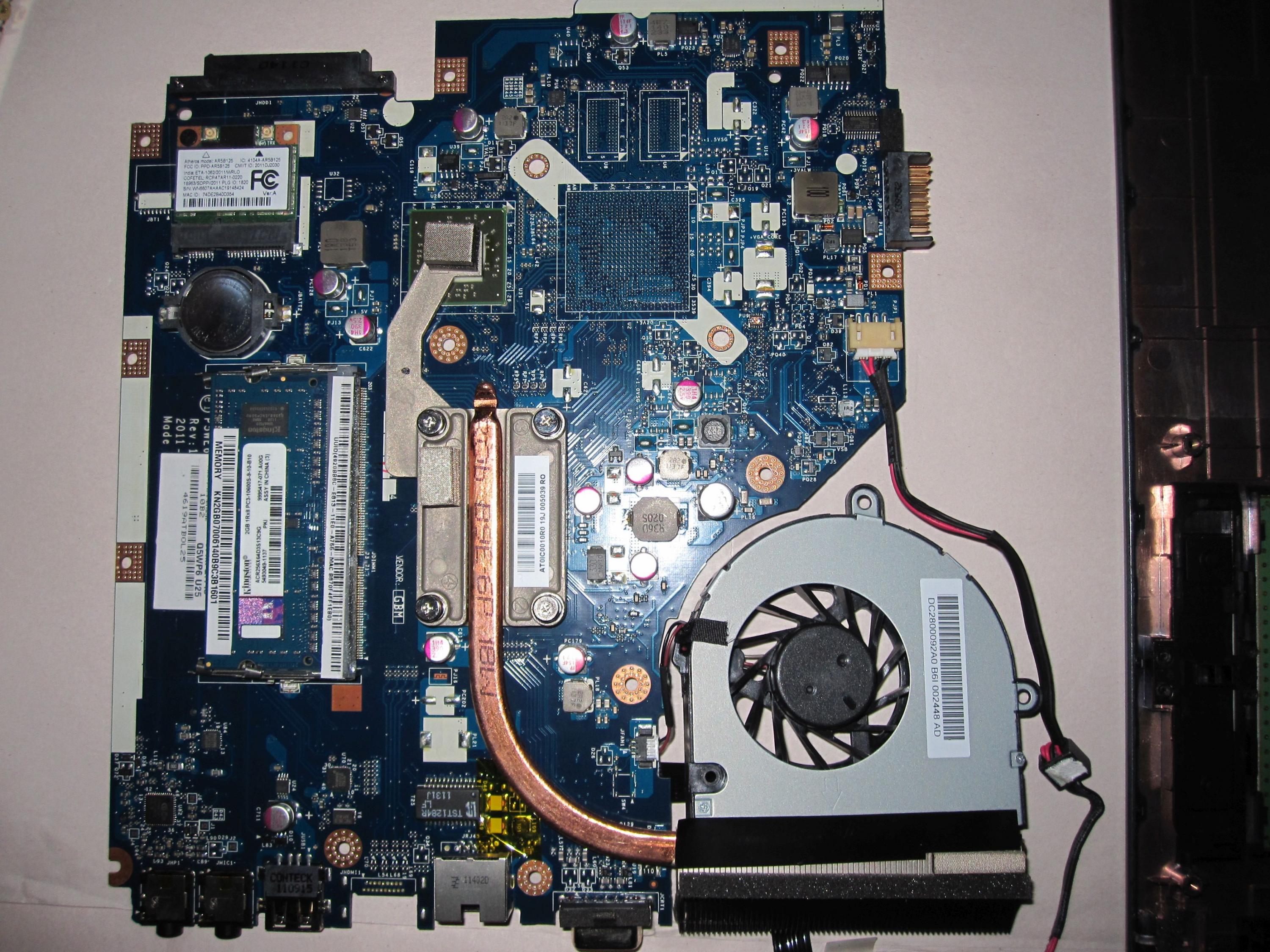

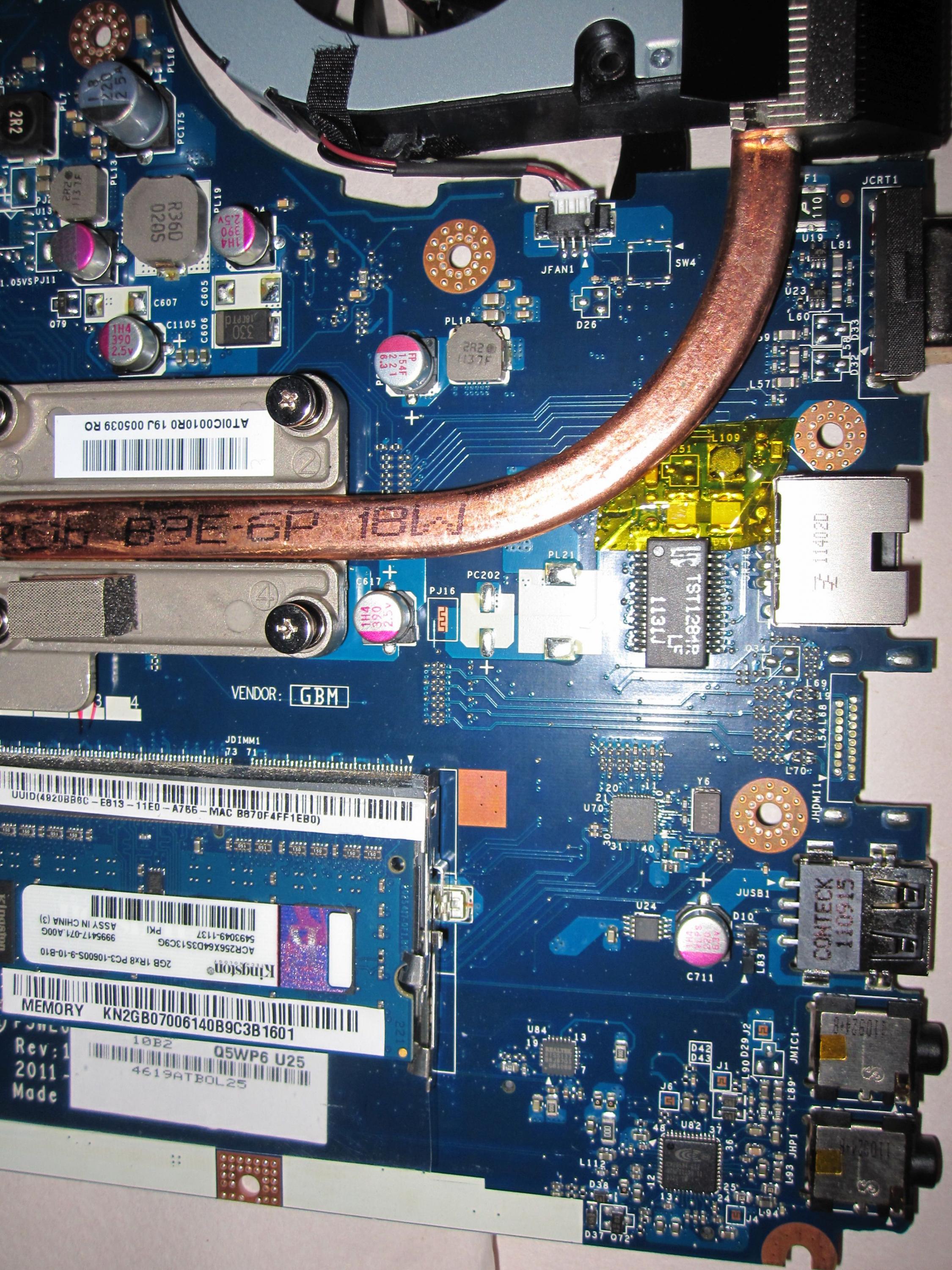

    Picked up this laptop with a cracked screen, no adapter,battery or hd. Used an adapter I had, wouldn't post. Took it apart, connected power, fan spins and Led1 on motherboard lights then powers off.
    Here are some voltages
    PJP1 19.36vdc
    PJ1 3.323vdc
    PJ2 0.000vdc
    PJ5 19.36vdc
    PJ11 0.000vdc
    PJ4 1.102vdc
    P13 5.06vdc
    PJ 6 or 8? 0.000vdc
    PJ14 5.06vdc
    Took some readings after pressing the power button also.
    Any help is appreciated.

        Some voltages only show if AC is plugged in per the manual, likely a short somewhere. Here is the schematics.
            PL1 19.36v 19.36v
            PL2 4.65v 4.65v
            PL3 19.36v 19.36v
            PL4 3.334v 3.324v
            PL5 5.06v 5.06v
            PL6 4.65v 4.65v
            PL7 0.000v 0.000v
            PL10 19.36v 19.36v
            PL11 1.102v 1.102v
            PL13 0.000v 0.000v
            PL16 19.36v 19.36v
            PL17 19.36v 19.36v
            PL19 0.000v 0.000v
            The ones with 0v showed voltage when the power button was pressed.

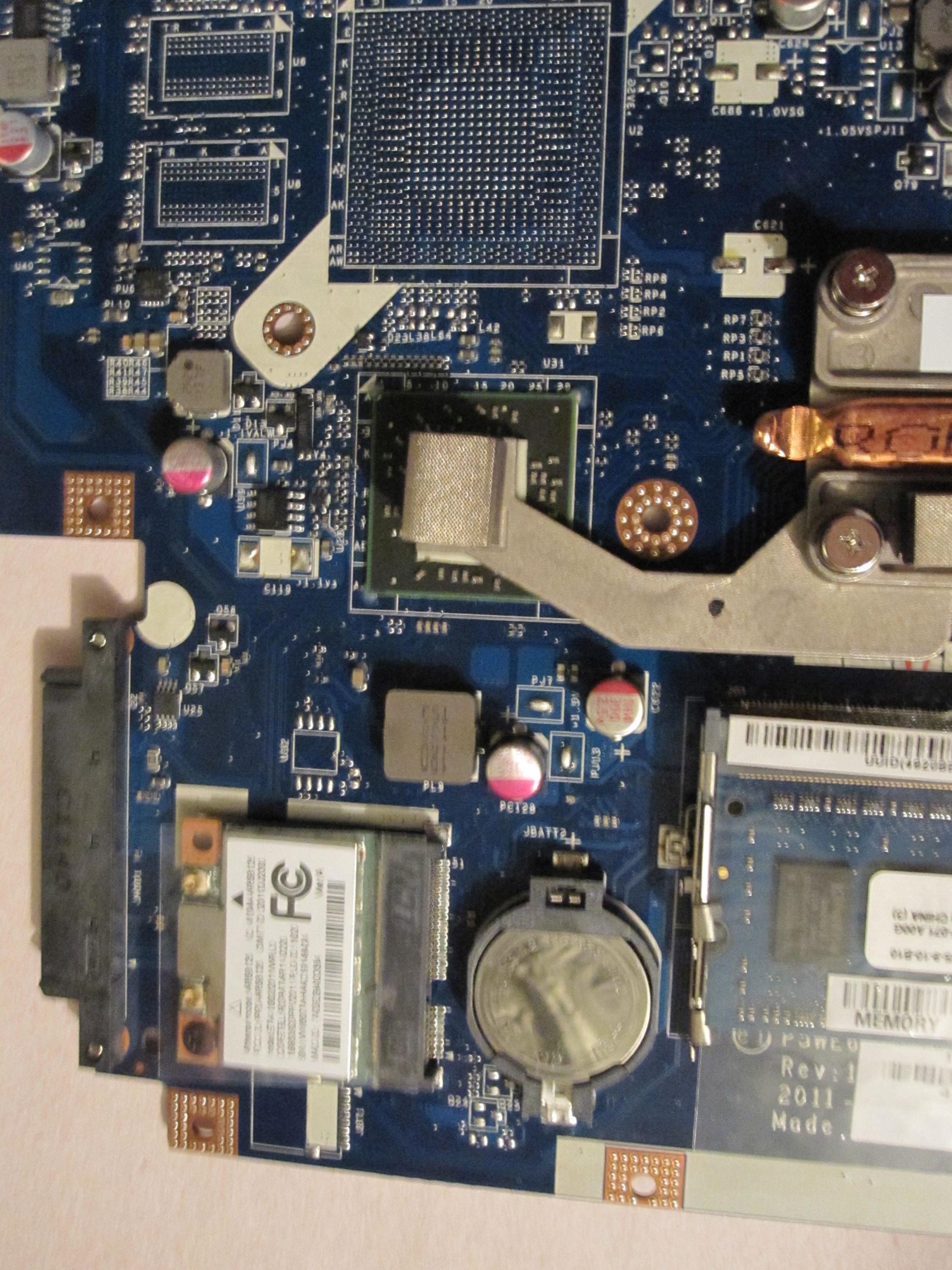

            Didn't get all of them yet. Also took the pipe with heat sink off, looks like someone had it off before. Had white compound and a tiny bit of old hard grey compound left on it. Reapplied new stuff on both chips......... no difference.

              Originally posted by maddog310
              Yes fan spins as I had mentioned in my first post.
              Are you talking about the cpu?
              Not sure how to flash a bios if it won't post, I've only flashed a bios once and that was on a working computer.
              PL1 19.36v 19.36v
              PL2 4.65v 4.65v
              PL3 19.36v 19.36v
              PL4 3.334v 3.324v
              PL5 5.06v 5.06v
              PL6 4.65v 4.65v

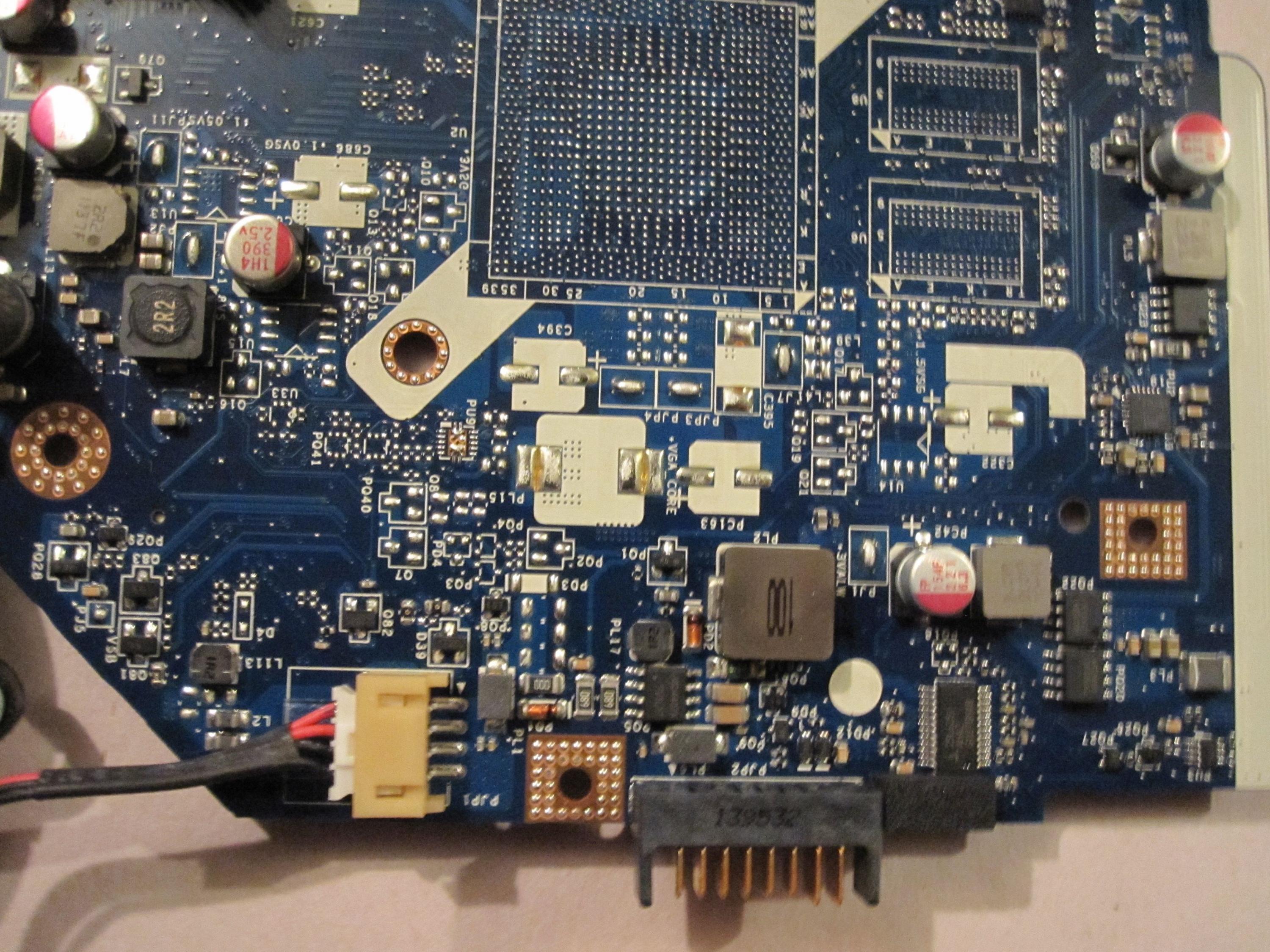

              PL7 0.000v 0.000v +1.8VSP Check this if have +5 always on if have?
              PL10 19.36v 19.36v
              PL11 1.102v 1.102v
              PL13 0.000v 0.000v+1.05VSP? check PQ34 & PQ 35
              PL16 19.36v 19.36v
              PL17 19.36v 19.36v
              PL19 0.000v 0.000v +APU_CORE Supply for this? Check PQ44 and PQ45
              Hope are Solve this...
              post the result

                These are the voltages i get when pushing the power button.
                PL7 1.8v
                PL13 1.059v
                PL19 .990v
                So I am assuming these are to have voltage with just power connected.
                Can I check the voltages on those mosfets to see if their alright, and how would I go about it.
                • maddog310
                  • Apr 2010
                  • 51
                  Re: Acer 5250 0816 Powers Off
                  Checked PQ34, here are my results
                  +S1 -D8 = .478v
                  +S2 -D7 = .477v
                  +S3 -D6 = .477v
                  +S3 -D5 = .476v
                  -S1 +D8 = 0L
                  -S2 +D7 = 0L
                  -S3 +D6 = 0L
                  -S3 +D5 = 0L
                  -S1 +G = .896V
                  -S2 +G = .893V
                  -S3 +G = .893V
                  From what I've read it looks good, am i heading in the right direction!

                    Checked PQ34 in ohms beep mode
                    -S +D = OL no beep all pins
                    -S +G = OL no beep all pins
                    PQ35
                    +S1 -D8 = .090v
                    +S2 -D7 = .090v
                    +S3 -D6 = .090v
                    +S3 -D5 = .090v
                    -S1 +D8 = .066v
                    -S2 +D7 = .066v
                    -S3 +D6 = .066v
                    -S3 +D5 = .066v
                    -S1 +G = OL
                    -S2 +G = OL
                    -S3 +G = OL
                    ohms beep mode
                    -S +D all around 129 ohms and beeps, all pins
                    -S +G = OL all pins, no beep
                    PQ35 looks bad............. any thoughts.
