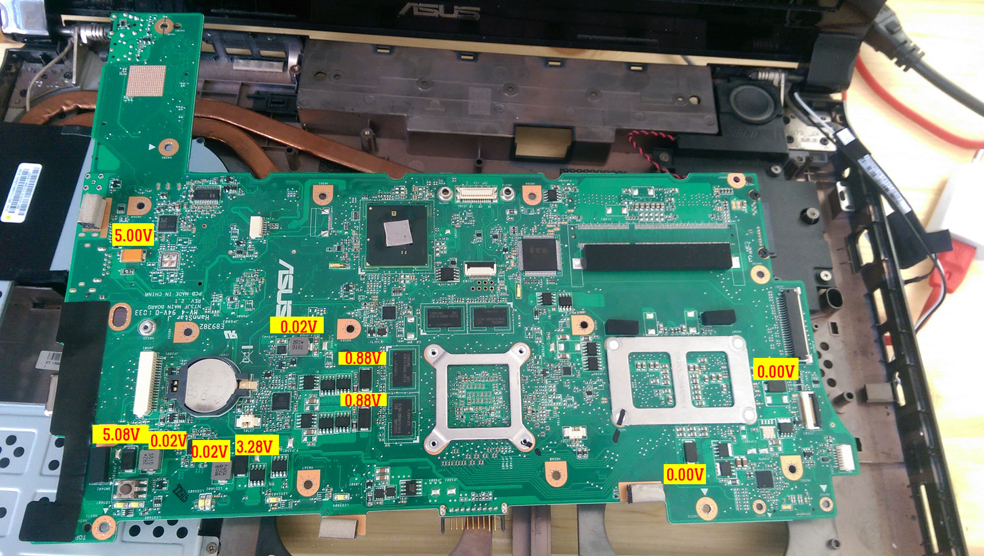

    I am new around here and this is my first post. And this is going to be very noob one
    My laptop has died recently, actually it was "half" working but i think i messed up while attempting to troubleshoot.
    It's Asus N73JF. I don't know what went wrong but it's all happened while swapping a new HDD into laptop.
    It has started to act strange, like stucking at BIOS logo and i was unable to access BIOS at all.
    So i have disassembled to make sure there's nothing wrong with external hardware or daughterboards. I have removed anything and tried to boot (even without screen).
    But there was no change at all.
    Anyway, i have tested some components with multimeter and found out that there is a short circuit on motherboard.
    My multimeter was set to "continuity" mode. I've realized that, caps are that near to the CPU were in short circuit.
    After doing more research, i tought that freeze spray might help to detect any failing components.
    I have applied freeze spray to components and tried to power on with adapter (it's 19V 4.5A) and then everything messed up.
    There is no visual damage, no smell or something.
    Now when i power on the motherboard, CPU fan tries to "wake up" but it's not spinning at all. Power LED turns on for 1 sec and its turning off.
    Appearently, i did awful job with freeze spray and i believe i have caused more damage.
    Folks, please keep in mind that my goal is the fixing it by myself and gaining experience. It's not a a matter of life and death for me. I am just trying to figure out what went wrong and what is the right approach to troubleshoot such case. Plus, i am always looking ways to improve myself and gain some experience.
    Right now, i can read 3.3v, 5v and 19V on motherboard. So seems like there are still alive components CPU gets very hot, i don't know if such high temperature is normal without a proper boot and OS load.
    I have a basic multimeter, soldering equipment and half bottle of freeze spray.
    Is it worth to keep working on it? Or should i send this mobo to trash?
    Thanks in advance.

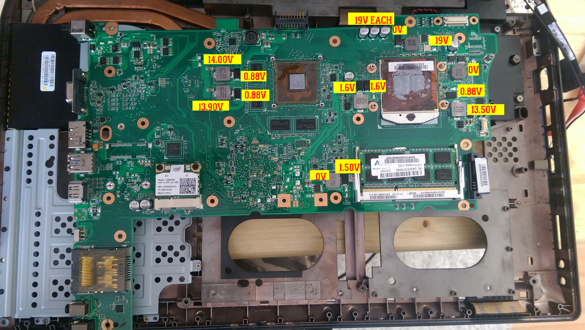

        • martyr
          • Mar 2017
          • 10
          • Turkey
          Re: Laptop not powering on after freeze spray
          Please check attached pics of mobo and my voltage readings.
          Thanks alot for your help.
          • cyberhack
            • Feb 2013
            • 466
            • Uk
            Your ram is not fitted? looks half out
            • martyr
              • Mar 2017
              • 10
              • Turkey
              Hello cyberhack,
              Yes it was not fitted. Now it fitted and test with other slot but no luck.
              • jasko_jacker
                • Oct 2014
                • 1137
                • italy
                The cold spray can damage a single component only if it is very hot when you use it.
                The presence of 3v e 5v and the shutdown when you push power button indicate the presence of a short only when the machine is in s0 state.
                To localize the culprit you must remove some jumpers (if there are on this motherboard). i haven't the boardview but if you post it, I indicate to you the correct procedure.

                  • jasko_jacker
                    • Oct 2014
                    • 1137
                    • italy
                    Originally posted by martyr
                    Hello jasko_jacker,
                    Thanks for the tip.
                    Unfortunately, i don't have boardview or schematics of the board. And it's not available on net.
                    Any ideas?
                    I have posted pics of the mobo on my previous message. Hope that helps.
                    unfortunately for free only at this link:
                    http://**************/load/noutbuki/.../313-1-0-47001
                    But the procedure to make an account it's very difficult.
                    For sale at this link:
                    https://***********/resources/boardv...00-model.1205/
                    And I think for sale too:
                    http://thienbui.com/threads/n73jf-r2-0-boardview.10172/
                    I'm sorry but without boardview is not possible to know some details of motherboard

                      • martyr
                        • Mar 2017
                        • 10
                        • Turkey
                        jasko_jacker, i got boardview ("N73JF 2.1.fz"), seems like its legit.
                        Now, how i should proceed?
                        Do you want me to upload this file to somewhere?
                        Thanks.

                              • martyr
                                • Mar 2017
                                • 10
                                • Turkey
                                Added 2 files.
                                - Boardview file (.fz)
                                - Repair Guide
                                Thank you so much for your help.
                                • jasko_jacker
                                  • Oct 2014
                                  • 1137
                                  • italy
                                  Sorry for delay,
                                  I'm reading your post, I did not understand the situation: only using the power adaptor, without pressing the power button, and with the bios battery inserted , some component warms ?
                                  You say that the cpu is very hot, in which situation if the system don't power on ?
