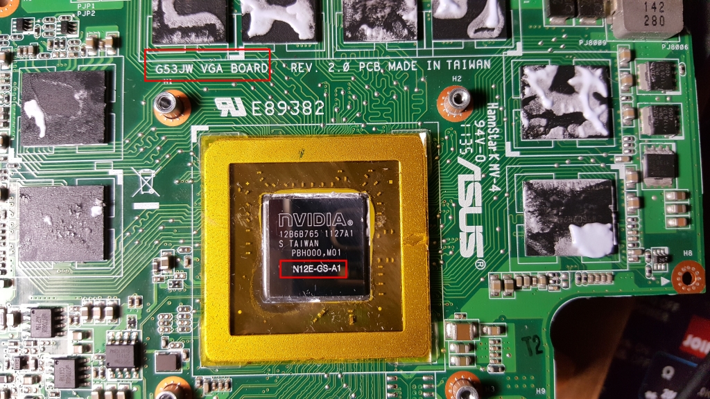

    There was another problem with new video card:

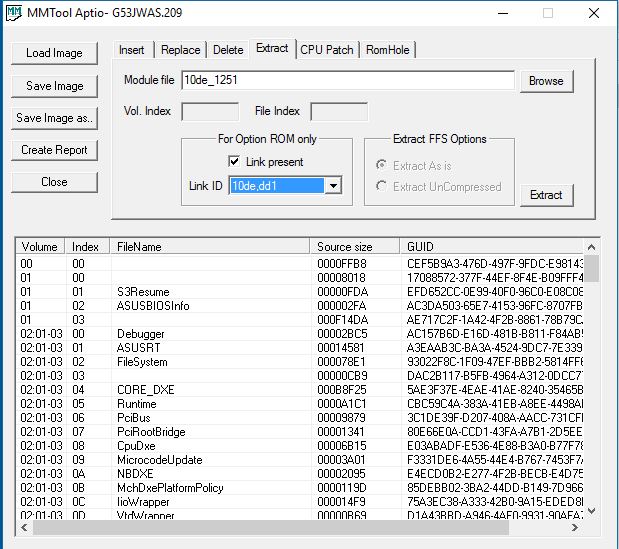

    I purchased this as a GTX560 video card (http://www.ebay.it/itm/ASUS-G53JW-G5...00-A03-TESTED- GOOD- / 301894802875), now as you see in the picture the card is for G53JW model, downloading and extracting the VBIOS from asus website I found that this driver is for 10de, dd1 which corresponds to a GTX460M.
    The chip welded on this card is N12E.GS.A1 which corresponds to a GTX560M.
    So it seems that they did an upgrade and I have serious doubts that are truly 3G vram because I read that GTX460M support max 1.5G vram.
    This card has 12 chip hynix h5g02h24mfr (4 Banks x 2M x 16bits Synchronous DRAM)
    I thinking it was a real GTX560, I used the driver for a vbios
    asus g73sx
    At this point what video driver I have to try?

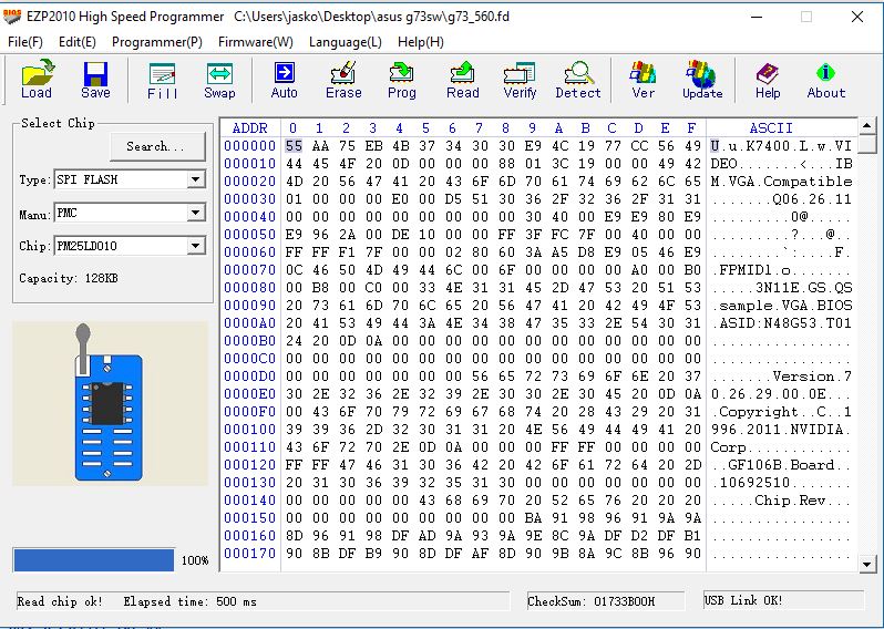

      There is a pm25ld010 with a vbios instead on new GTX560m and on old GTX460M, but there is a vbios also in motherboard bios, which vbios is used by the system ?
