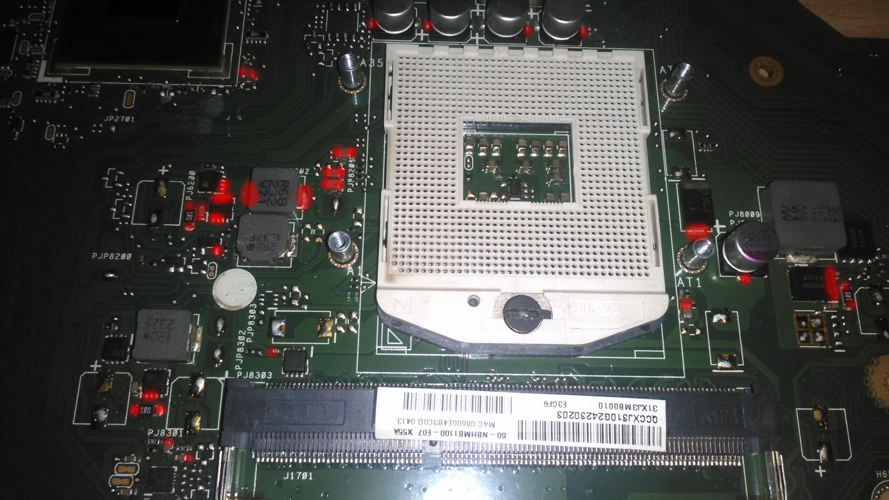

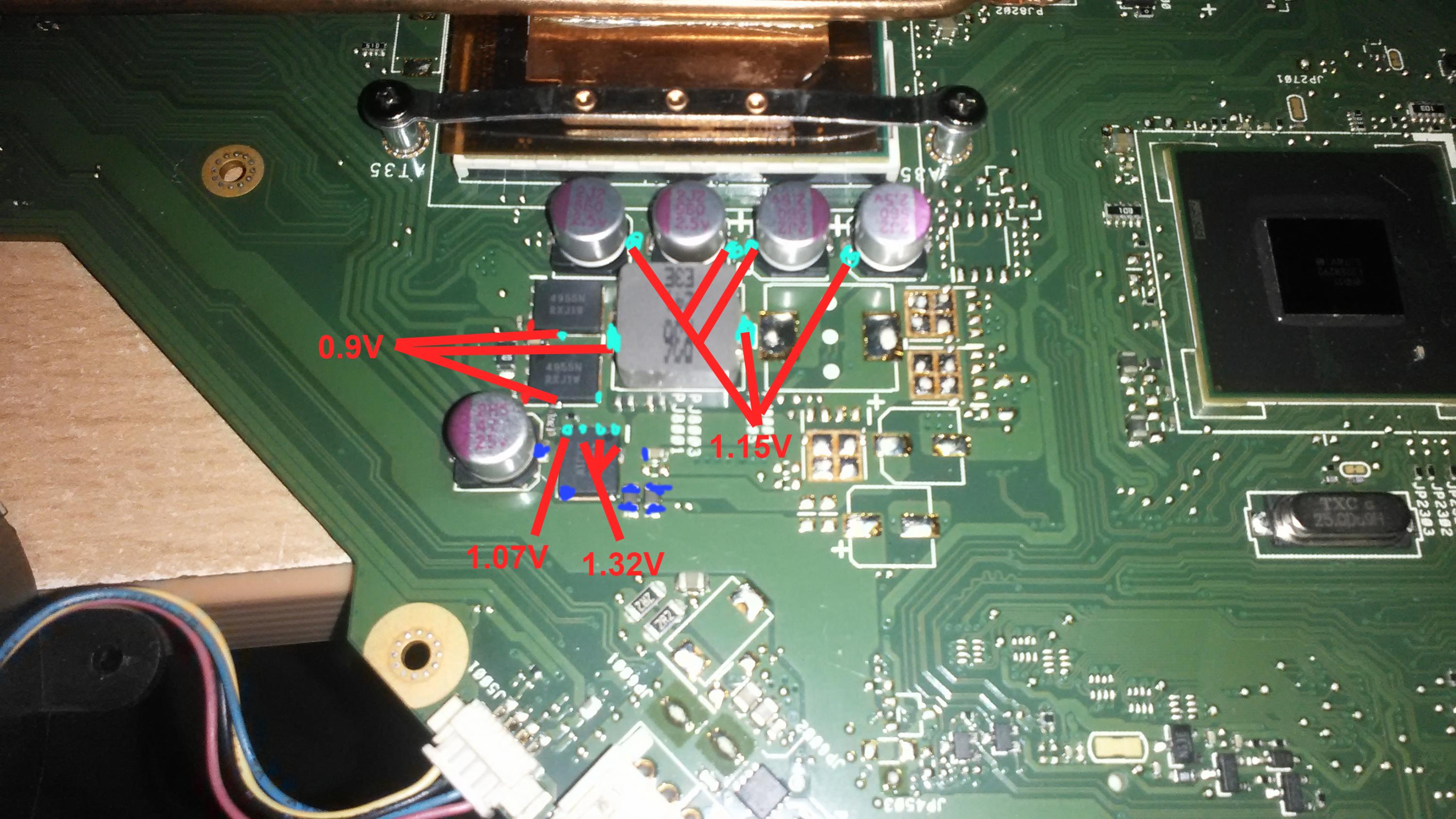

      Readings do vary about +-0.10V every time I measure on the bottom transistor. All other values are fixed.
      • heavymachines
        • Mar 2011
        • 1028
        Re: Asus x55a problem
        You would need need one of these..eBay item number:182492676824
        to be able to flash it not being able to boot laptop. Or buy a preprogrammed bios and soldier it in or make your own interface to ic and rom software to flash it...
        Readings are fixed, in diode or ohms? Actual readings please .001 on source of fet? 111? , without designators and pin numbers with actual readings makes things very confusing and can give wrong data.
        • Morsus
          • Nov 2016
          • 96
          • Serbia
          Okay, this is where I am now. Since I don't own a device for bios programming or programmable bios chip I discarded that idea. (Couldn't find the item by that number either, but I did google a lot).
          I took all 3 transistors off for testing and the each show 750 on diode mode between drain and source. Sooo the transistors should be good, right?
          I didn't try to take caps off since they have a plastic bottom and I didn't want to make a bigger mess than it already is. (you can see that the pink/red color did come off from caps top)
          So, can I test anything else now while I have these off?

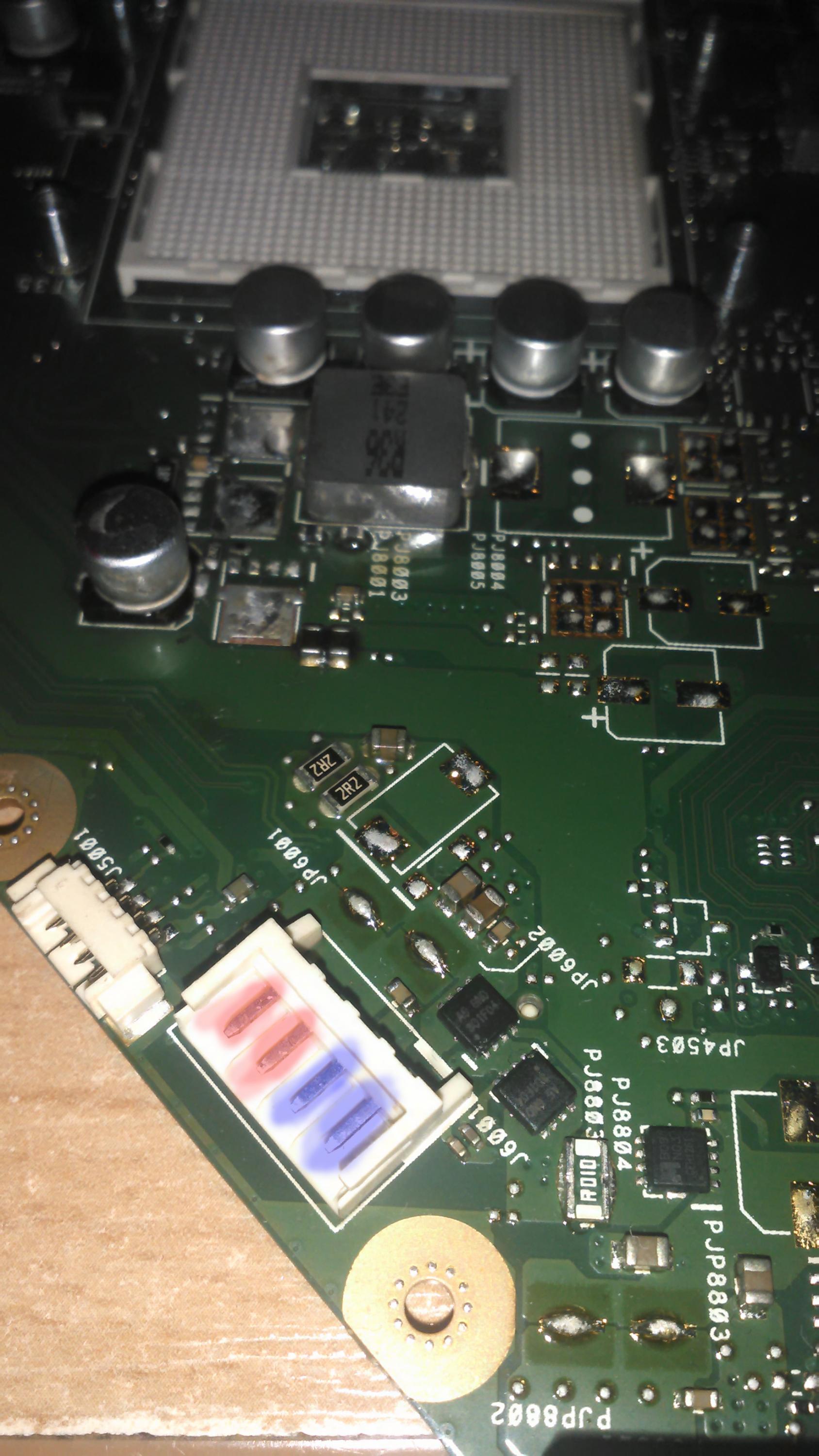

              Update:
              Without processor and these 3 transistors the pins on bottom connector are shortened. First two are shortened and second two between themselves.
              Also I made another image of all contacts shortened to the ground.

                If you're certain it is shorted within itself replace. that cap with missing paint should be replaced got way too hot. Not enough flux used or none at all and add fresh soldier and flux to get it too come off with iron at less time therefor with less heating time. Chipquick works good for removal of smd devices. Use regular flux for putting back in. You check for shorts on mosfet between gate and drain. https://www.youtube.com/watch?v=fOGAhaVH06I
                Again http://mayohardware.blogspot.com/201...g-mosfets.html.
                  No I think it's perfectly fine, nothing shorted here.
                  (the only thing would be the 3 MLCC caps between the two coils and the CPU socket on the left, but it's probably fine)
                  You get good VCore so this section is perfectly fine in my opinion.
                  Does the OS boot anyway? (ie. you can hear the hard drive heads moving)

                          I also took the first cap in row below CPU witch showed up to be a little bad (about 450uF instead of 560uF) but I don't think that it is the culprit. I am looking for a replacement cap atm.
                          It may be the issue, but I'm not sure which cap you're talking about?

                                No backlight no anything 100% dead, same on external screen.
                                I cant measure anything until I replace the missing cap.
                                I am not cooking the board.
                                Also I can't reprogram the bios since I don't have the right equipment (I am in process of getting it tho).
                                Okay, back to the cap. I have nowhere to buy same one at my place all I got are these:
                                Original cap - 560uF / 2.5V (2J2)
                                Spare ones I got?
                                651uF/6.3V (FP5K/FP) or 820uF/2.5V (E110/ULR).
