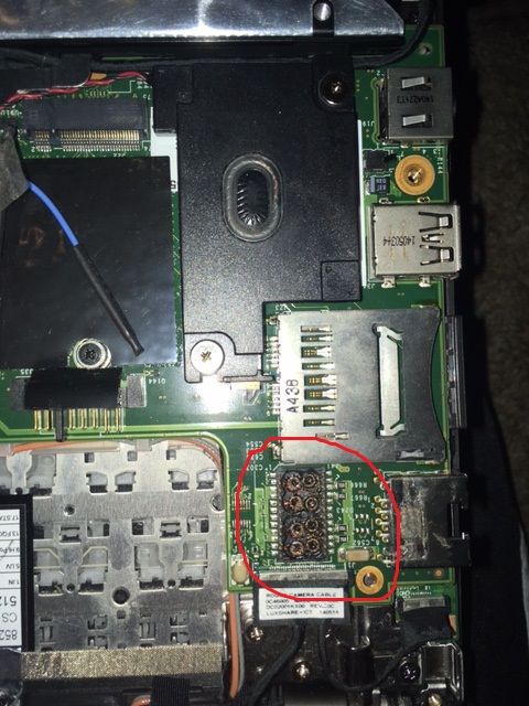

Lenovo X240 Problem Please help :)
  • sstamenov91
    • Mar 2016
    • 47
    • Bulgaria
    Can same one tell me what chip is suppose to be

    Re: Lenovo X240 Problem Please help
    this is just bunch of small inductors or common mode chokes used as filter on lan data lines... This also provides some sort of RF protection for lan port...

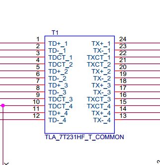

      It looks very similar/identical to that on a Dell I have. It's marked NS692417 on top.
      I've just located the schematic. It's a TLA 7T231HF-T
      Pulse transformer.
