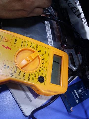

    I need a advice to my Repair. Acer Extensa 2509-C6l8
    Mobo: Z5WAL LA-B211P (Rev: 1.0) 2014-03-26
    Symtoms: if i turn on Processor Fan not Spinning After 5 sec Turn off.
    Other : error first Shorted the USB Connector. i'll already remove the USB port

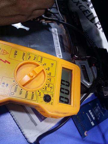

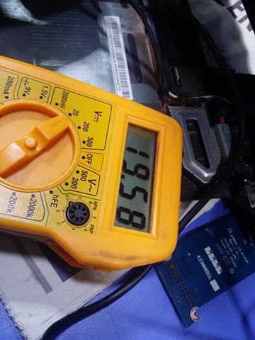

    1. i check the voltage.
    check the PQ302 (MOSFET MDU1512) Nchannel marked red box. test actual
    On plugin addpter( system turn off)
    Using Digital Test
    S 123=19.59V
    G 4 = 0V ?
    D 5678= 19.59V
    On plugin addpter( system turn on)
    Using Digital Test
    S 123=19.59V
    G 4 = 0V ?
    D 5678= 19.58V
    First question Here the picture
    Source Prove Red the Black on Gnd
    then the Drain same reading on Source.
    second question if the Gate have no supply
    maybe this is happen?
    but how come (1) why?
    i need for advice and Help me to fix this. thanks

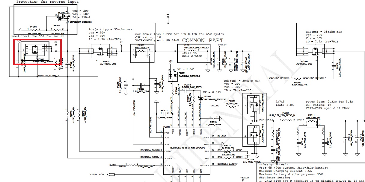

              here's the Schematic Diagram

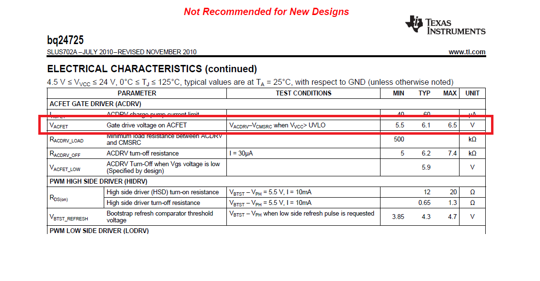

                    I think you should use scale 200V to measure volt on gate PQ302. How could be?
                    PQ302 its N-Channel mosfet. N-channel need voltage on gate with value vgs is positive (+) than source. pin 123 we need 19V. So, on gate we need higher than 19V. could be 19V+6V. (voltpin4-voltpin123= +). so on gate pq302 usually ~24-25V. And your dmm can't reading properly if you set 20V scale.

                        Re: Acer Extensa 2509-C6l8. Auto off 5 Sec.
                        Update: Not Yet Done
                        Unit Statuz: Auto Off 10 sec. CPU Fan Not Spinning
                        Power Led Indicating if press power on switch Light After 10 sec. Turning Off the light
                        hints: I already change the PQ302 same value
                        voltage value plug in the adapter
                        PQ302
                        S-123 = 19.5V
                        G-4 = 24.7
                        D-5678= 19.5V
                        PQ303
                        S-123 = 19.5V
                        G-4 = 24.7
                        D-5678= 19.5V
                        PQ301
                        PIN1 = 24.7V
                        PIN2 = 2.7
                        PIN3 = 19.5V
                        What Parts Have problem?
