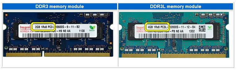

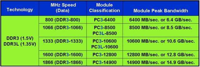

you need a DDR3L
1333/1600(low voltage:1.35V ) not normal DDR3(1.5V) ,may be this is why the motherboard continue beeping .

Ram type was wrong ?

ya, ram type wrong.....
