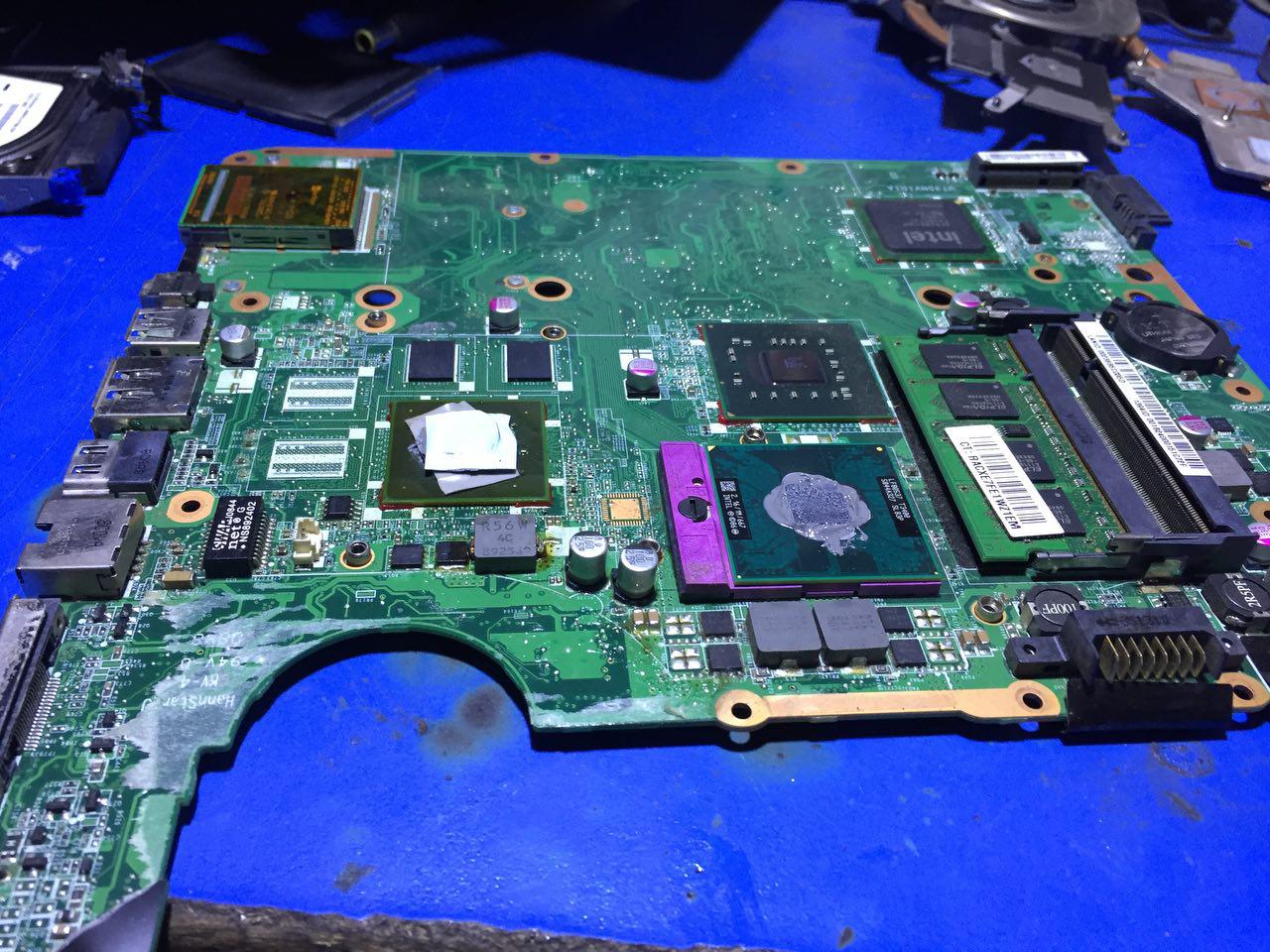

hp dv6 ut3 can i uma enable
12-28-2016, 02:41 AM
hp dv6 ut3 can i dis to uma enable

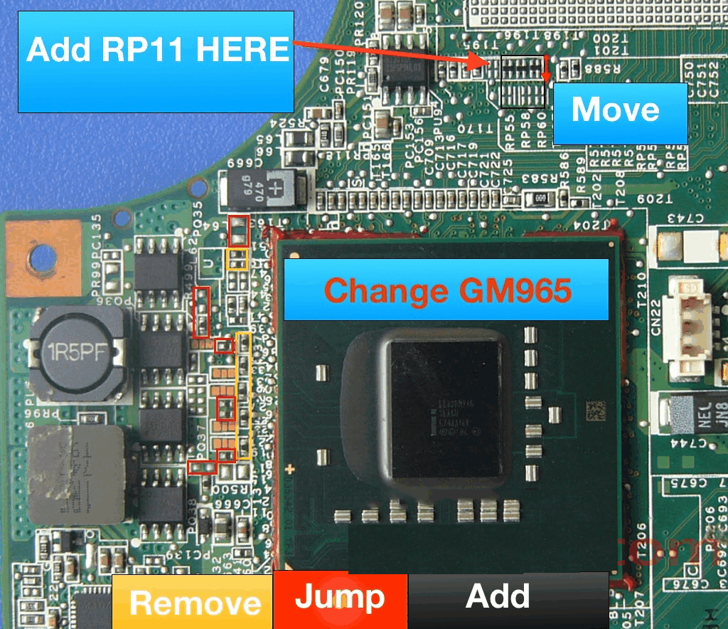

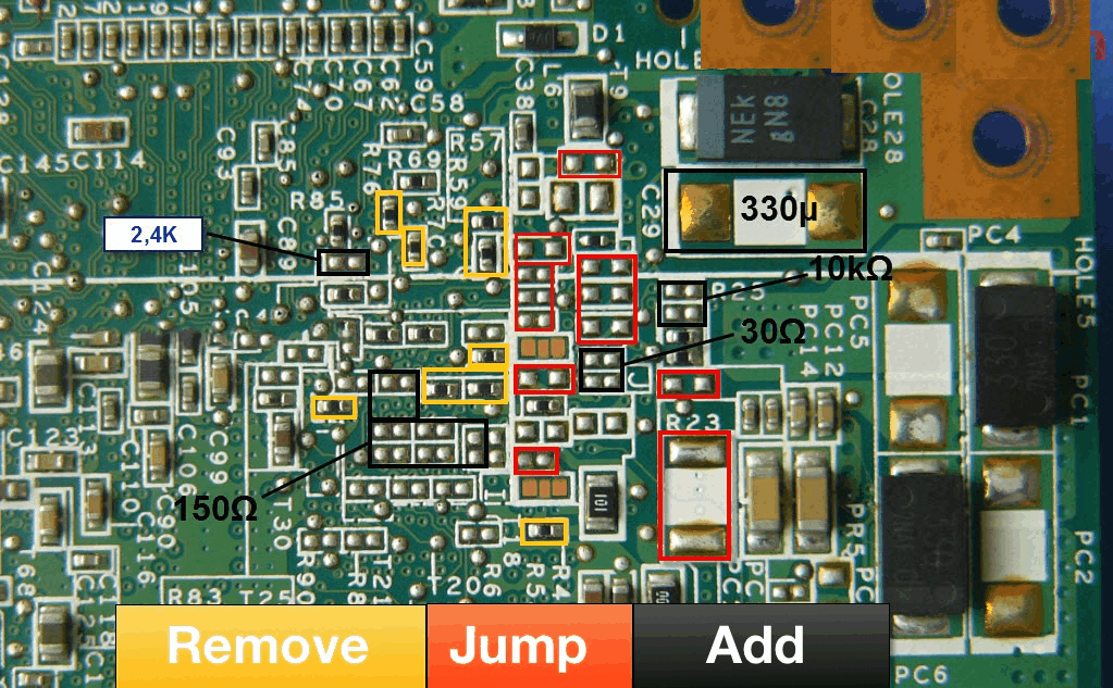

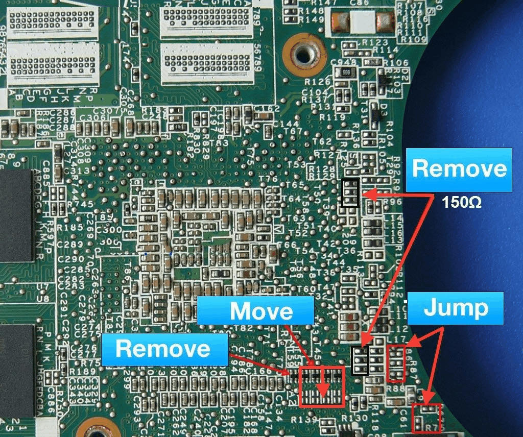

Re: hp dv6 ut3 can i uma enable
Originally posted by
mehmood muhaish
View Post
i hope this can help you
Post
Cancel
memoslar
Join Date:
Apr 2015
Posts:
121
Country:
Greece
03-14-2018, 11:39 AM
b4rdock
View Post
Thats not the motherboard you sent.
We need dv6 -1360 , ut35atiddr3
Post
Cancel
mcplslg123
Join Date:
Jun 2015
Posts:
7228
Country:
india
03-14-2018, 11:16 PM
memoslar
View Post
As far as i know, not possible.
