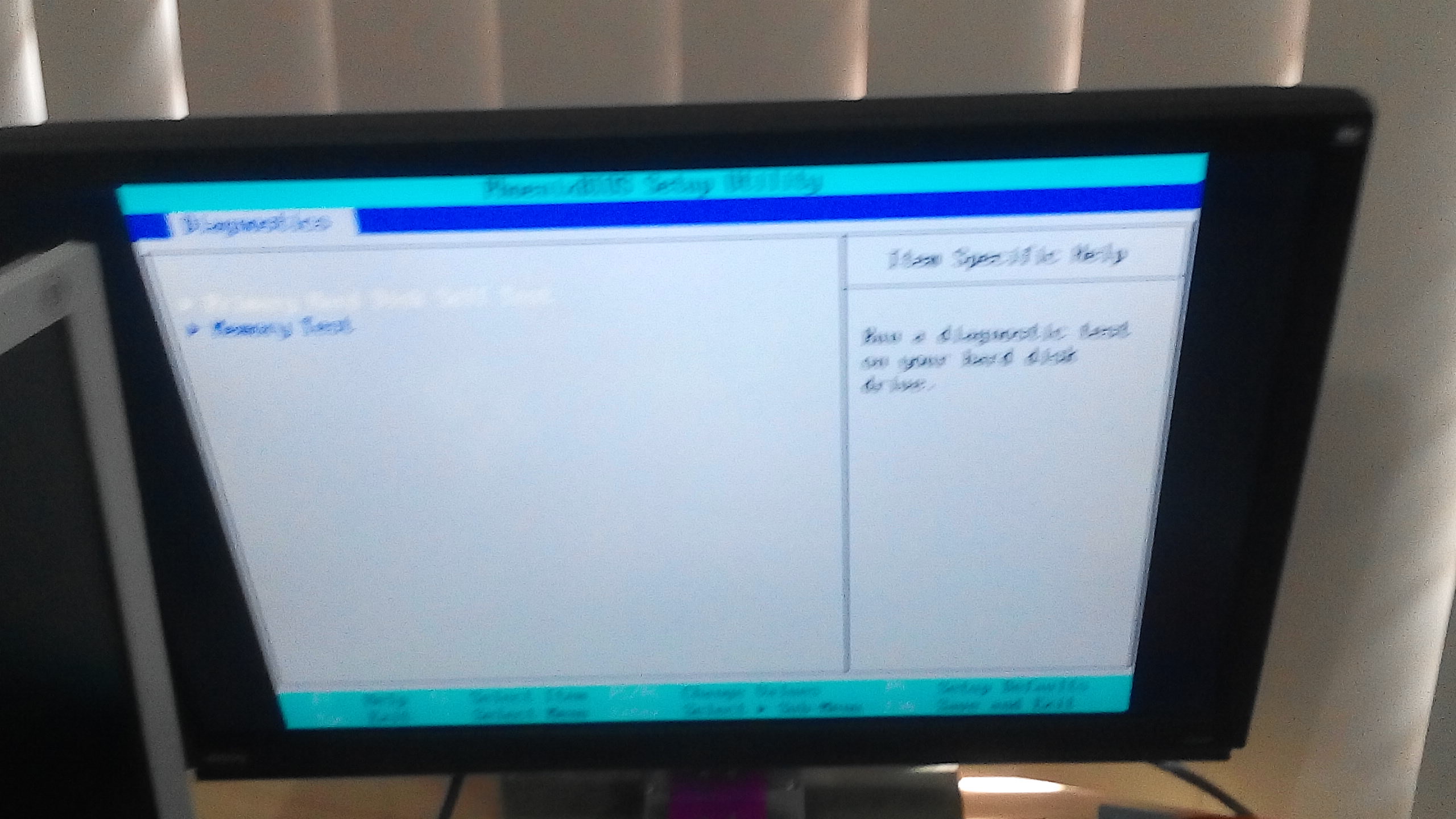

      Re: DV9500 blue LED ring of death ?
      some photos....I need to reassemble back now...

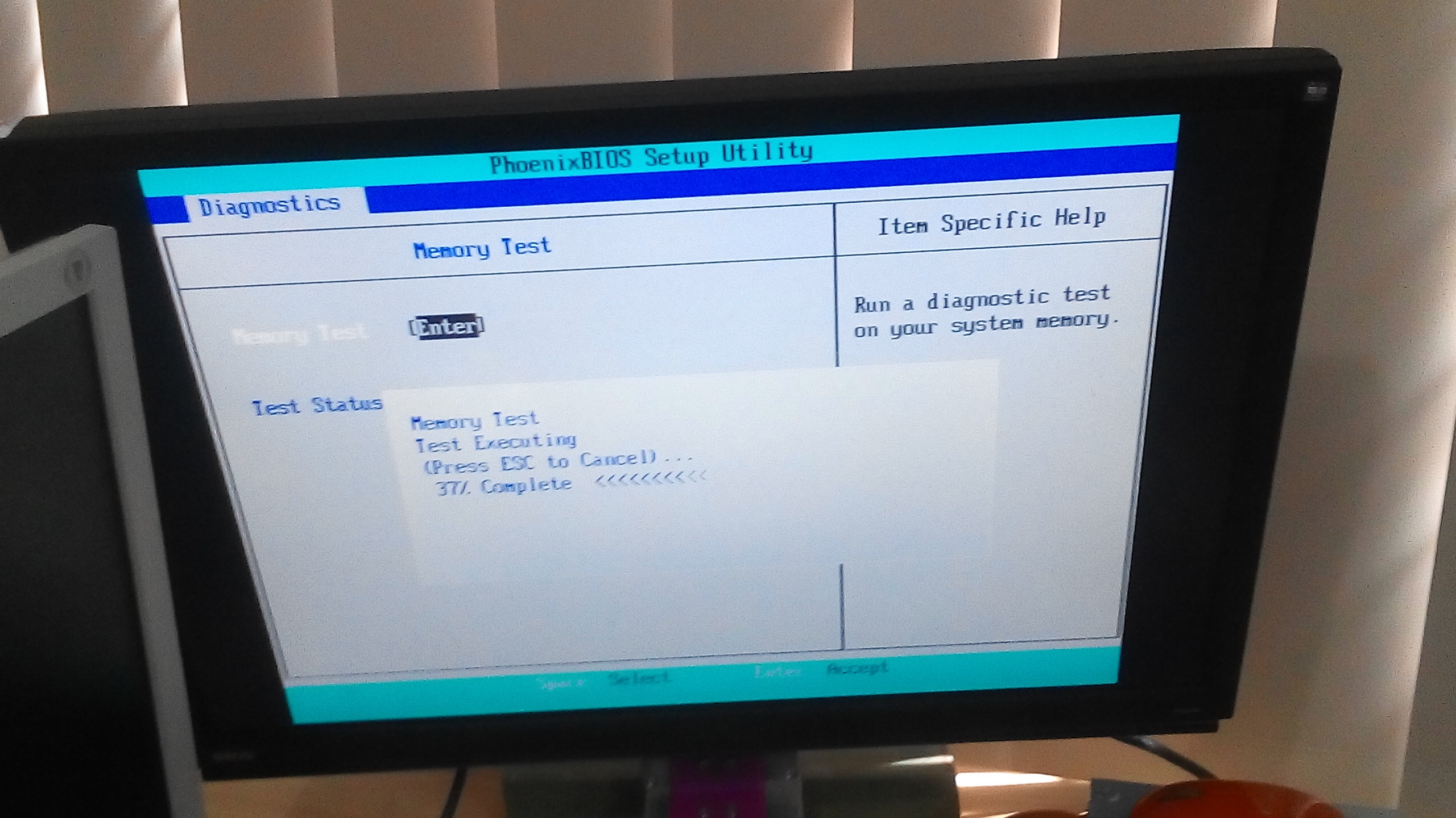

                    #149

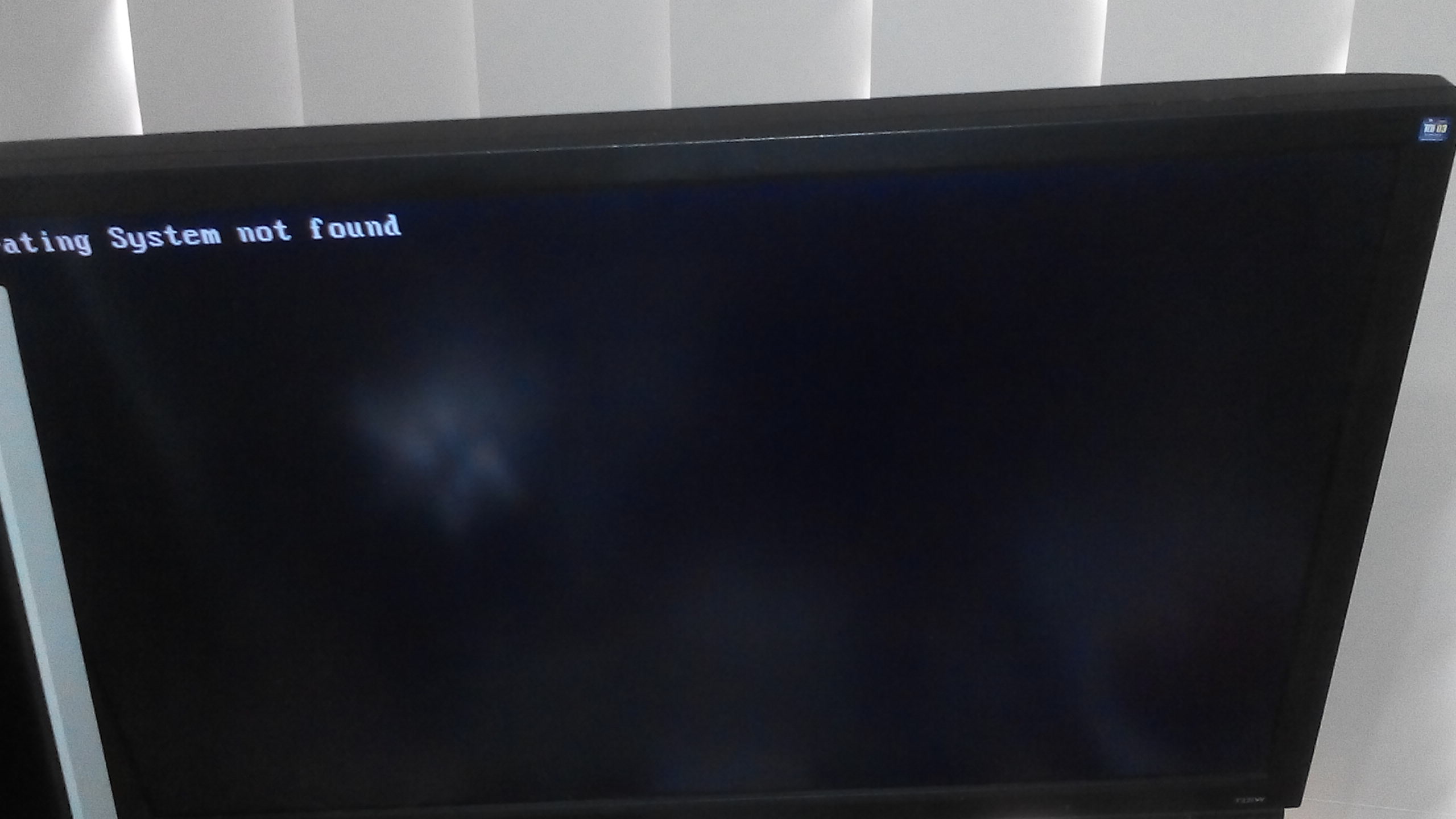

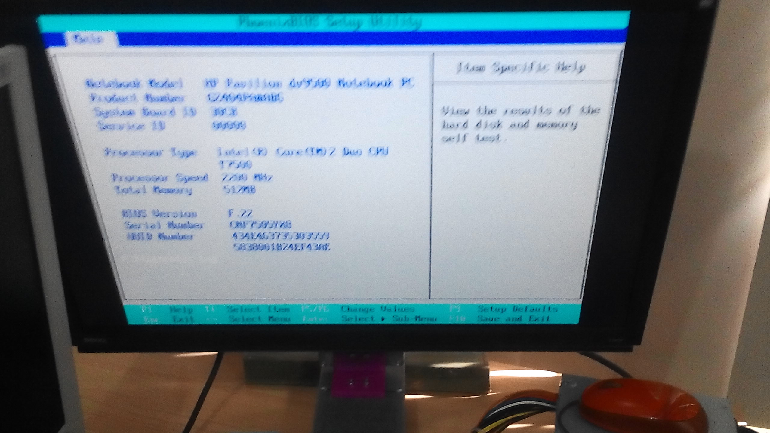

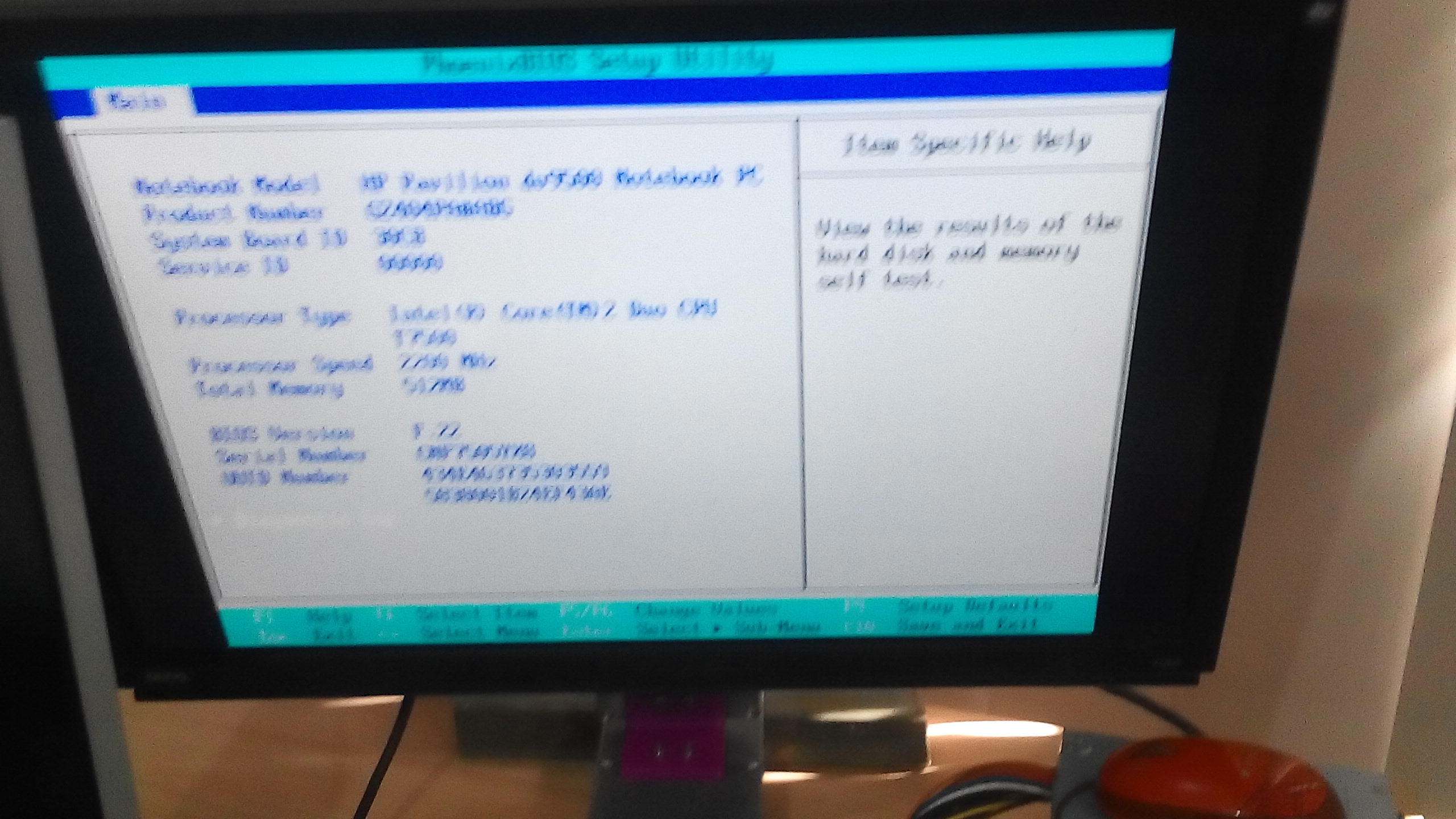

                    Ok...all good, now it's running properly, I put ubuntu on it....there's a dirt on LCD...looks like a glue mark....any suggestion for a friendly cleaner for LCD ?

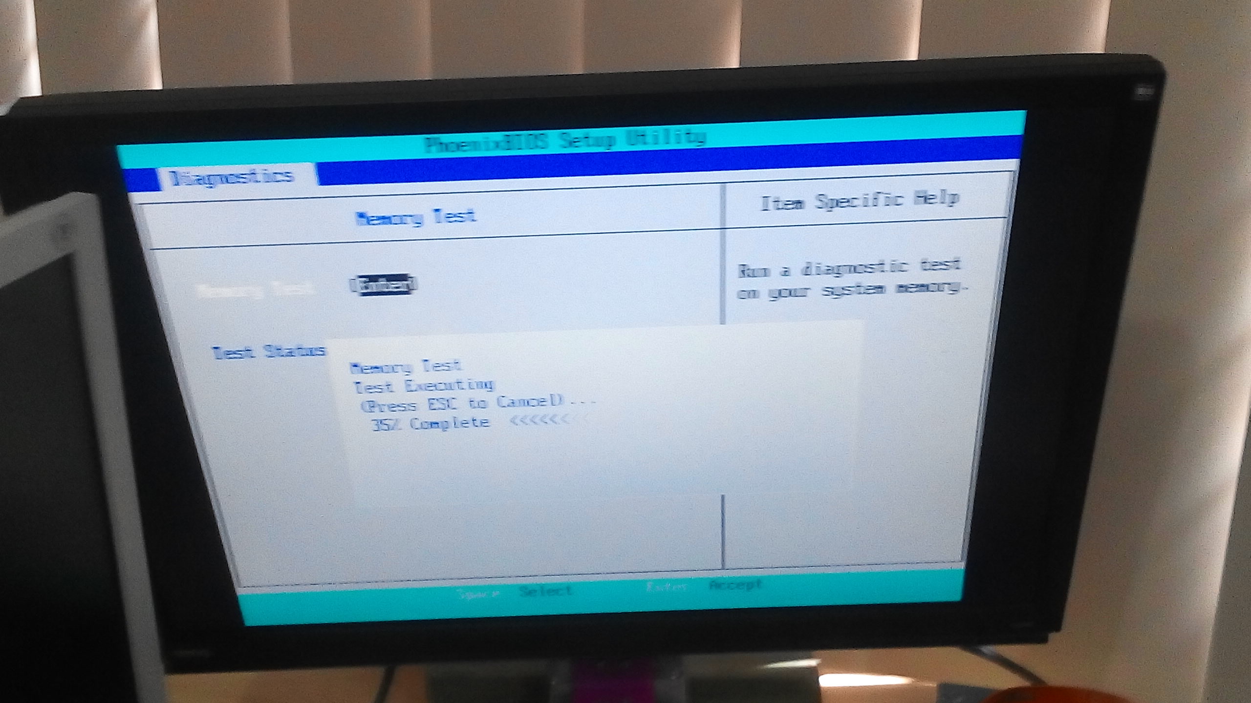

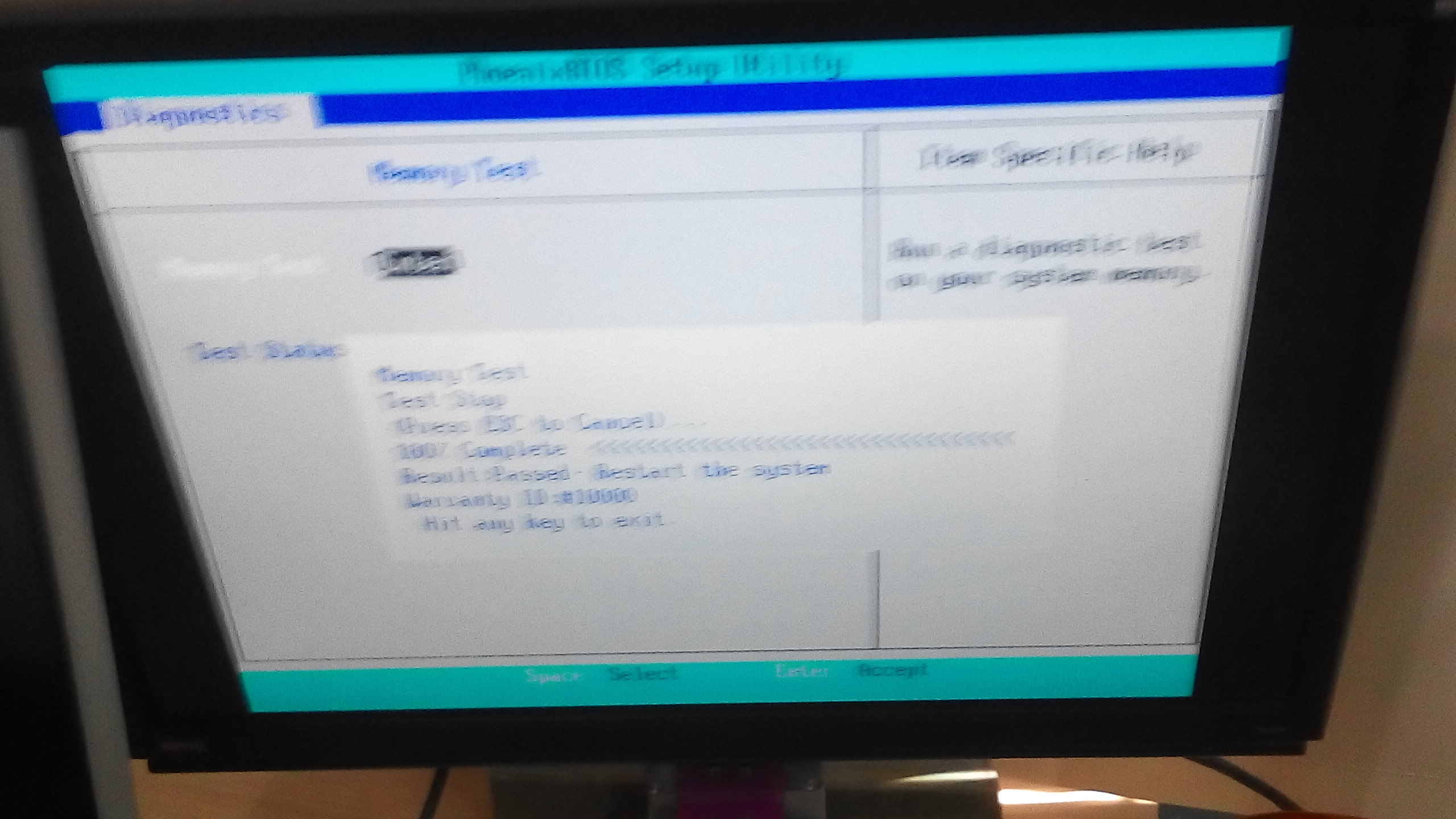

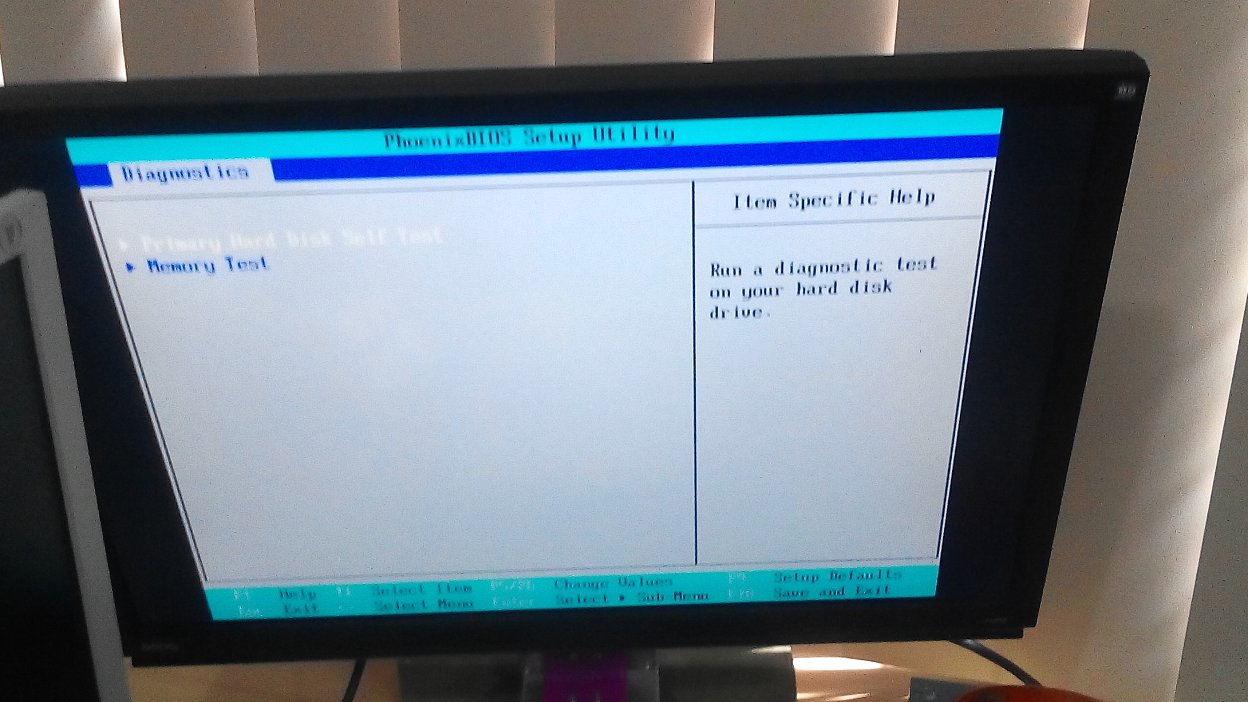

                                Have you ever got no clock issue ?
                                • bianchi77
                                  • Jun 2016
                                  • 1121
                                  #156
                                  Looks like I can't get a clock from :
                                  CLK865J02FLFT
                                  I can't see my CLK on POST diagnostic on...and POST freeze on 0000
