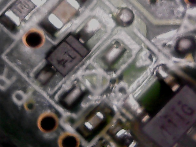

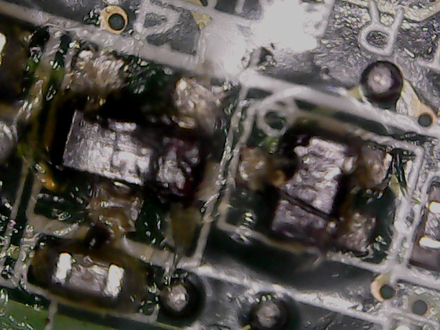

            #65
            Re: DV9500 blue LED ring of death ?
            photos
            The left diodes, I reckon : PD20
            The right diodes are PD21 and PD22....they're open from diode test...
            I can't find their datasheet yet...
            so not sure with the pin out yet...
            PD20 is ok with diode test, 0.267V and 0.5V

              #66
              that's TL311, please correct me if I'm wrong , there are two the other one with label PU7
              • BlueMidnight
                • Jan 2015
                • 489
                #67
                Both pictures are the same. They are a little too blurry anyway. But PD20 should have 3 pins. PD20 and PD21 should have 2 pins. Make sure you found the right ones. They definitely shouldn't be open circuit in both directions. Try searching for the part numbers on aliexpress and see if the pictures look like yours.
                I can't find the SW1010C datasheet either. But I found a cross reference match for 1N4148WS at Mouser. Looks like a pretty normal diode.
                Yes, TL331 has "T1IG" written on the package, so that is correct.

                  #68
                  could it be that one ? it's the closest to TL331, but it's only one, the other one is not fitted
