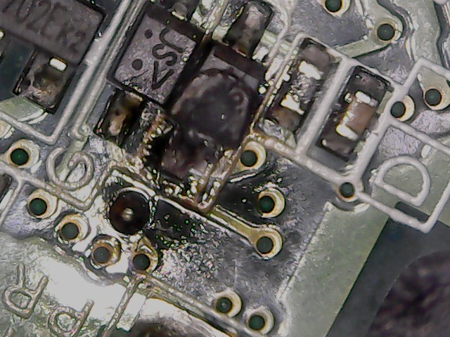

        Re: DV9500 blue LED ring of death ?
        I've reflown it and it's still not working, I suspect it's because of blowing diode near to the power supply input, I don't know what's the type, please have a look from the capture, thanks

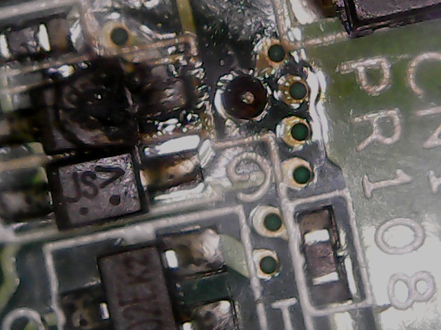

          What type of diode is it ?
            JS > diode ?
              Can it be :
              http://www.s-manuals.com/smd/js
              https://cdn.badcaps-static.com/pdfs/...fc45fbb828.pdf
              Is it only the diode or could be something else ?

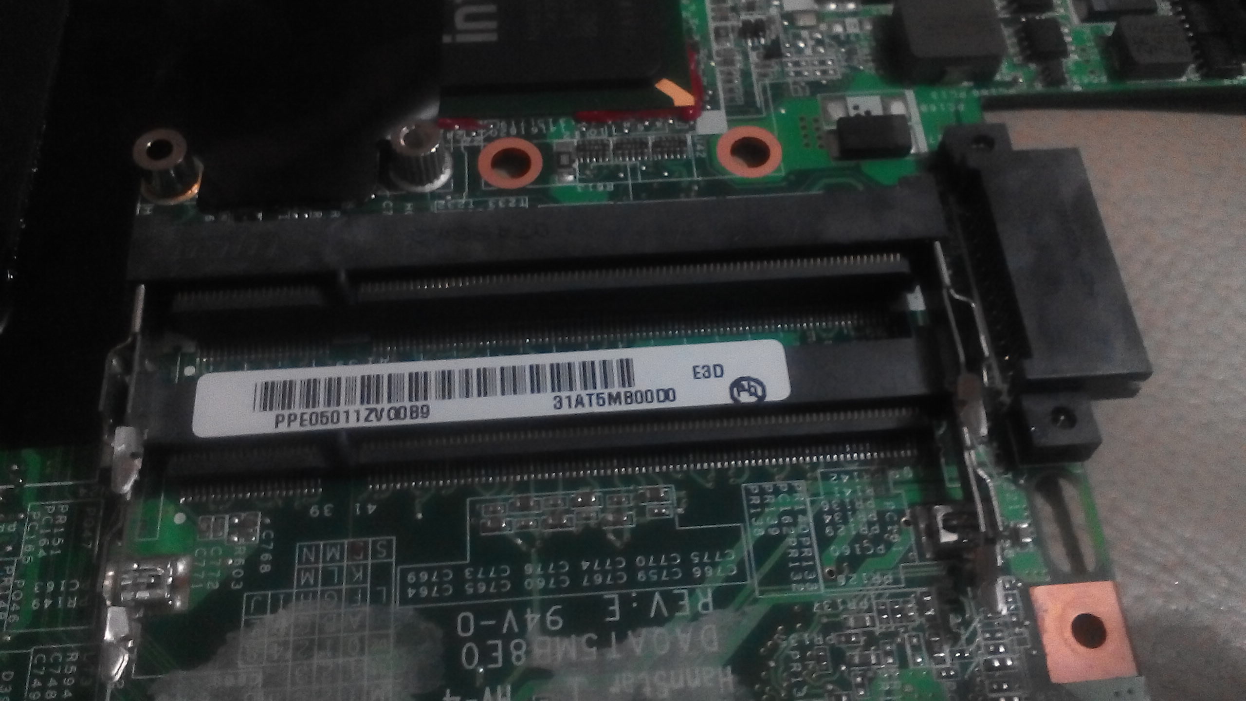

                That information would be on the schematic. Which motherboard does it have? Take a picture of the labels. They are usually on/near the memory slots.
                  The label, please see at the attachement, thanks
                      This area I suspect
                        Yes, that is the schematic. I know that is near the DC jack and the battery connector, so that might be the correct schematic page.
                        It doesn't look like it has a label next to the component on the board. But it's in a block labeled [D]. So that block of labels must be written nearby somewhere.
                          After looking carefully at how the traces connect in your pictures, I think those diodes are probably PD15 and PD16. They are both CH501H schottky diodes.
                            I think you're right....it's connected to CN17 positive side...
                              Oh and the datasheet says the marking is "JS" so that matches also.
