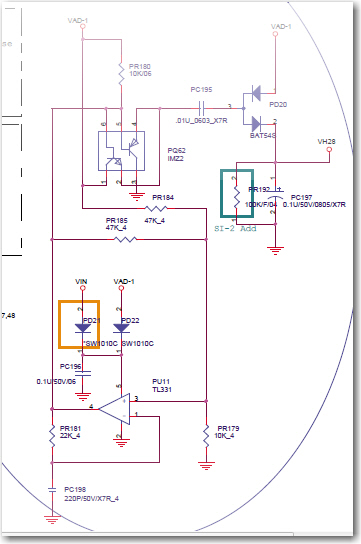

    Even I didn't see it at first. It's the point labeled "VAD-1" that connects both circuits. You can see it in small red text next to PD16.
    Basically, the 2 transistors generate a square wave by turning on one at a time. But if one transistor goes bad and is stuck on, then it will cause a short circuit from 19V.. through PD16.. through one transistor.. through the other... and straight to ground.
    It's possible just PQ62 went bad and only damaged itself and PD16. But it's a good idea to check all that stuff just in case. Don't want the new components to blow up too.

                    Electronics theory time...
                    That circuit uses the comparator PU11 and the capacitor PC198 to create a "relaxation oscillator". It uses the timing from the oscillator to trigger the bases of both transistors to either 19V or 0V. One transistor is an NPN and the other is a PNP. So when one is turned on, the other is turned off.
                    The only purpose of that whole circuit is to create AC voltage on capacitor PC195. That and the dual diode package PD20 form a "Cockcroft–Walton multiplier". It takes 19V and creates a much higher voltage from it (schematic says 28V). The 28V is used to turn on MOSFETs that are switching 19V. The gate voltage needs to be approximately 7V higher to turn them on.

                                    focus on PQ62 area :

                                        Yes, focus on that area. Check everything, but especially check PD21, PD22, and PC196.
                                        There is no easy way to test the TL331. You can make sure there are no shorts between any of the pins, but that's all. It has to be tested in circuit. But if you have a current-controlled bench power supply, you can power the motherboard with that and not worry about shorts destroying things.
