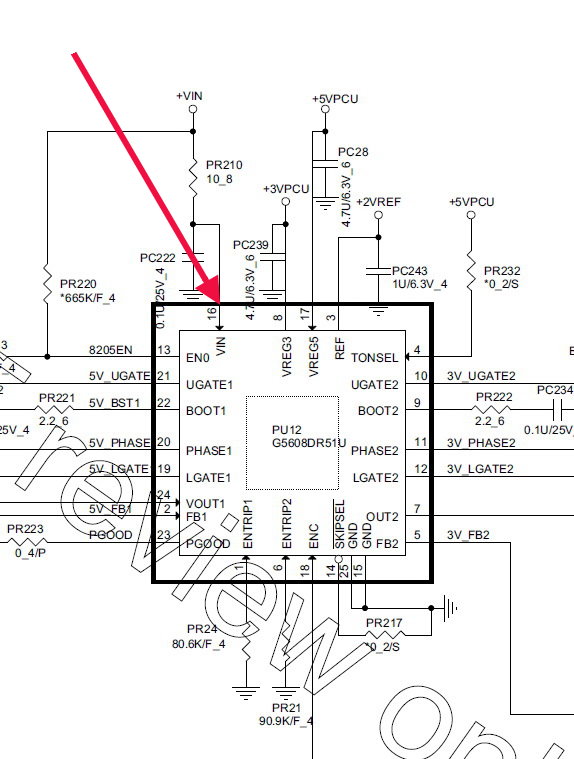

    hp15 da0u92mb6d0 NO Power
    hi Guys , i have here a HP 15-n229sa that doesn't power on
    Charging port 19.5V pin 1,2 and 5
    pin 6 and 7 - 6.8V ???
    Power Button 6.8V ???
    Also bios chip pin 2 ,7 ,8 - 6.8V
    it can't be normal no?
    Thanks.
    PS. i have attached schematic

    Re: hp15 da0u92mb6d0 NO Power
    how is the volt in pin 16 -vin- of pu12
    19v or 6.8v
    • claudyu07
      Claudyu07
      • May 2014
      • 125
      • Ireland
      19v in
      Pin 8 output 6.8V instead of 3.4
      Pin 17 - 6v

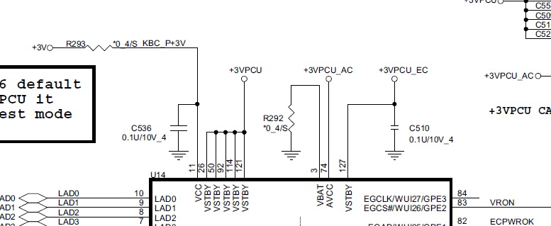

        PLS give me the voltage in pin 11-26-3-74-127 for U14 PAGE 27
        the solution is between to change U14 or PU12
        we must know exactly weher is the problem .
        and pls be sure about the replacement .
        • claudyu07
          Claudyu07
          • May 2014
          • 125
          • Ireland
          u14: 127 - 6.8V
          74 - 6.8v
          3 - 0v
          26 - 6.8v
          11 - 0v
            I think that you can changing the IC PU12
            use as replacement a new ic or use ic but sure working .
            good chance
            • subroto
              • Oct 2015
              • 230
              • Bangladesh
              Replace the 5v/3.3v chip. Your problem will be solve I think.
              Good luck.
