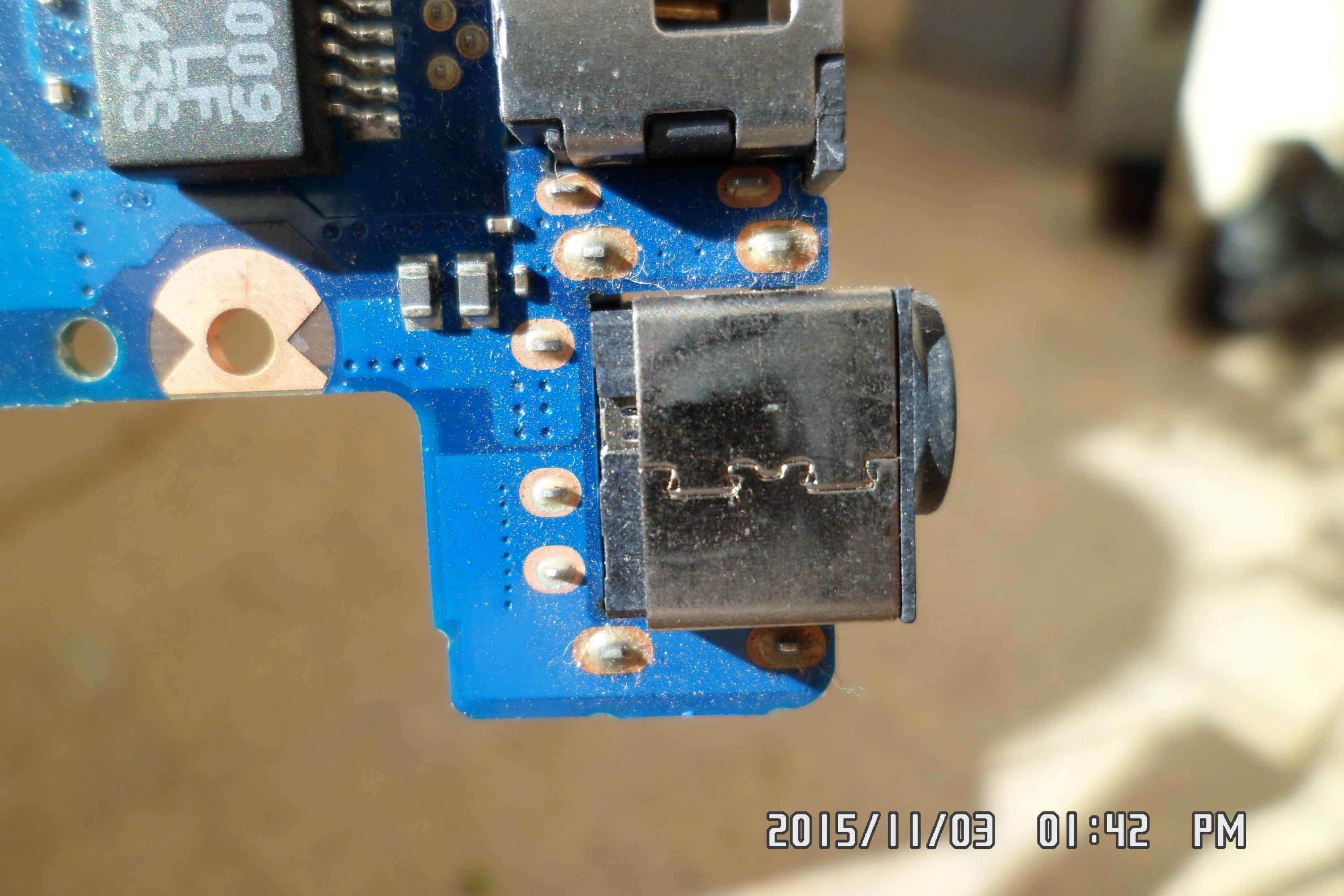

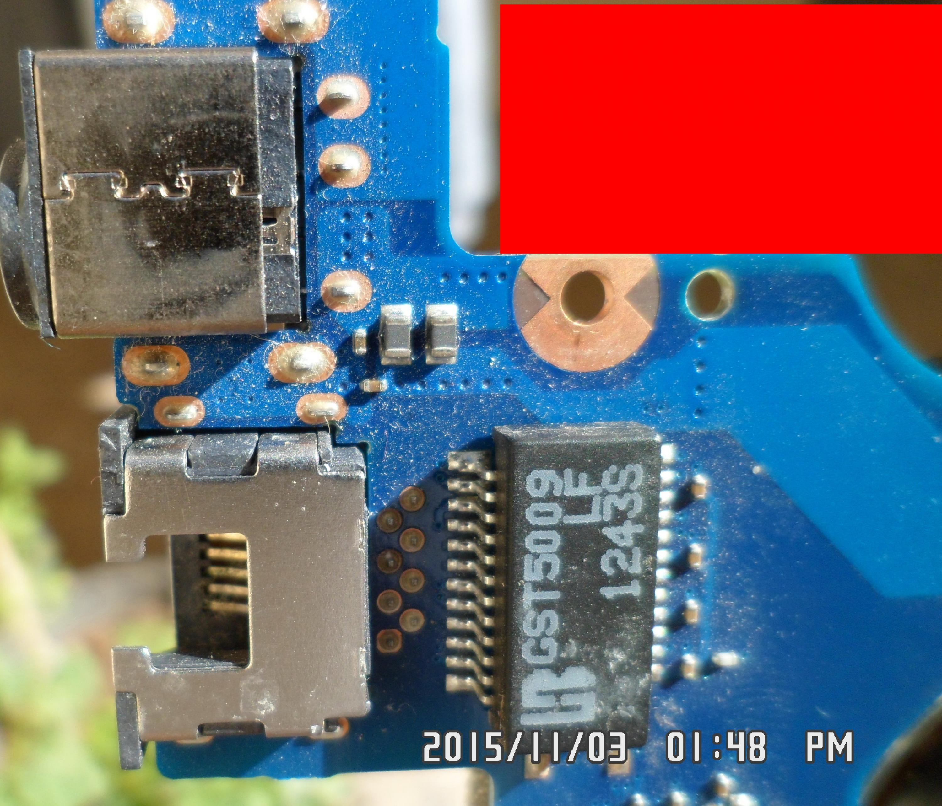

    Hi all i have here a Samsung NP305E7A-S01UK Motherboard numbers as follows (Samsung do love to confuse the issue)
    SCALAS 15 / 17A Board model no i assume
    BA41-01822A on board not there usual white sticker
    BA92-095088B on a sticker on the board
    BA92-095088A on a sticker on the ram slot.
    Ok here we go i will try and insert some images of said falier im basicly looking for the missing component numbers. or a diagram of the board. if anybody can help please. i did find another post on a russian website with the same series netbook ie NP305 with the same falier so have some part numbers although i would just like to make sure.
    The part numbers i have are
    hu-1m2012-121jt 0805 CHIP FERRITE BEAD (cant find anywhere local)
    0.1 uf 25v 0605
    i hope im aloud to post a link to the russian website post if not admin please delete.
    http://www.elektroda.pl/rtvforum/top....html#15039328
    the site has picks of his motherboard. the one i have here is a tad worse lol.
    these are of my motherboard before, and a couple of it cleaned (lol) and one of the crazy design!!
    hope they can all be seen and hopefully i can get some help with this one
    Many thanks

      well i would fix this board very easy with a dremel , you got multilayer short , you must very calmly and gently to clean layer by layer so the whole is gonna be a bit wider
      once you remove short , it will work

        sorry highpulse if you look at the hinge pick it touched the 2 raised caps that used to be there but also took out the other component that i cant find.
        the board has no holes persay just 2 missing caps and a damaged chip ferrite bead. the copper track is raised if i can find the ferrite bead i will clean up the board more and assess it from there many thanks for both of your help
        it all hinges ( omg what a apt pun ) on the parts really

          they are not capacitor but yes coils ! so what you have to do ITS the following if you have a power source , inject 19 volts on the 19 volt pin of the dc jack (were its soldered) chek if get in short or not , if it wont get in short , then simply clean and add 2 coils . or you can add 2 fuses ! let us know

            Are ok ty what about the bead part no have you a alternative number please? Im a little confused with the coils part number also sorry. Many thanks

                      HU-1M2012-121JT
                      I know its an old thread, but if somebody is looking for the same issue my partnumber will help.
                      My problem is that i dont know where to buy this coil HU-1M2012-121JT :\

                          I used two fuses. It works good enough to rescue the data and one can use the notebook till it goes completely to heaven.
                          I additionally removed the broken hinge to avoid that it shorts the parts again to ground.

                            I would think a Wurth 74279202 should work based on the specs
