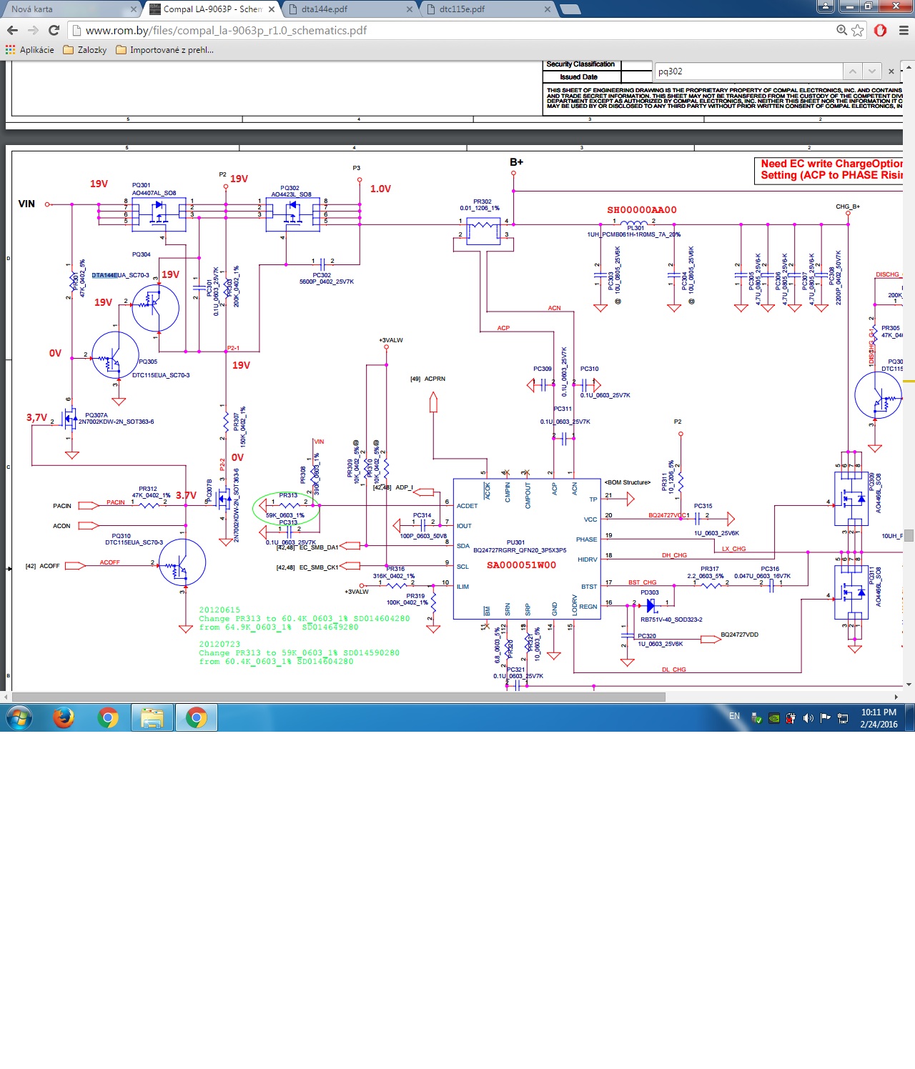

    Hello
    have this lenovo ideapad Z500 that have 1V on main 19V power rail
    i attach pisture with voltages

    Re: lenovo ideapad Z500 low B+ voltage
    i checked pr307 and have correct value
      voltage on pr302? voltage on pr302 if u remove it ?
        if i jump second mosfet notebook works ok. it is P channel so why it dont switch when pq304 is off and pq307 is on
          voltage pr302 ?
          if 0 volt check pr303 that is 200k.
            checked, its value is correct
              normally battery controller ic responsible for opening gate of that main mosfet........try change it or simply make jumper on main rail
                can you recheck measurements....? try without pc302 and try replacing second mosfet...
                  replaced, checked still the same

                            Something is choking B+ line, that could be a filter or an ic, only quick way is you can directly inject +20v to B+ line with your power supply, use the big +B coil somewhere close to CPU, then see if there is something heating up
