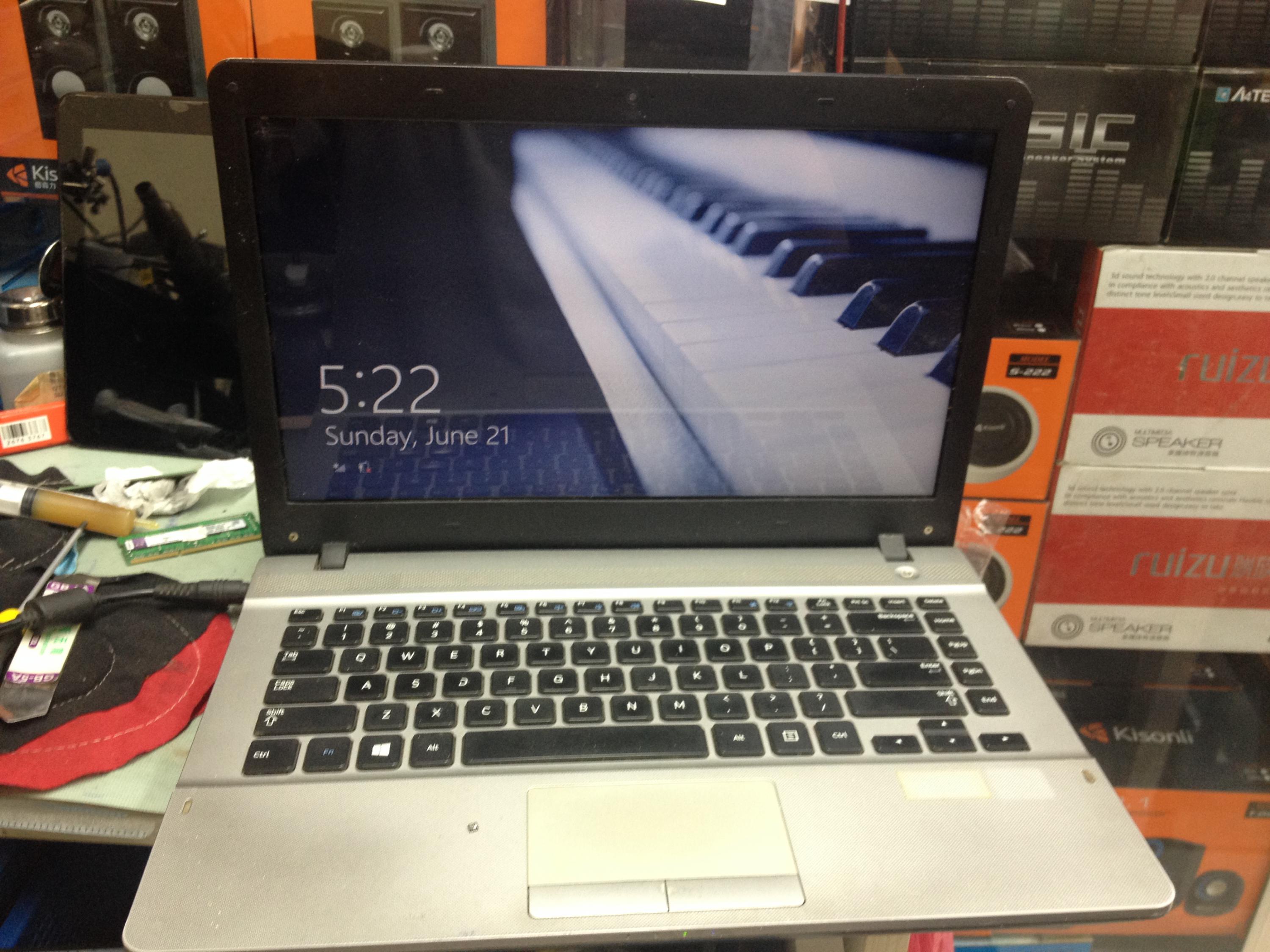

    hello guys.
    anyone who have diagram for samsung np300e BA41-02206A.
    Tnx.

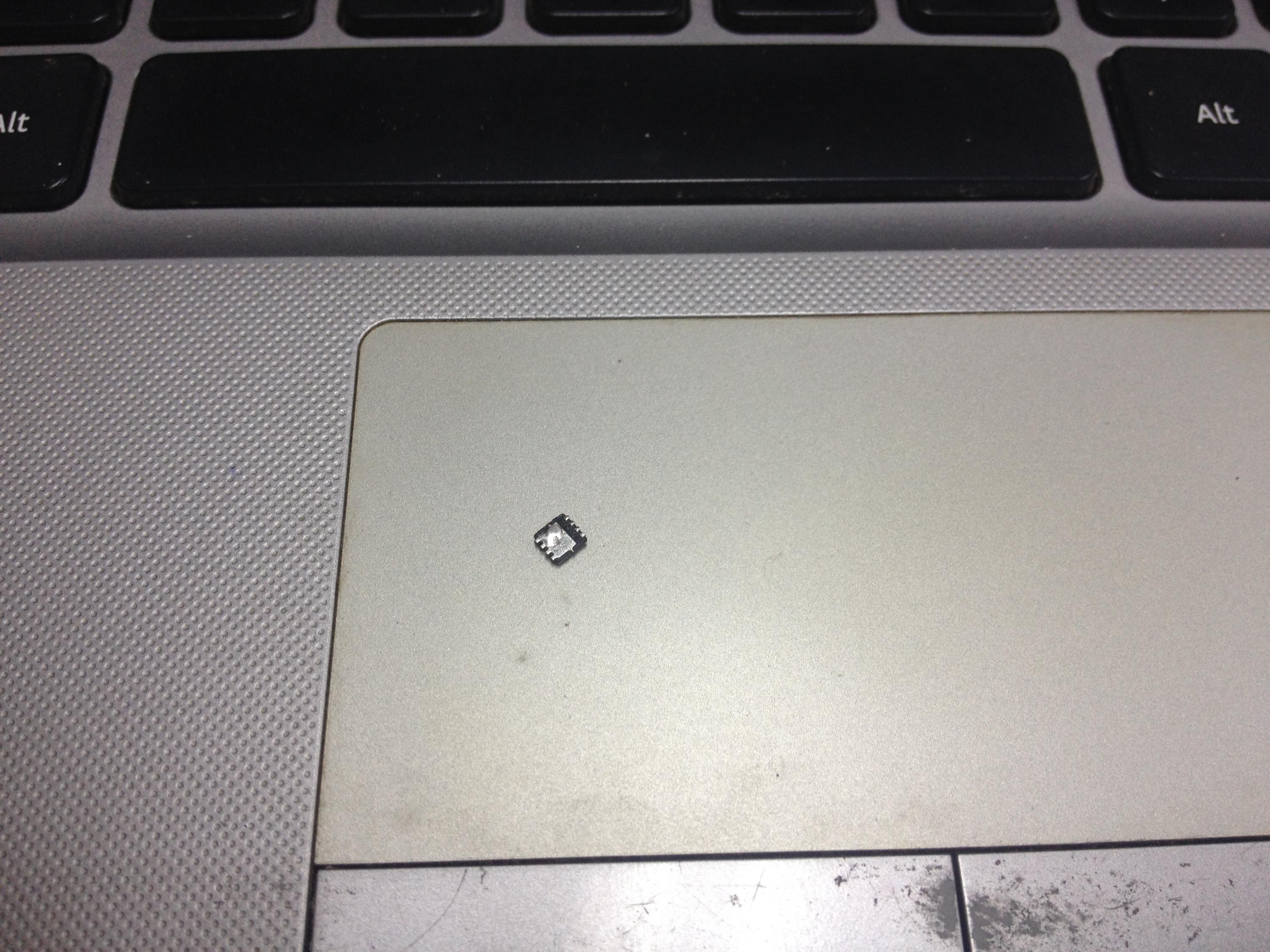

        Re: samsung np300e no power
        look near batt connector have 2 mosfet the second maybe shorted with ground replace it .
          thanks brother. I've found it, and replaced it and its works....
