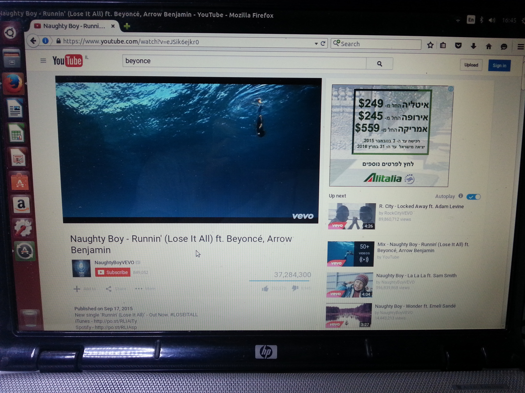

                          Re: Hp pavilion dv6000- 6960ej
                          I've installed real Ubuntu and its working fine.
                          I can watch youtube, online movies, music ect.
                          I don't why i can not install any windows, is there some ic responsible for this? Really weird.
                            I got picture here
                              Like i said, it's the nvidia gpu. This has been known for over 7 years already. Sooner or later it will fail completely.
