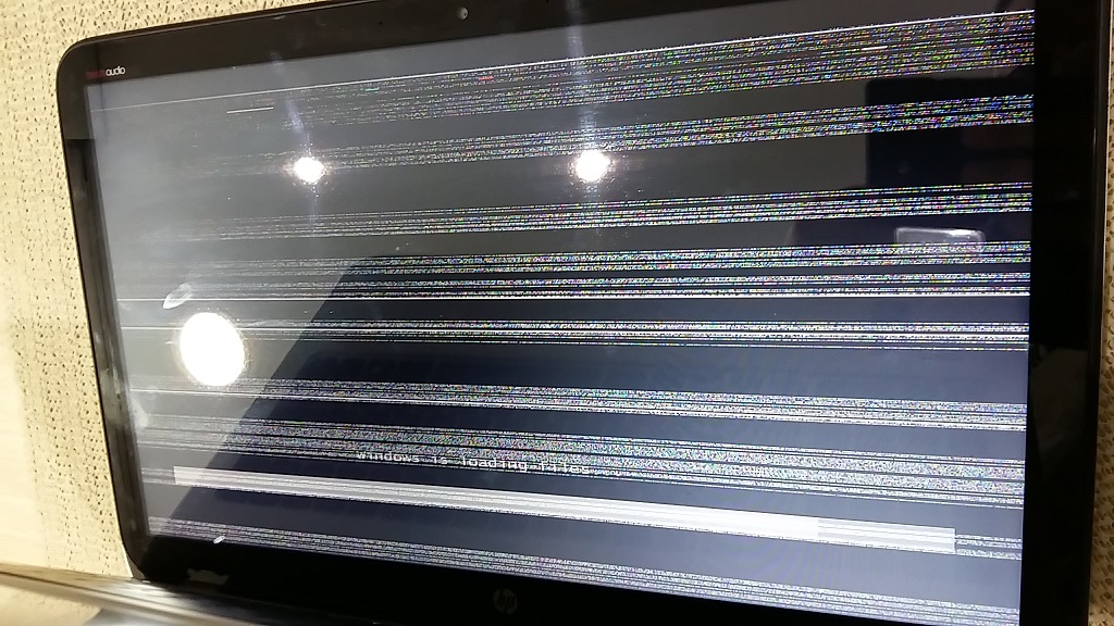

    - first time was a bad capacitor and a mosfet from power , now the board is running but restart, or no image, i notice that the coil from processor is very very hot , and bad image on display , see photo
    the mosfet that i change from power was AON6414A , i replace that with something compatible.

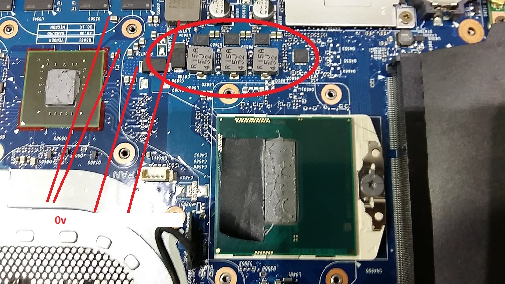

    Re: HP 15t-i100 processor problem
    How many V does it pass on those coils?
    • angel-boy
      • Jan 2013
      • 550
      • Romania
      1.77v , and i see that with laptop on , the nvidia is cold. no voltage see photo
          Your laptop is running on Intel® Core™ i7-4700MQ Processor (6M Cache, up to 3.40 GHz) with Intel® HD Graphics 4600 which is enabled by default at boot time, that's the reason of no power supply on Nvidia graphics.
          If you stop the bios at POST with "break/pause" key and you still have bad image, then you should try with another cpu to see if it makes any difference. I guess Intel graphics is damaged.
            are not 1.77V too high for main processor power?
            • angel-boy
              • Jan 2013
              • 550
              • Romania
              should be ~1.08 1.1
                  1.7v is too high...i would replace inductor , mosfets and cpu pwm....also pay attention on cpu pwm feedback resistors...Also try different cpu before doing anything...
