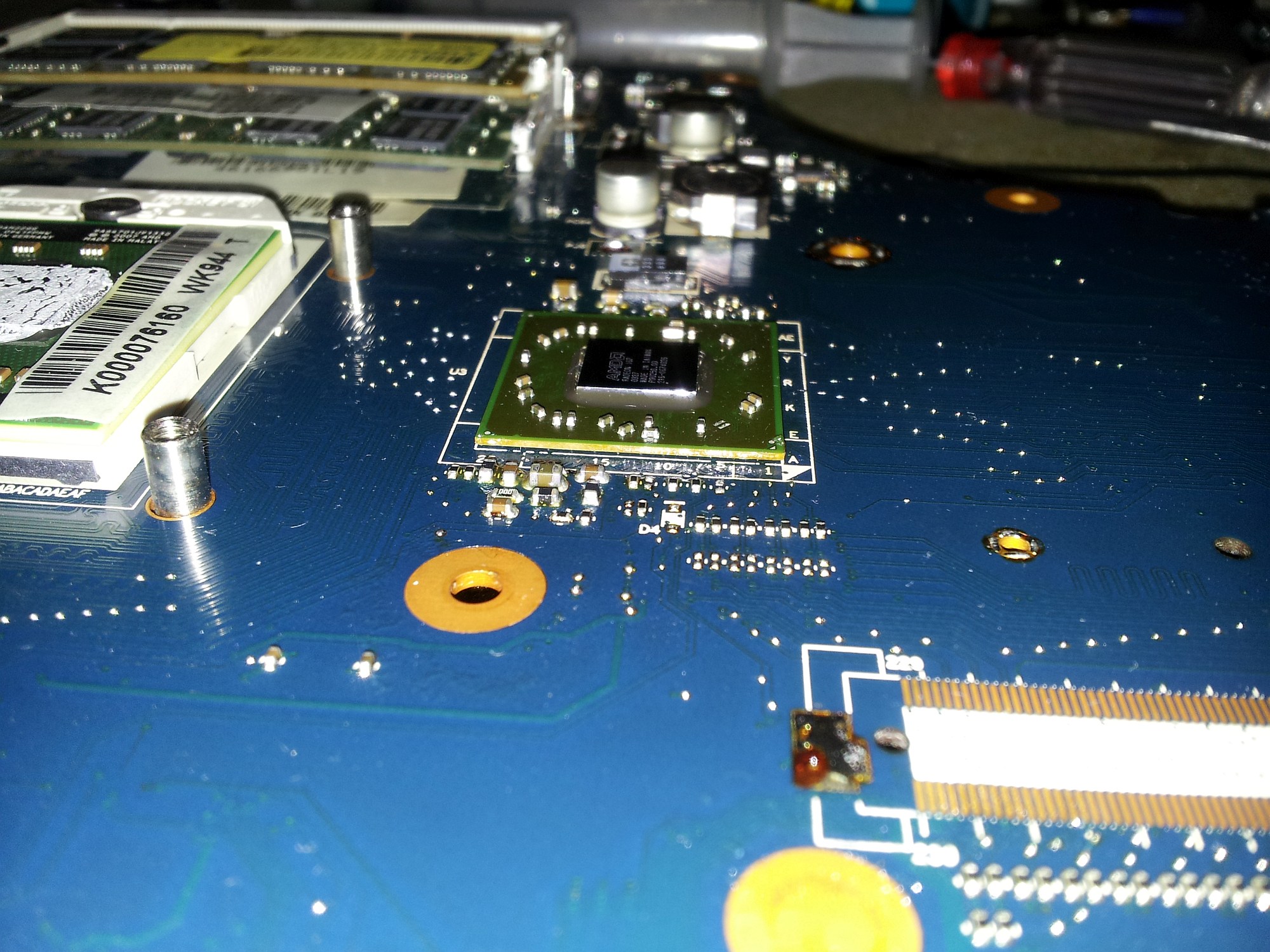

    Another one done today, first time getting help from the camera i just installed on the BGA station at work. I must say it helps a lot. A clean job with no issues.
    I have also replaced the thermal pad with an aluminum shim before putting the laptop back together.

    Fantastic work!
            is that foil around really needed? i never using it and never have a problrm

              ^^ It's not absolutely required but it is possible to melt plastic connectors or incompletely reflow other parts in the vicinity of the chip you are working on. The rework station that i am using now has a 60x60mm top heater so i play it safe and cover stuff up.

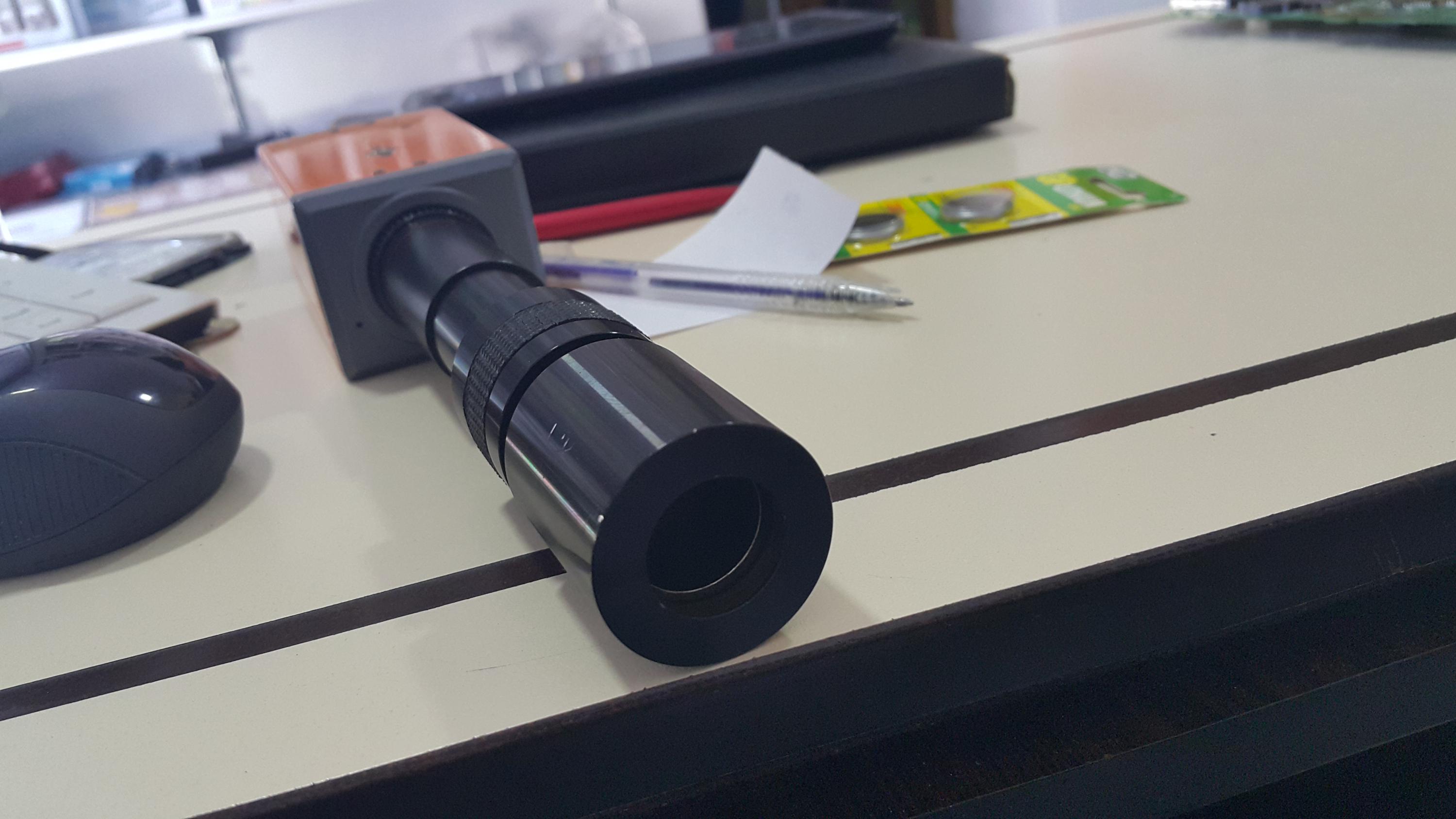

                Good job.
                What ccd camera you bought , i bought this cam but come to me without lens and have problem .
                Can you suggest me any link or model?

                  I bought the cheapest crappiest webcam with LED light and manual focus, it is actually good enough for the job. Added the 2 missing LEDs (it was supposed to have 3, but it only had 1 inside) and it's all i need.
                  I have also devised a high-tech mounting system comprised of packaging foam and double adhesive tape.
