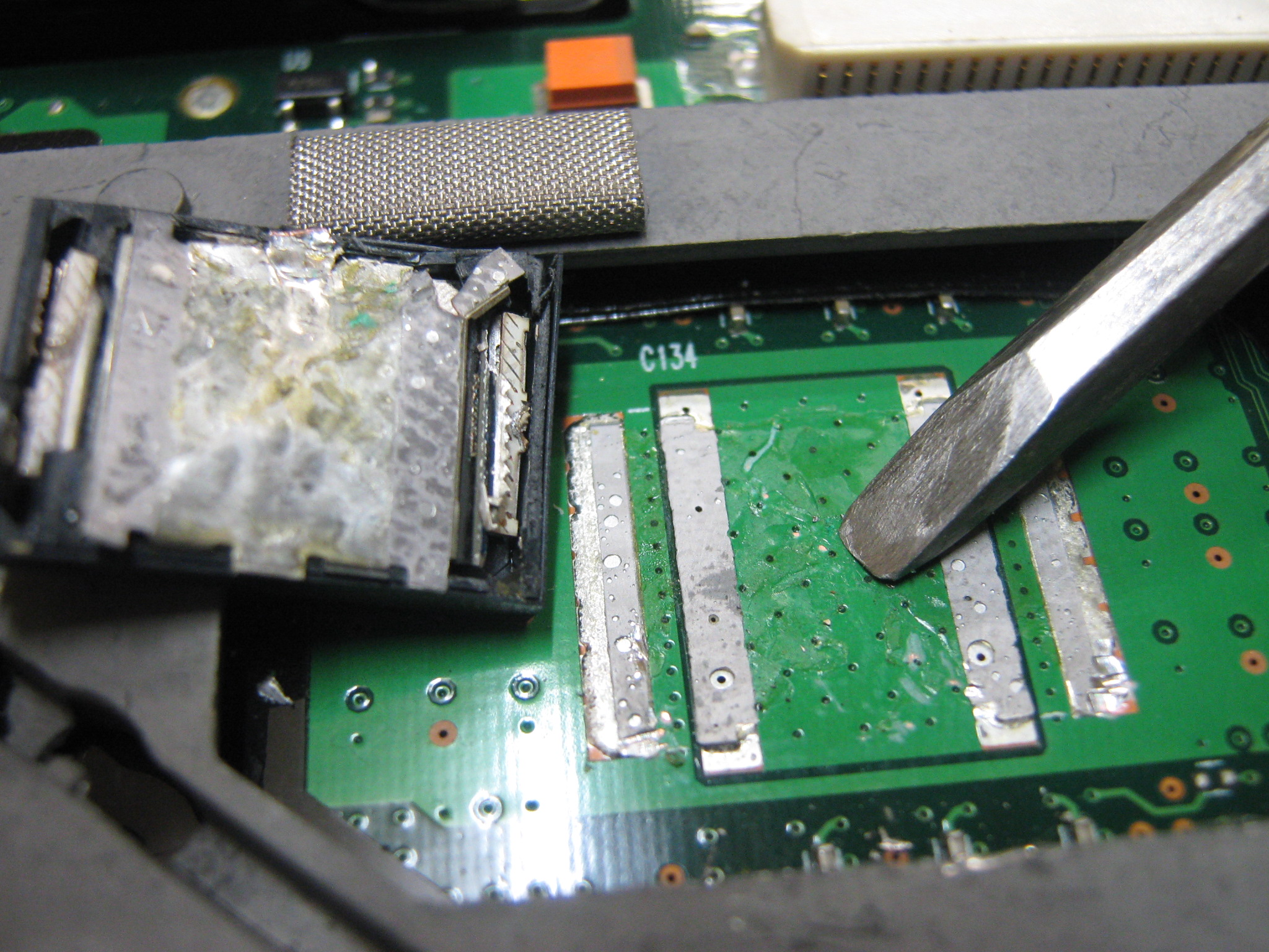

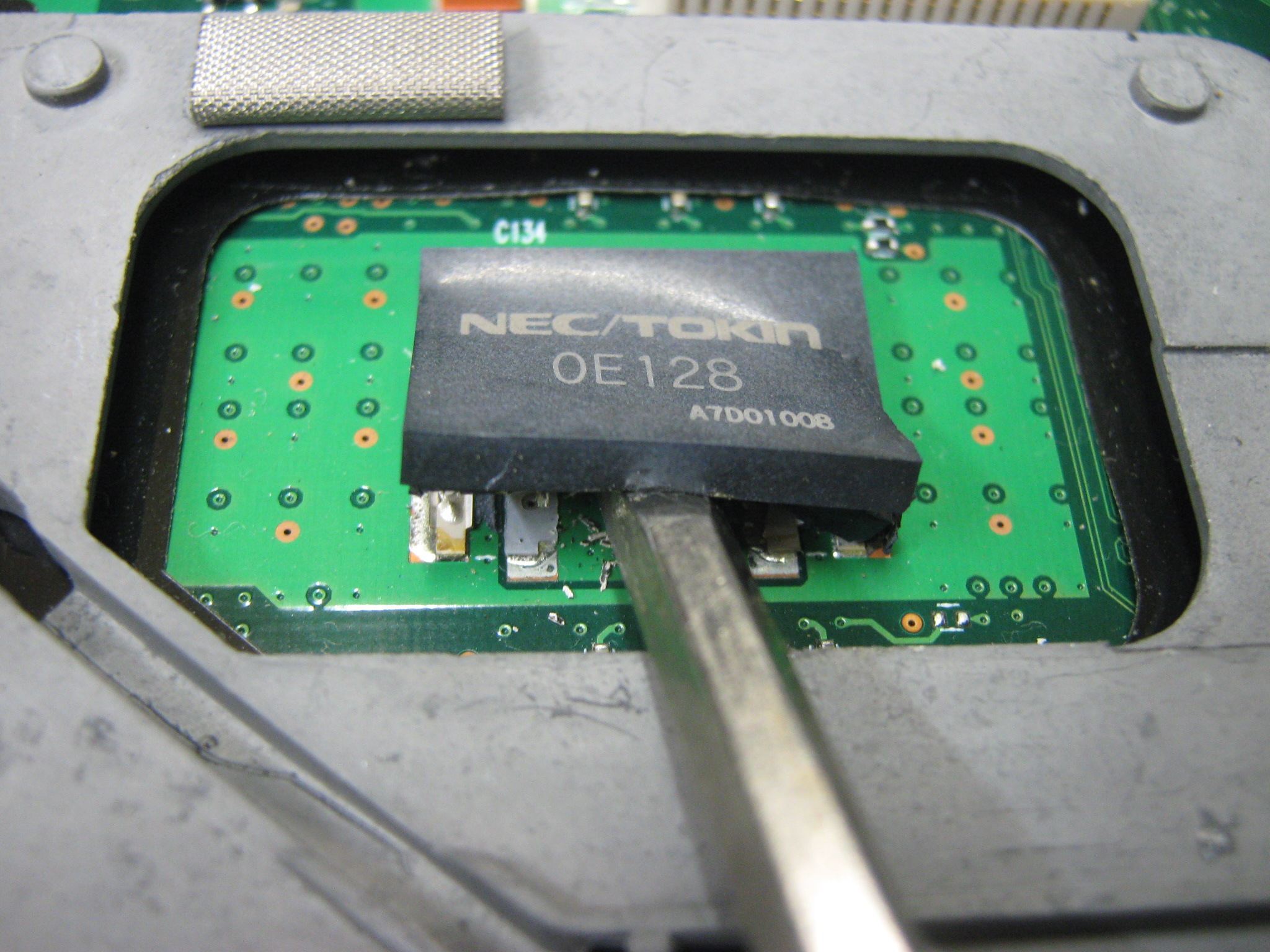

            I removed the NEC Tokin capacitor from a Satellite M200 today. I took some detailed snaps.
            The tool is a sharpened screwdriver, not razor sharp and with the corners being rounded slightly to reduce scratching.

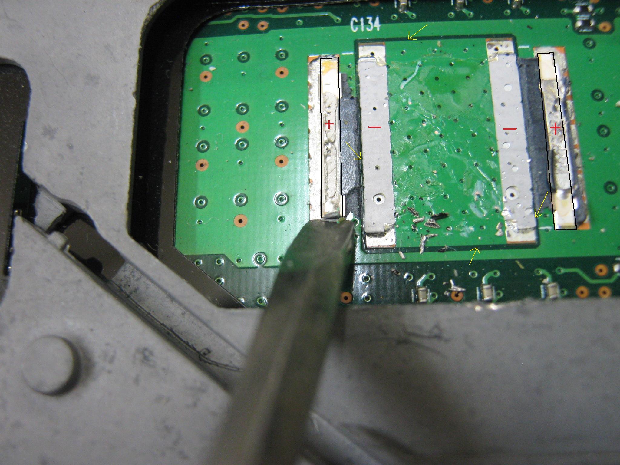

            The tool needs to be inserted between the capacitor's ground or - plate and the PCB with a slight twisting action.
            After the bulk of the capacitor has been removed, its two + strips will be left attached to the PCB. Use the tool to lift an end from the solder then peel it off with your fingers. The solder is very brittle.
            Individually remove any metallic flakes from the PCB from when the capacitor broke up.
            Do not interfere with the dark gap between the ground and the + pad areas, indicated by the yellow arrows.
