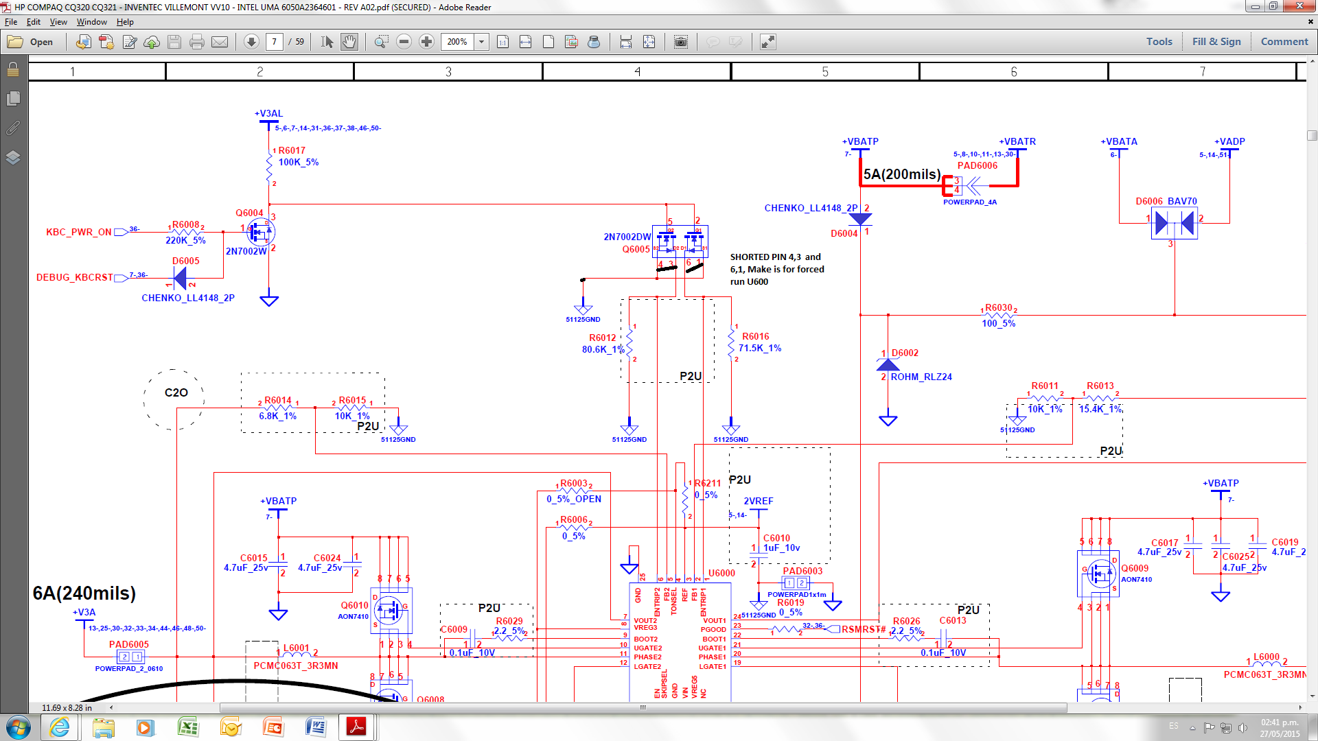

Hello friends, problem with compaq, its U6000 pin 8=3.3v and pin17=5v.
but no voltage in L6001 and L6000.
Flash bios also same. Change U6000 also same.
U6000 pin1 and 2= 0.7v
L6000 resitance to
gnd=18K
and L6001 to ground=1.1k
any idea please..
