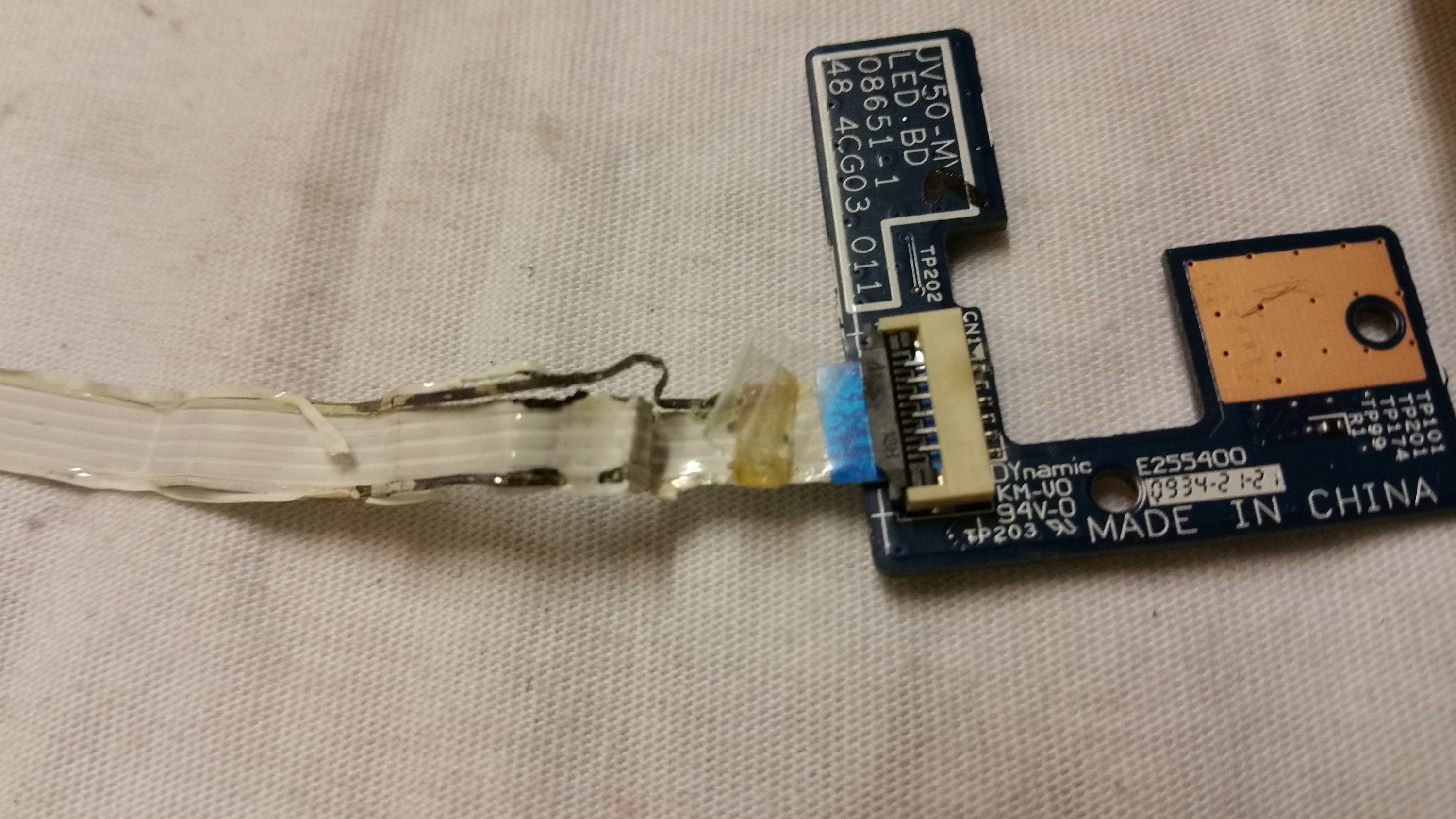

    Hi guys . got a laptop here ACER 5738Z with black screen , Internal and External.

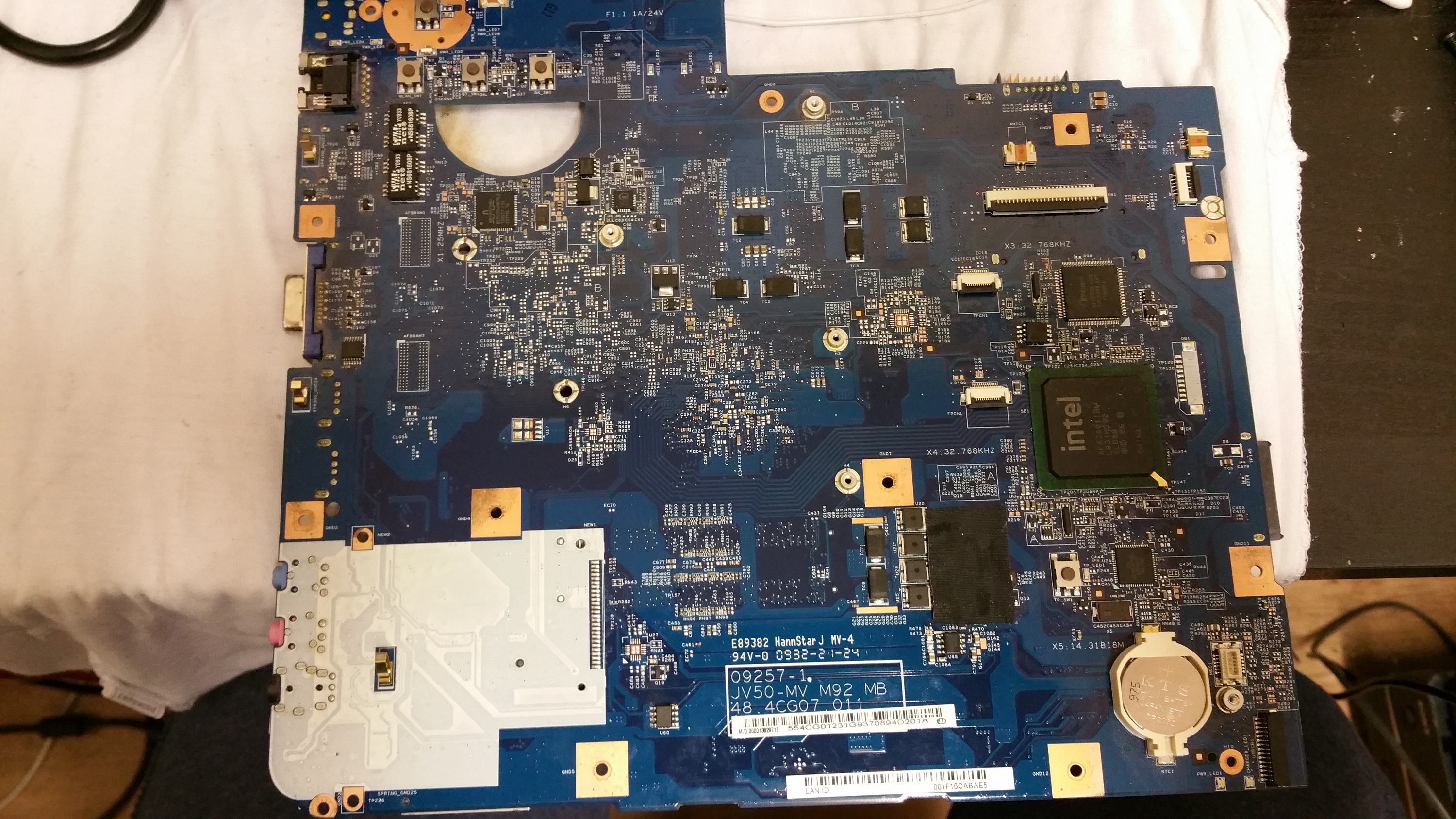

    Motherboard JV50-MV M92 MB

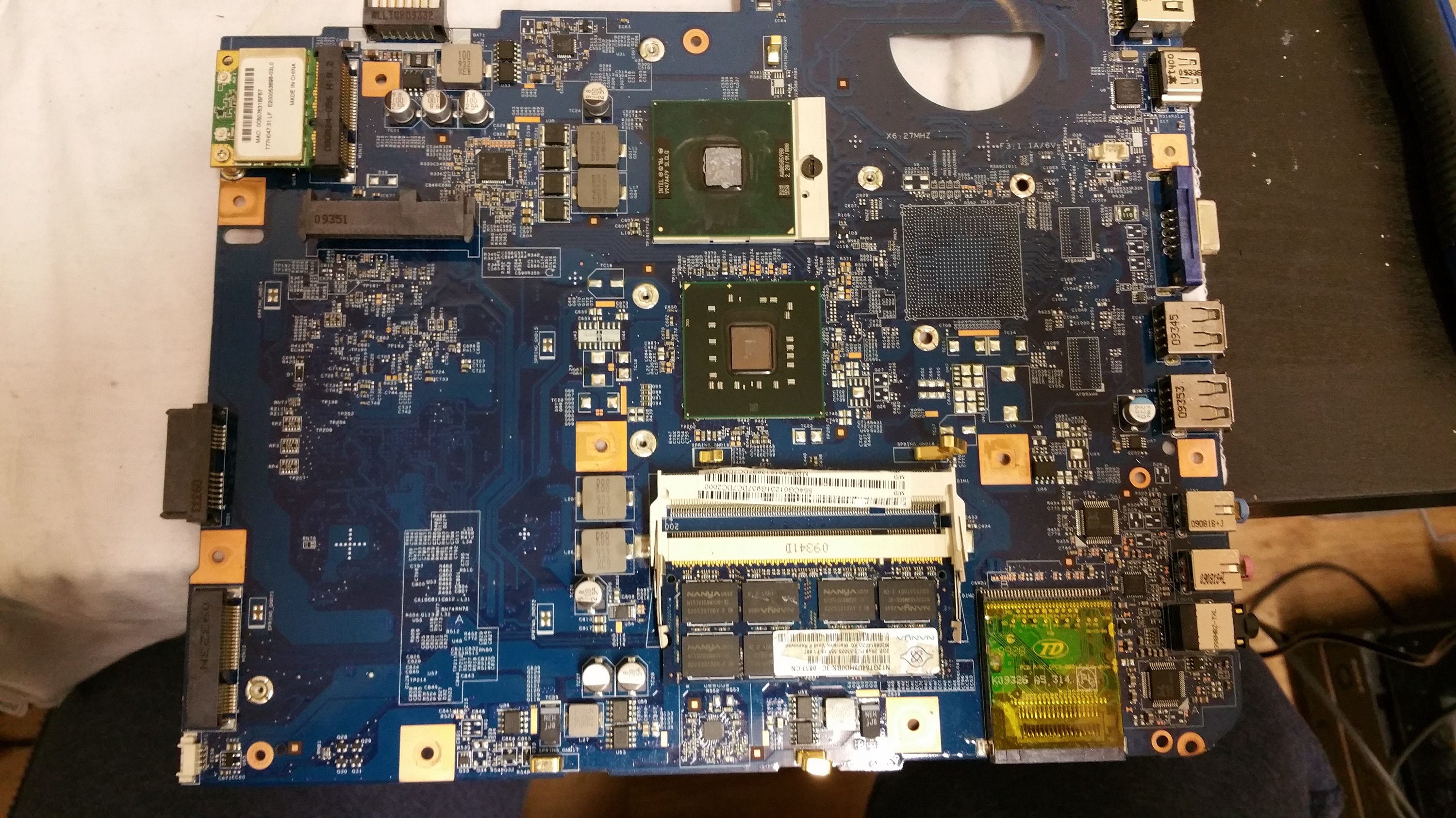

    When i first switched it on all lights came on , fan/dvd spinning and black screen. After few seconds i smell burning / melting so i just disconnected it and open it. ribbon connector for volume + - and P ( don't know what that means) from picture 5 was melted.

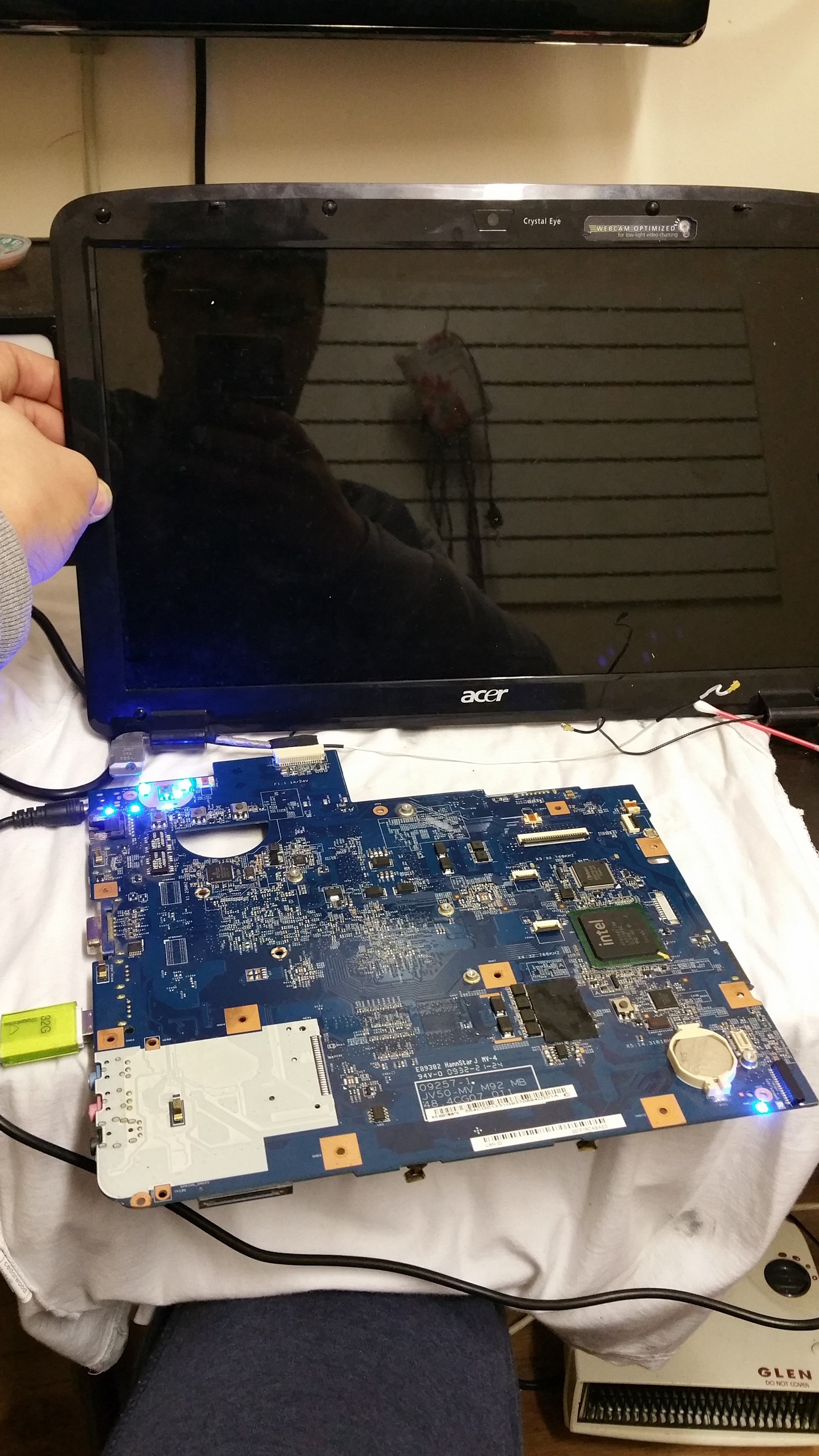

    Same black screen when board is out and only screen connected.
    Fan spins for 5-10 seconds then stops and all lights remain on.
    Bios chip reprogrammed.
    Tested with working ram , working screen , replaced CPU with working one.
    F1 for screen(15.6 CCFL) - OK.
    Any help ?

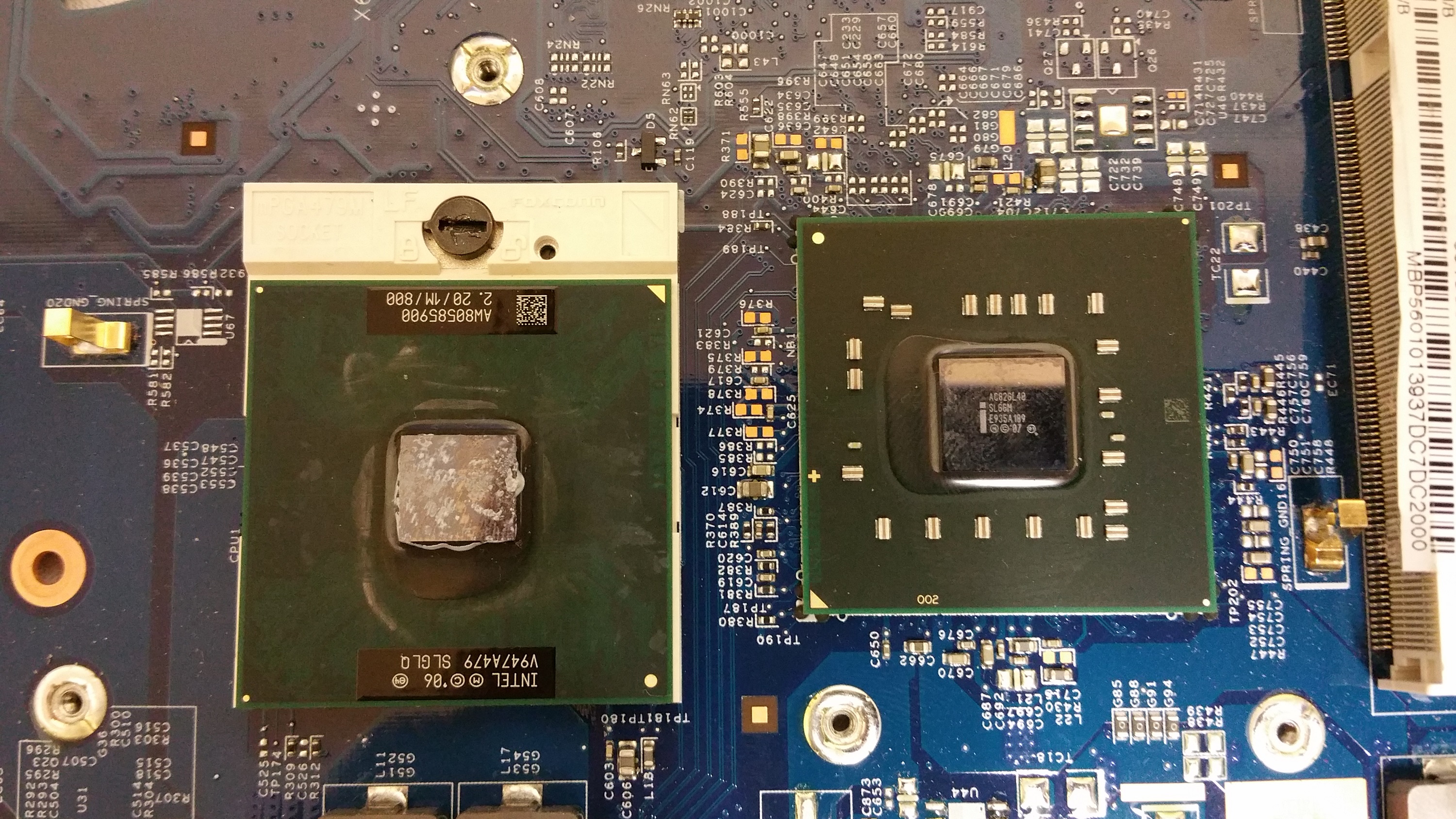

          cpu getting hot or northbridge (videocard)?
          • claudyu07
            Claudyu07
            • May 2014
            • 125
            • Ireland
            Re: Acer 5738Z , no video.
            both cold
            cpu tends to get hot a bit when i switch it on. after few seconds is cold
                  note down the coils and check the voltage on them.
                  check when its off : near the keyboard connector 2 fets, near the black tape 4 fets and 2 caps, see if the coils near memory give voltage, CPU coils and the fets.
                  and find diagram
                  • claudyu07
                    Claudyu07
                    • May 2014
                    • 125
                    • Ireland
                    @dj_ricoh on bios battery connector 3V
                    U6 & U7 no voltage on stand by
                    U21 & U23 no voltage on stand by
                    U20 & U25 - G -> D 19V
                    S -> D 19V
