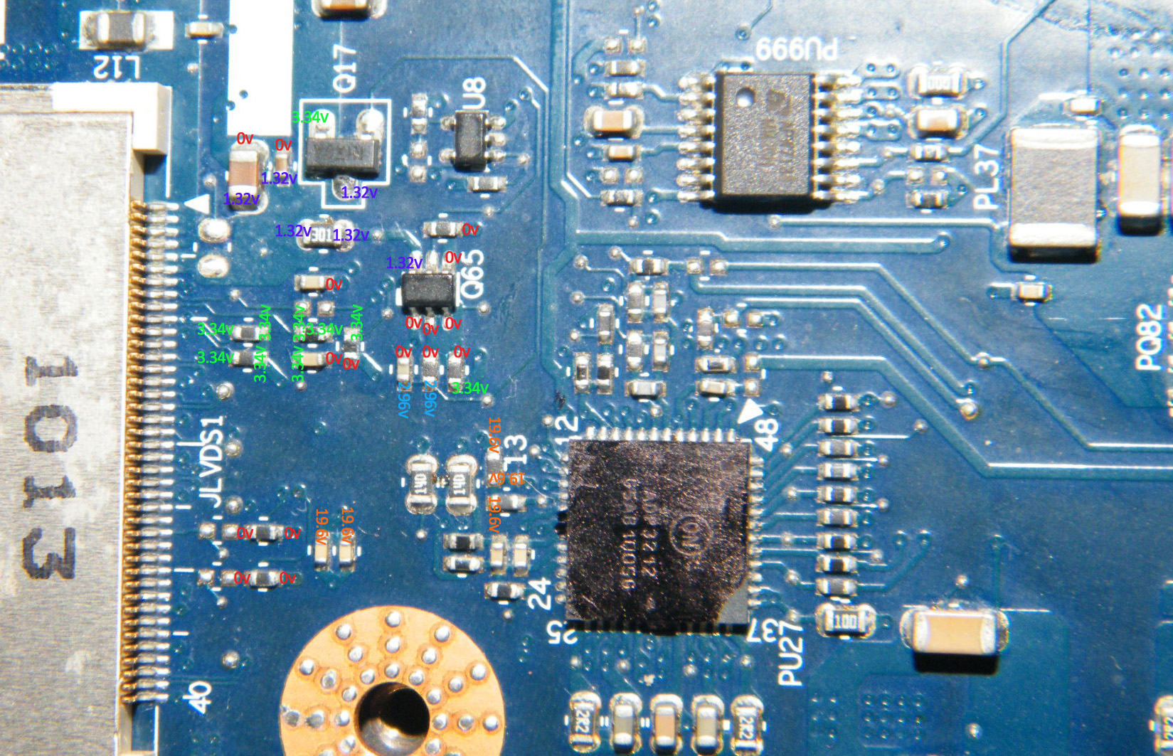

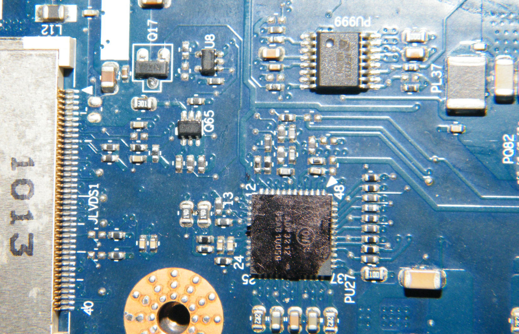

            Ive measure the voltages in the area, can someone confirm if Q65 or Q17 are the problem as the backlight is working just no display on LCD

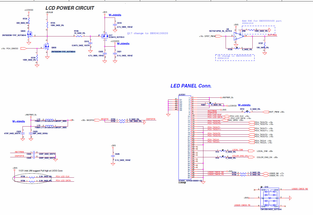

              Schematic?

                  Re: Acer Aspire 5741-A - White Display Problem - New70 - LA-5892P
                  Schematic added
                    Hey check R16, R731, R307, R733, R734, R736, R735
                      Do you get 3.3v at pin 5 of JLVDS1?
                          Yes, voltage 3.3v at pin 5

                                        q17 shot the pin source and drain it the 3.3v lcd vcc maybe a little leakage display will coming white or black
