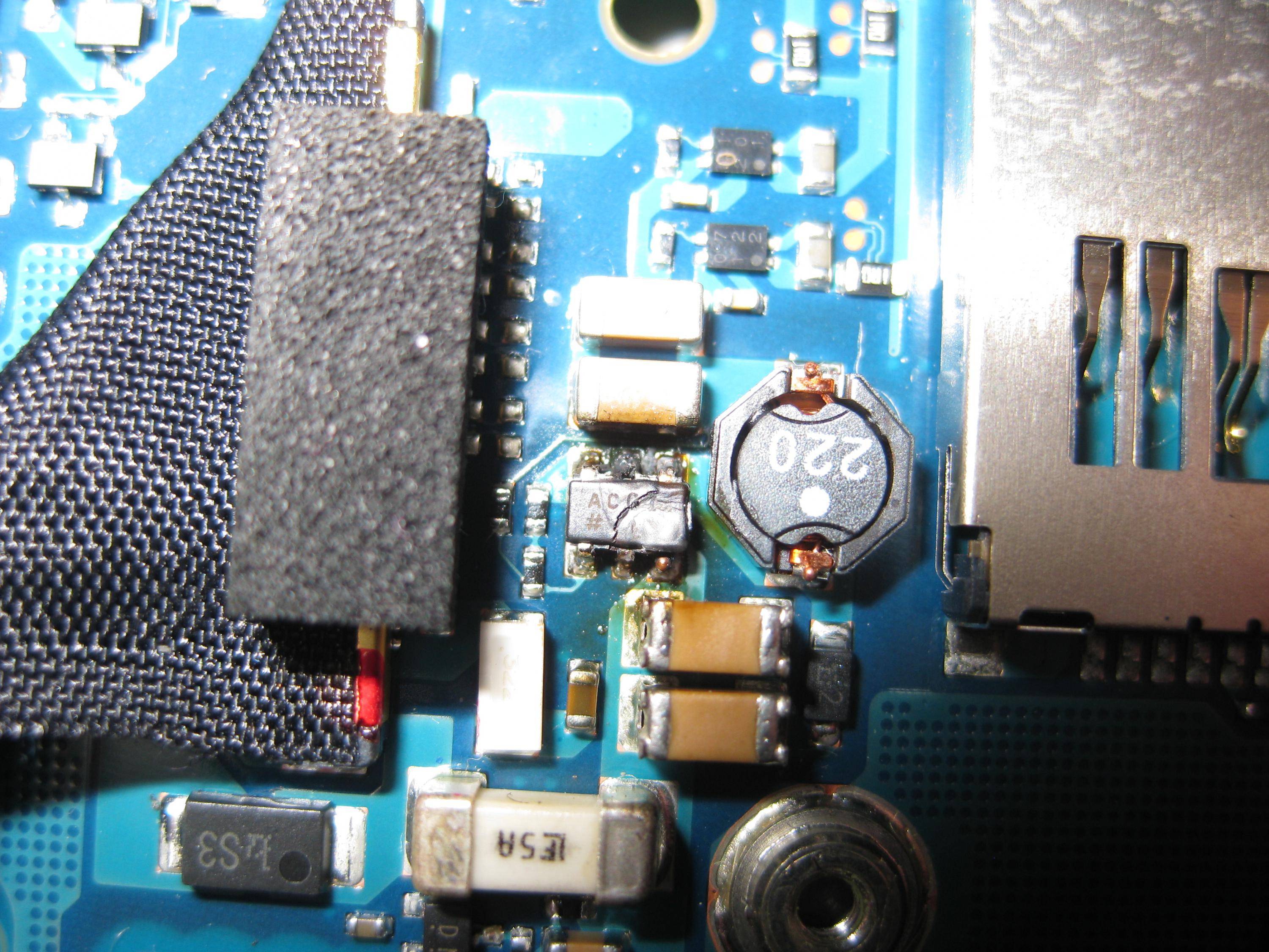

    Hi guys,
    I have a Toshiba Z830-10Q that is dead. The motherboard is an FALZSY1 A3162A. A component is blown near the power input, its 6 pins and the first few characters look like "ACC". By any chance is it a Maxim MAX1697UEUT? I just found an image on google that looks very similar.
    Many thanks,
    Graham

    Re: Toshiba Z830 blown component identification
    Seems like pinout does not match for Maxim, though the top marking indicates it.
    Pin 3 might be input, pin 4 output (is it connected to inductor?) or the opposite.
    Determine by removing and see which voltage is present.
    Pin 2 is GND? Pin 1 resistor divider to set the output voltage
    Maybe some GMT product...

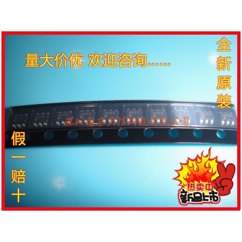

          Seems like it is a MAX1836EUT50
          Pictures here https://www.ebay.co.uk/itm/2PCS-X-MA...-/332200311992
            Thanks for information...
