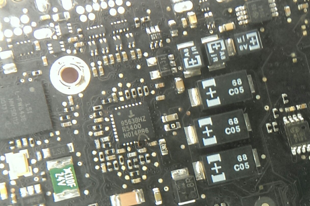

Macbook Pro 13 2010 820-2879-B IC Burn Short
  • tata123
    • Nov 2013
    • 104
    Macbook Pro 13 2010 820-2879-B IC Burn Short
    Macbook Pro 13 2010 820-2879-B big Burn on ISL 95638, change is not a Problem but the solder points are the Problem...
    Does anybody know how the Points?
    <a href="http://www.directupload.net/file/d/3921/8azp8qrb_jpg.htm" target="_blank"><img src="http://fs2.directupload.net/images/150309/temp/8azp8qrb.jpg" border="1" title="Kostenlos Bilder und Fotos hochladen"></a>
  • dellxps15
    • Feb 2014
    • 1588
    • italy
    Re: Macbook Pro 13 2010 820-2879-B IC Burn Short
    remove it and clean with flux and fresh solder.
    • tata123
      • Nov 2013
      • 104
      Re: Macbook Pro 13 2010 820-2879-B IC Burn Short
      remove and cleaning is not the problem, the problem is that the 2 lines are broken..
      i have to know how are the lines points?
      • dellxps15
        • Feb 2014
        • 1588
        • italy
        Re: Macbook Pro 13 2010 820-2879-B IC Burn Short
        sometimes flux + new solder fix the lines, so first remove component, then flux+ new solder and clean all with ipa and make a picture.
        • tata123
          • Nov 2013
          • 104
          Re: Macbook Pro 13 2010 820-2879-B IC Burn Short
          OK dellxps15 i will do it, but i think it looks pretty bad.....
          to repair the logicboard is not the problem, but to repair this points will maybe be...
          • rajeshkumar
            • Oct 2014
            • 44
            • india
            Re: Macbook Pro 13 2010 820-2879-B IC Burn Short
            remove and create burn track and then new ic used
            • tata123
              • Nov 2013
              • 104
              Re: Macbook Pro 13 2010 820-2879-B IC Burn Short
              Hello rajeshkumar and dellxps15
              here are the pic now 2 points are damage 1 is GND the other ??
              i will upload the schematic
              Last edited by tata123; 03-12-2015, 09:34 AM.
              • dellxps15
                • Feb 2014
                • 1588
                • italy
                Re: Macbook Pro 13 2010 820-2879-B IC Burn Short
                check if pin 13 and 14 are shorted by tracing back some capacitor or resistor in their line. if they are not shorted, try to clean or make a better picture of pin 13 and 14 area. pin 14 is vin so is the main power supply of that chip with higher voltage. before to go on we need to know if we have some short there.
                • tata123
                  • Nov 2013
                  • 104
                  Re: Macbook Pro 13 2010 820-2879-B IC Burn Short
                  The IC are ok, the trace point of the last also ok...
                  Yes 13 and 14 are shortet, where can i took 14?
                  Here i have a new Picture...sorry for the bad last one...
                  http://postimg.org/image/3ncbypy9p/
                  Last edited by tata123; 03-12-2015, 11:07 AM.
                  • dellxps15
                    • Feb 2014
                    • 1588
                    • italy
                    Re: Macbook Pro 13 2010 820-2879-B IC Burn Short
                    here are other spot for pin rebuild. but before do anything, clean whole part with much flux and desolder wick.
                    could be also that some layer is melted and board cant be repaired.
                    Last edited by dellxps15; 03-12-2015, 11:54 AM.
                    • tata123
                      • Nov 2013
                      • 104
                      Re: Macbook Pro 13 2010 820-2879-B IC Burn Short
                      Yes i have clean it and it looks much better yet.
                      Yes it could be destroyed (layer), i will test it...
                      Thank you
                      Last edited by tata123; 03-12-2015, 02:14 PM.
                      • dellxps15
                        • Feb 2014
                        • 1588
                        • italy
                        Re: Macbook Pro 13 2010 820-2879-B IC Burn Short
                        look at my picture, if u measure short on marked area 12 13 14 are they shorted ? no ic pins but these alternative location.
                        after that measurement. measure indiode mode pin 14 and located pin 14 to see if they are the same line, do the same with pin 13 and location 13 to see if they are proper 13-14 pads, or some other pads.
                        i hope u understand what i mean.
                        Last edited by dellxps15; 03-12-2015, 03:11 PM.
                        • tata123
                          • Nov 2013
                          • 104
                          Re: Macbook Pro 13 2010 820-2879-B IC Burn Short
                          Yes i understand you good, but the problem is that it is a short in a layer...i have to repair that fist.
                          Last Question for tonight, Why is this melting when i power supply in it?
                          Last edited by tata123; 03-12-2015, 04:17 PM.
                          • dellxps15
                            • Feb 2014
                            • 1588
                            • italy
                            Re: Macbook Pro 13 2010 820-2879-B IC Burn Short
                            layer are compromised... i think u cant do so much if it burn when u plug power supply.
                            • Stephen
                              MacBook Pro 14" A2442 Short on PPBUS_AON but no short present when injecting voltage!
                              by Stephen
                              I check PPBUS_AON and there is a short present on the line, the computer shows a short when testing for short to ground, so when I inject voltage into the line, I get 0AMPS so no short is showing up. I have replaced a blown cap on this board that exploded and tested for the short and it is now removed. Any suggestions? I tested voltage at the line when the fuses are connected and I am getting 1.2 Volts at the line.
                              02-06-2025, 12:03 PM
                            • sdogs
                              macbook pro M1 a2338 no video on internal display PP3V3_S2 short
                              by sdogs
                              Greetings to the entire forum, I ask you for help because I'm going crazy. A dear friend of mine gave me a macbook pro M1 A2338 that only works with an external screen. With the internal one, no backlight or image. Only the external display is detected from the system settings.
                              First I changed the display flat, then I made a backup with time machine and tried a reset in dfu but nothing to do, always the same problem.
                              I analyzed the logic board, it shows no sign of liquid or visible damage. I then moved on to examine the logic with the thermal camera and found that the UP701 chip was...
                              06-27-2025, 01:58 PM
                            • sdogs
                              macbook pro M1 a2338 no video on internal display PP3V3_S2 short
                              by sdogs
                              Greetings to the entire forum, I ask you for help because I'm going crazy. A dear friend of mine gave me a macbook pro M1 A2338 that only works with an external screen. With the internal one, no backlight or image. Only the external display is detected from the system settings.
                              First I changed the display flat, then I made a backup with time machine and tried a reset in dfu but nothing to do, always the same problem.
                              I analyzed the logic board, it shows no sign of liquid or visible damage. I then moved on to examine the logic with the thermal camera and found that the UP701 chip was...
                              06-27-2025, 11:26 AM
                            • Arshad alam4659
                              MACBOOK PRO A2141 SSD SHORT
                              by Arshad alam4659
                              I HAVE A MACBOOK PRO A2141 820-01700 THIS BOARD IS PP2V5_NAND_SSD1 SHORT TO GROUND THEN I CHECK ONE SIDE U8600 IS SHORT THIS SIDE IS ONLY ONE CHIP U8600 OTHER SIDE
                              PP2V5_NAND_SSD1 IS OK AND U9100 U9200 U9300 U9400 IS ALSO OK Will removing the U8600 fix the board or will I have to install a new one
                              Link to boardview --> https://www.badcaps.net/forum/troubl...91#post1449091
                              10-01-2024, 08:26 AM
                            • envym
                              MacBook Pro 2018 with Activation Lock
                              by envym
                              Hi everyone!
                              I have a 2018 MacBook Pro (with Sequoia OS) that I've been using for years with no problem. I recently received an M2 MacBook Pro so I'm mostly using it and not the 2018 one, but since a friend of mine needs a computer, I thought I could restore my 2018 and give it brand-new-like to my friend.
                              I tried using the built-in tool to restore the MacBook (Settings > General > Transfer or restore > Delete) but it got stuck when trying to remove the Find Device configuration (it asked me for the password for my old Apple ID -now I use the same account but...
                              06-27-2025, 08:54 AM
