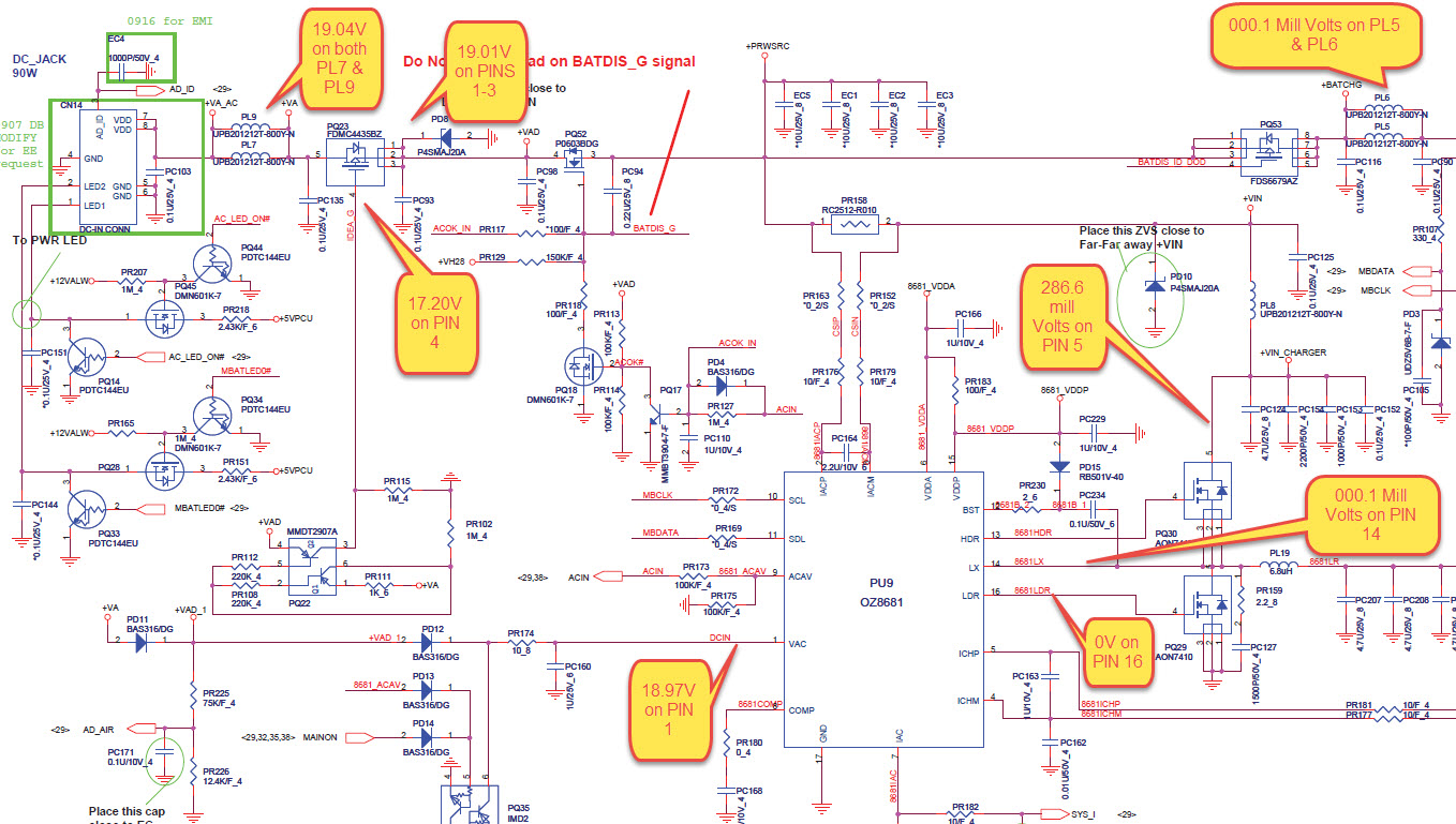

    I have a HP laptop that doesn't power on make any noises or anything. I am new at diagnosing so please be gentle. I found a schematic for the motherboard & I have 19V coming from the power jack plug in that is connected to the motherboard when plugged in. When I placed the positive lead of the multimeter on pin 1 or 2 & the negative on ground pin of CN13 where the laptop battery inserts into I get no voltage. I do not know if I need to remove other components to test them or what to do next. I would appreciate any help provided.

    I did some testing but I am not sure if this chip is the problem or not PU9.

      i make some edits in my reply after reading your tested points...check the short circuit on PWRSRC line .

        check the ohms with the Gnd on PQ52 source PIN 3 are there any short circuit?

          I received 0.L under ohms when connecting the positive probe to pin 3 & the negative to ground.

            What do you think I should check next?
