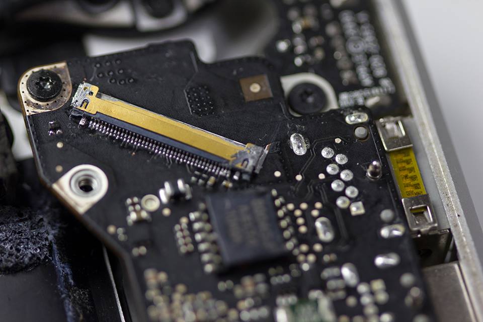

    macbook pro a1286 no image on internal but ok on external
    Well this computer was a working one , but we had here another that the board was with damaged connector , my collegue swapped screen assembly between machines , and he fucked up the good board , that was giving image on both internal and external , i noticed that the board was with some burned pins , so i replaced the socket , but still no image on internal !
    the board is a 820-2915-b , so if anyone have this schematic and have certain parts to chek first let me know .

        for what i notice , on pins 38 39 and 40 i got 0 ,
        i got the enable lcd 2 and 3 pins 3.3 volts
        i heard the chime , but no image , but i notice i slight diference on the screen getting more black the screen .
        will send the photo in a minute

          Re: macbook pro a1286 no image on internal but ok on external
          pins 2 and 3 and 38 39 and 40 are bit merged with the solder , but because of ripped solder mask , but they are in same trace , so no problem , about the outher pins , are all well soldered and making good contact

            PPVOUT_S0_LCDBKLT got really 0 even cheking the coil l9701 , 0 volts ,
              if u put a light can you see image ?
              without hard drive wait a bit and you should see a folder with a ? in the middle lower part of lcd.
              if yes check backlight little 0402 fuse and backlight ic.
                backlight IC AKA U9701 ?
                  yes there no backlight i got image very deep
                  the ? folder since i dont have hdd here
                    check first F9700 fuse for continuity, if it works or not. you should have 12.5volt both side.
                    yes u9701 is backlight ic chip. if fuse is ok, check if ic has not burnt.
                      well must be that one since i dont have any voltage on the coil that feed the PPVOUT_S0_LCDBKLT
                      before cheked that i got VIN on pin C1pad and also PP3V3_S0 got 3.3 on pad C4, confirmed that voltage on the C9711
                        yes was the fuse , i was tring to find this fuse for some good time , and didnt find it , well its always good having some people who are more expert in certain areas thk once again dellxps , 2 apple machine you help me out
                          you welcome. for fuse buy 2A fast blow 0402 25 or 32volt. they are on ebay.
