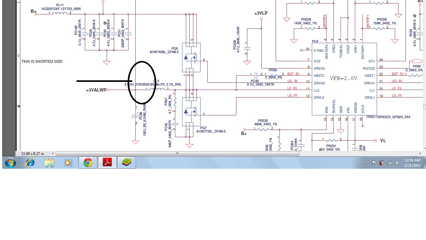

      when i check the 3.3 volts capacitor on board it is shorted.even when i try to remove that capacitor the layout is shorted.. i upload the image for additional info..

          Unsolder PL3 and check which side of the short side PWM or load , the result here

                If short coming from supply, possibly upper fet is shorted. Common fault. For quick trace, feed 3v on shorted side after removing pl3. Shorted component will heat up

                  sir i already unsoldered pl3 and one side is short to ground.. what is next?

                    What kind of side?
                    the one that comes from the PWM or the one that the load?

                        here is the image i measure the short line

                          What resistance at pin 11 PU4?

                                  Re: Acer aspire one NAV70 No Power
                                  kabayan,
                                  sa load ang short mo.
                                  hunter, the short goes to load to answer your question.
                                  what you can do to trace that quickly is use a dc bench ps set to 3v 1amp and monitor parts going to that direction. shorted part will heat up pretty soon with the setting. if you want to heat up the shorted part slowly, use lower voltage than stated above and gradually increase if nothing heats up but make sure you wont go above stated working voltage of that rail.
                                  to answer another question you asked on how to measure pin 11 of PU4, just use your negative prod to mobo's ground then positive prod on pin 11 using ohm meter.

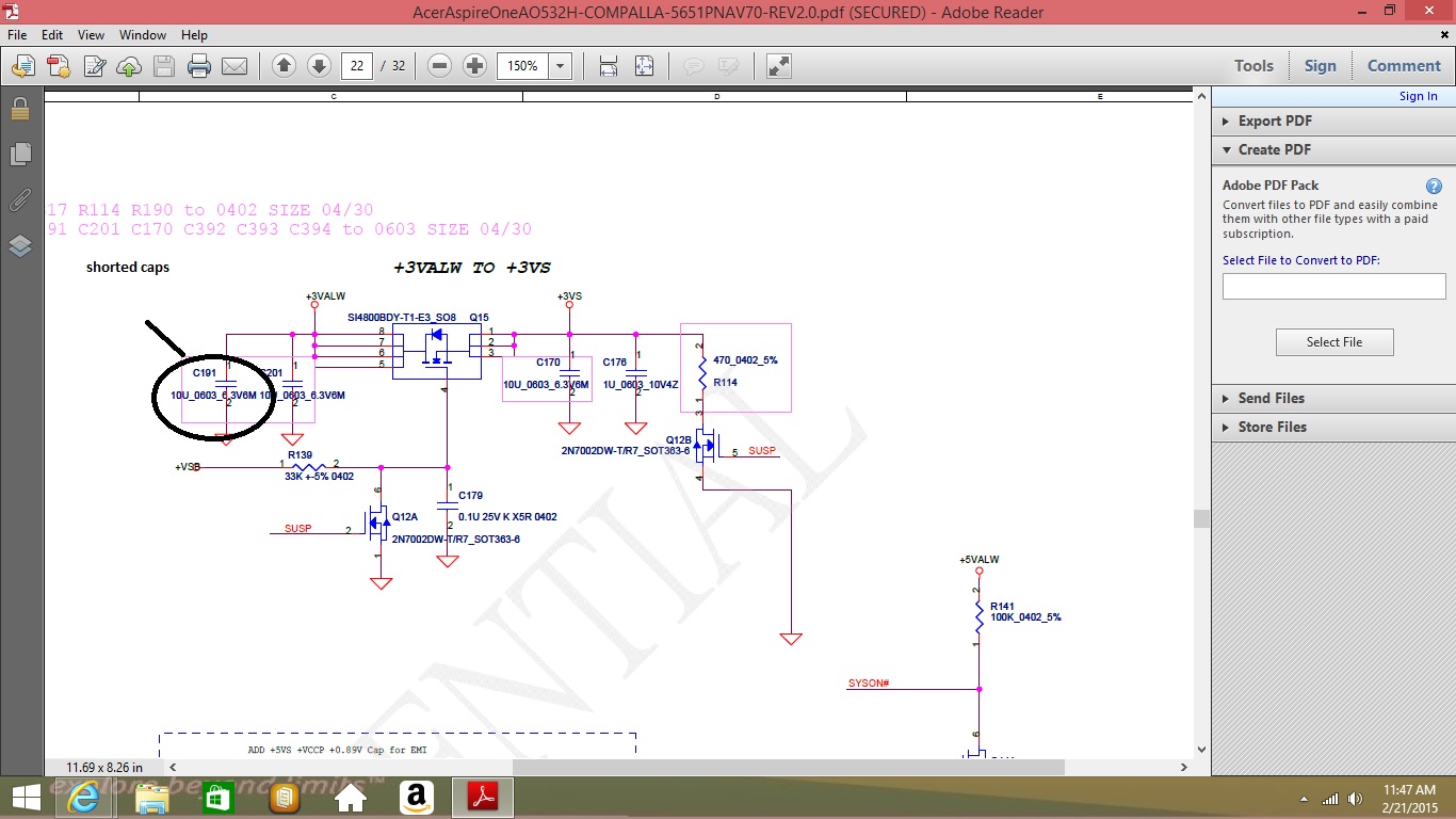

                                    i found shorted caps
