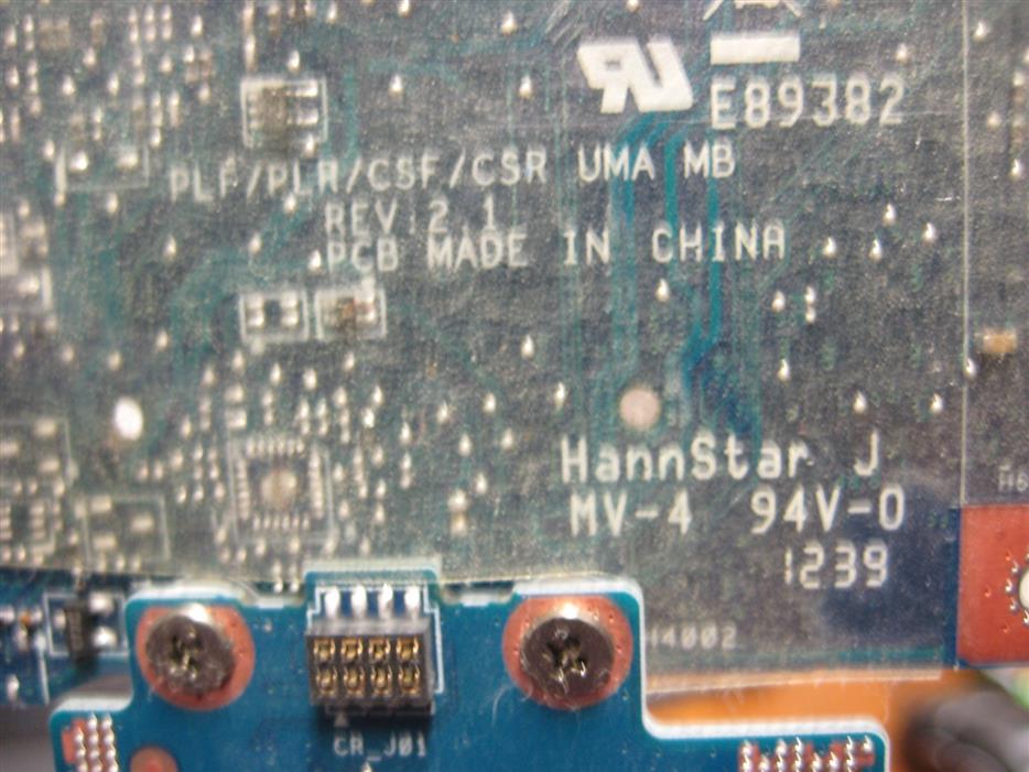

    I've got a 17" Toshiba C875-S7304 laptop. It's motherboard is a:
    Hannstar J MV-4 94V-0 :239
    E89382
    PLF/CSF/CSR UMA MB

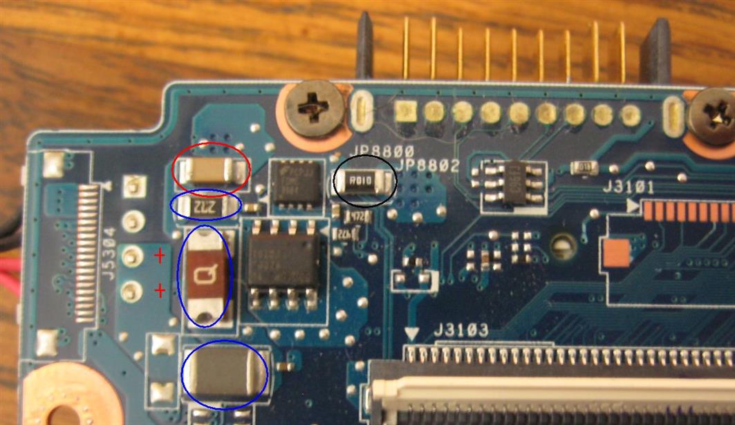

    If I place a good battery into the unit, it will run on the battery. With a dead battery, or no battery, the DC line-in will not power the unit at all. No neon lights, nothing. Oddly, though, when I place a charged battery into the machine, with the DC-in line attached, the orange charging light comes on.
    I tested the voltage and found that the laptop's external remote DC jack is delivering full voltage to the MB DC input jack. My guess is that something on the MB prevents that voltage from reaching and charging the battery. Perhaps a blown fuse.

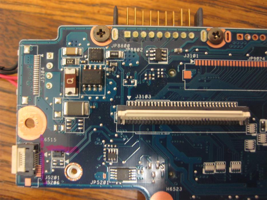

    No idea how to proceed, or if I should try. I'm going to attach some board shots.

      please check this mosfet,i find it shorted a lot of times
        Re: Toshiba C875 runs on battery but not adapter

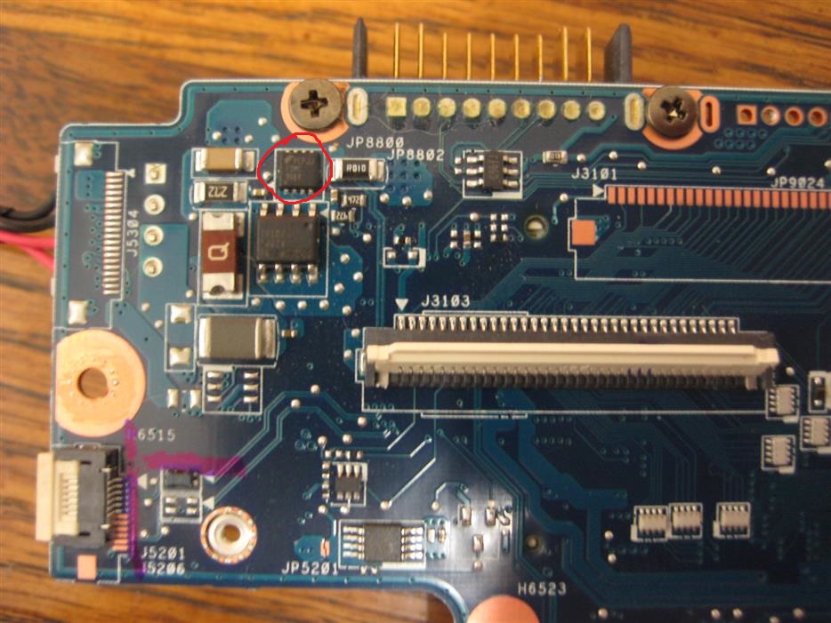

        Thanks, I don't see anything visually wrong with that element, and don't know what further to do about it.
        I did probe around. In the attached photo, the element circled in red attracted my attention. Is it a fuse? Because my theory is that a power surge burned out the adapter input circuit.
        All the elements circled in blue had +19 volts at both ends. The element in red had 19v at its end near the power block, and 0v at its other end. The element circled in black registered 0v.
        I shorted across the element in red while the adapter was plugged in, with no battery, and got a spark.
          no it`s not fuse,it`s capacitor,you have probably made more damge now... element marked with Q is fuse...and you can`t just short elements by filing...
          Mosfet i marked was probably your problem,now you should check all components on the picture...
