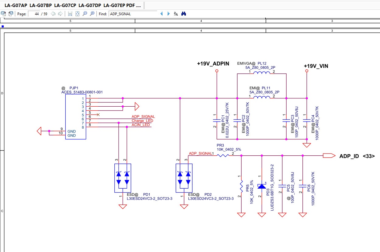

    I could not find any schematic or boardview, but I traced the adapter center pin signal (called AD_ID in other HP laptops) and the voltages look correct :
    - with 65W adapter : 1,13V on adapter connector ; 0,57V on pin 75 of EC
    - with 45W adapter : 0,76V on adapter connector ; 0,38V on pin 75 of EC
    Doing the math considering the resistor in the adapters and the resistors on MB the values are correct.

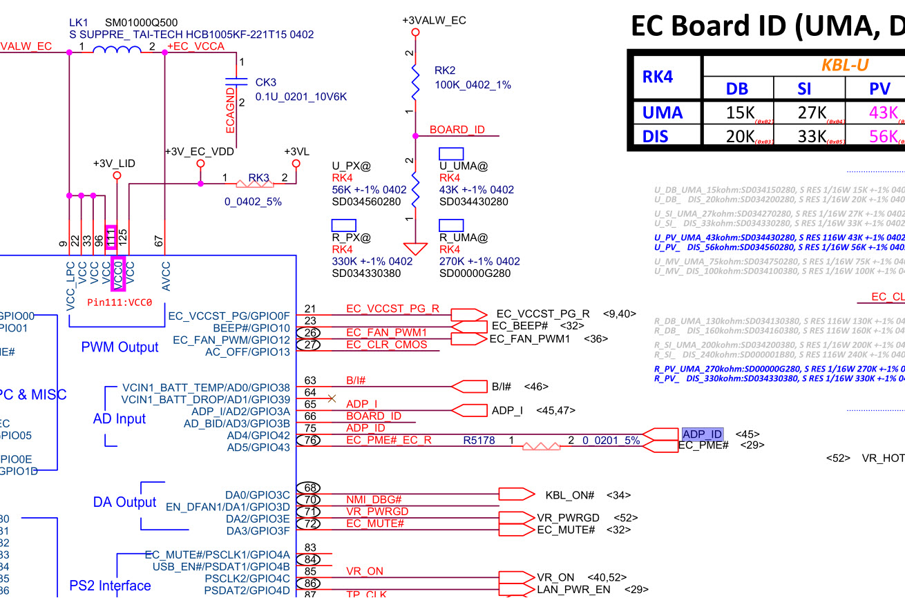

    It looks as EC input for AD_ID signal is not working, but before replacing it (this is the only problem I have with this laptop) I would ask your advice if there is anything else to check or a possible workaround to the problem.

    Re: HP 250 G7 runs slow and battery charge is disabled when adapter is inserted
    See attached.
    Suggestion...rig the resistor based voltage divider to make the POS work properly. Ghetto-ware(tm).
          Originally posted by mon2
          See attached.
          Thanks Mon2, I will give it a try to play with resistors to send a voltage up to 3V to the ADP_ID pin of the EC and see if it triggers it.
          BTW it looks you have schematics of the MB and there are other adapter related pins on EC like ADP_I I may check. Would it be possible to have schematics/boardview? Thanks
              I did a few tests changing resistor values to modify ADP_ID line in several steps from 0,38V to 2,8V, but nothing changed. When the adapter is inserted the CPU clock is limited to 0,4MHz, while when running on battery it goes up to more than 3MHz.
              I also tried to run on AC adapter only, disconnecting the battery, which of course caused a CMOS checksum error, but CPU clock is still limited.
              It's for sure a HW/FW problem because even the memory test run from BIOS is much slower when adapter is in.
              I will try checking ADP_I , ACDET , ACOK lines, but I am running out of ideas and I am very reluctant to change the EC just for this stupid problem.
              Any suggestion on possible solutions/workaround?
                It sounds like the bad news that the A/D (analog to digital converter) is not working or is defective on the EC. Confirm the voltage from this ID pin with the resistor voltage dividers is reaching the target EC pin.
                Other than this, does this EC feature a BIOS ? Reflash it. Then only the replacement is the next option.

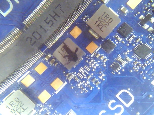

                      the chip is aopm 161 or aqpm 161 i dont know > it gitting very hot >
                      what is the alternative ?
                      • audrimars
                        • Apr 2020
                        • 48
                        • palestine
                        behind the coil power supply (under the ssd m.2)

                          Post a clear picture of the part.
                          • audrimars
                            • Apr 2020
                            • 48
                            • palestine
                            thats what i did. photos
                            • mon2
                              • Dec 2019
                              • 14698
                              Part appears to be from MPS and your markings of 'AOP' should be used in the hunt but so far, unable to locate it.
                              Post the silk markings for this part on the pcb. What other parts are nearby? We may be able to locate this one by reference. The logic board is the same as this thread?
                                this
                                • audrimars
                                  • Apr 2020
                                  • 48
                                  • palestine
                                  I still thought mosfet(dual)
                                  • audrimars
                                    • Apr 2020
                                    • 48
                                    • palestine
                                    but its strang
