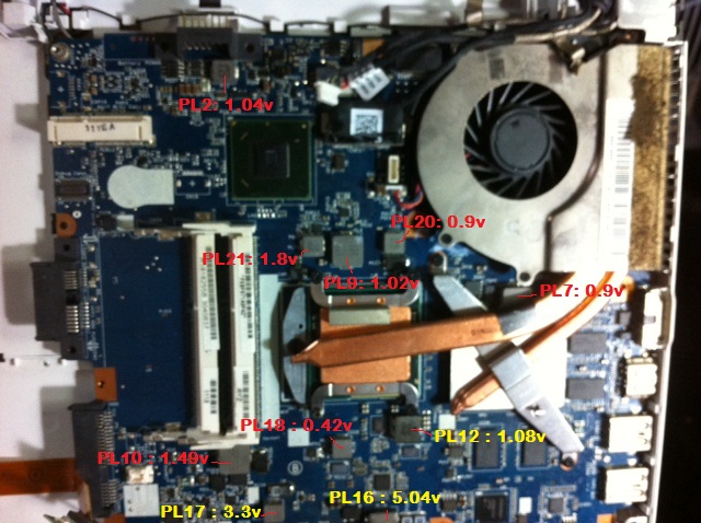

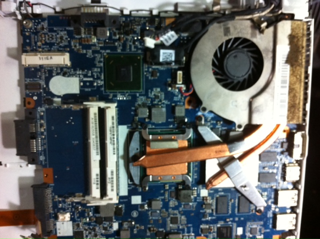

    SONY VAIO VPCCA15FG

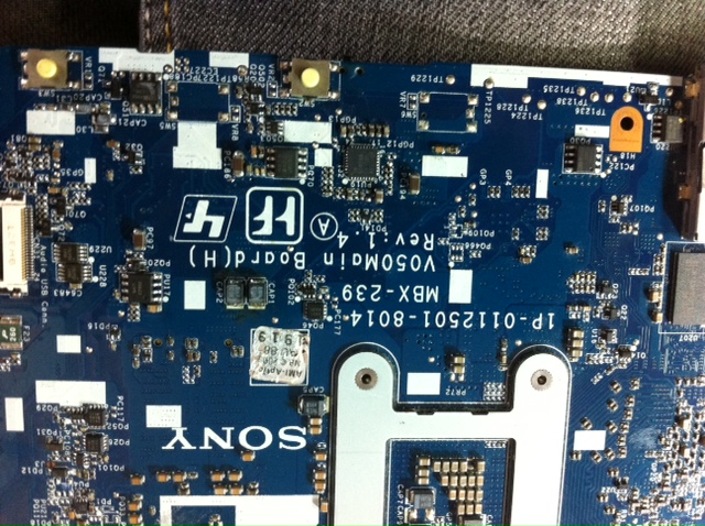

    M/B : MBX-239 ( See attachment )
    Bios : See Attachment
    Test power on with lcd only and MB + Heatsink Fan ( no hdd etc ) DOS mode only, it will shutdown randomly at 1 or 2 minutes, it can power up again just for 1 or 2 minutes, just like that. HM65 Chips and PL16 get hot when we touch it's about 45'C measure with my DMM.

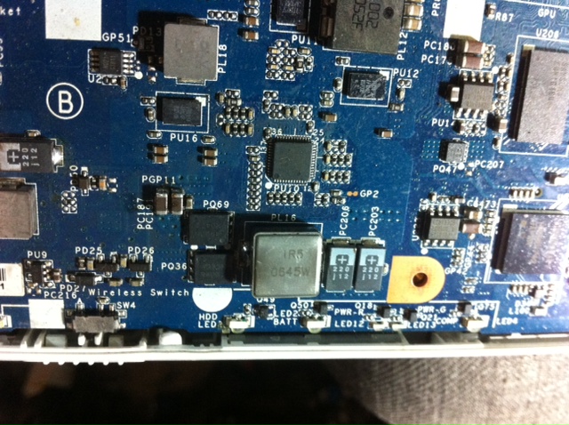

    1. Change PL16... Done
    2. Reball HM65... Done
    3. Change CPU... Done
    Any suggestion on this case ? I don't have shematic or couldn't find till now and bios dump file too. I've attach original bios with pic of MB
    Best Regards

    Re: SONY VAIO VPCCA15FG Shutdown randomly in 1 or 2 minutes..
    Here is a different bios to test with ....if works i will fix me region meaning put a clean un used one. If still does the same thing see what voltage is falling out .... most likely core voltage .. alwon 3/5 should be present with just adapter plug in and not pressing power button..test point big square coils they should be the only one's with power with just adapter in. nexted CLK circuit 32.768 at crystal ? you could always check resistance in both circuit with no power to board and set meter to diode mode red probe on ground and black on +line .. also could be crack heat pipe ...have you tried one stick of memory in each slot one at a time? if one socket is bad just double up on good one. hope this helps

      Thk's for your respond Techman..
      Flashing bios with your file still does same, alwon 3/5 present for 20 seconds and missing alias no 3/5 after that ( but I still can power on even 3/5v missing on that coils ), here is I attach measurement on each coil
        Hi
        Ok what i need to know with just adapter in don't press power button. is the 3/5 stay there? it don't turn off ? also clk signal there 32.768 ? did you try a different power adapter maybe your's can't handle load? you could also check this by putting a dc 24V bus bulb as the load see if it stay's on.
        if yes i say no clk single ?. Maybe also I say the SN608098 is dead(RT8206A/B=ISL6237=PM6686=SN0608098)

          Hi...Thanks for you replay Techman,
          Stay there for 20nd's
          Dunno how to test it but I do have Frequency Counter
          Use a Workbench PSU 5A ( with charger still does same )
          techman1025
          I'll give it tray that and let you know soon
          Regards
              "but I still can power on even 3/5v missing on that coils"
              thats not possible.
                thats not possible.
                it happen on sony vaio I've normal sony vaio missing 3/5 after 20 sec but u can still power on without problem
                  Finally Done !!
                    problem solved bro?
                      Originally posted by degutji
                      Finally Done !!
                      i think for other users it would be intressting... HOW ?
                        Originally posted by meritosari
                        problem solved bro?
                        Just put everything back and give it back to customer while saying this " Sorry can't help you, I give up " ( this sony have been 1 month in my table )
