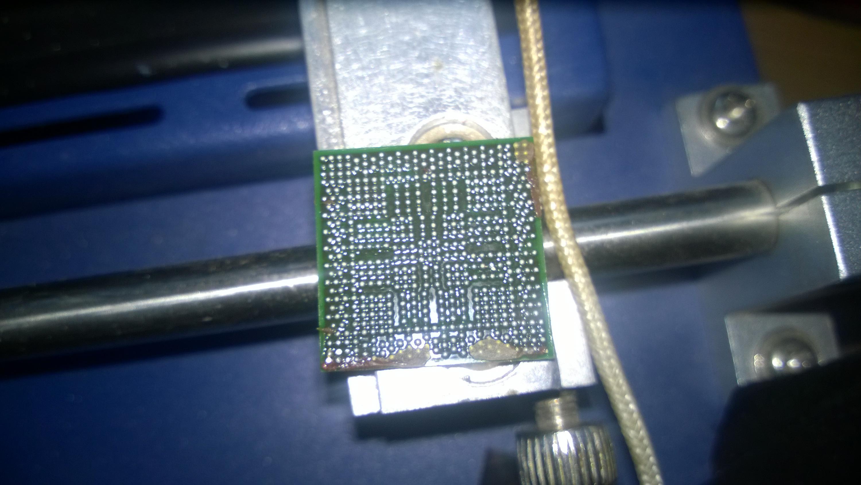

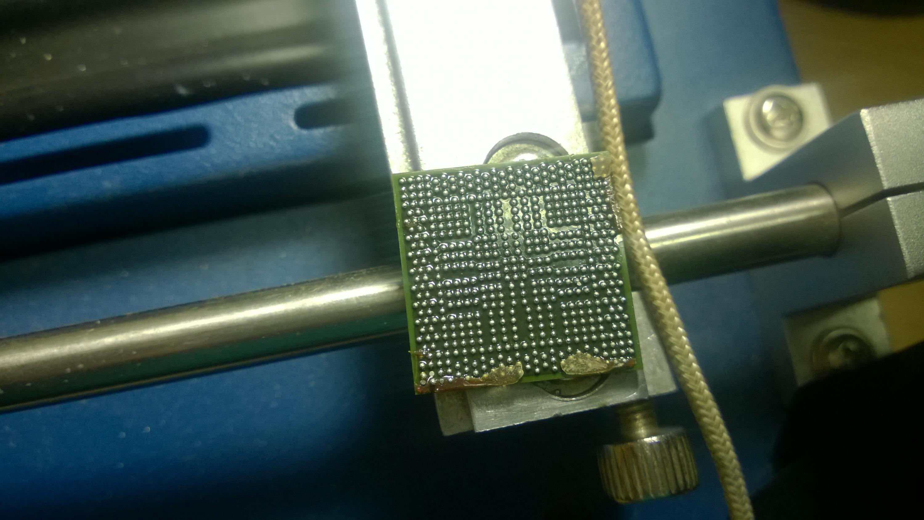

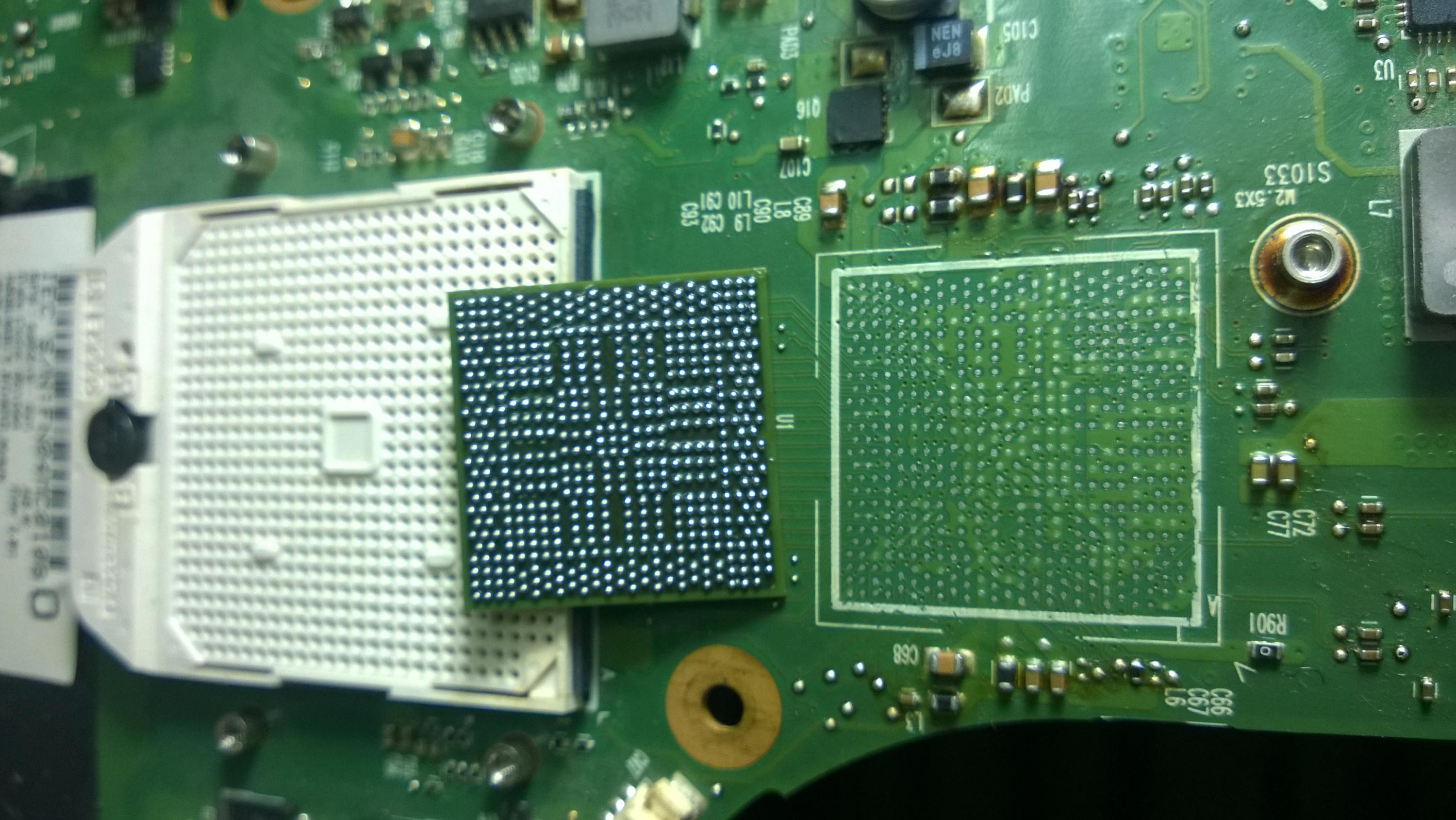

    Had time yesterday and finished one HP probook 4515s.
    Few pics atached the 1st two are after the lift, the 3th is before placing.
    (the red epoxy was the "devil" which stoped this laptop to run, reflow didn't help of course ).
    All in all, the laptop is currently running and under tests .

        Hard to believe that epoxy glue was a culprit. What a great job, congrats.
