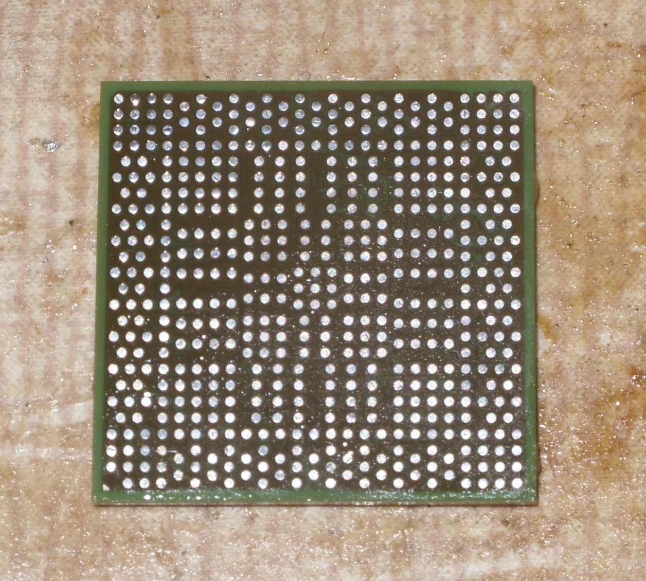

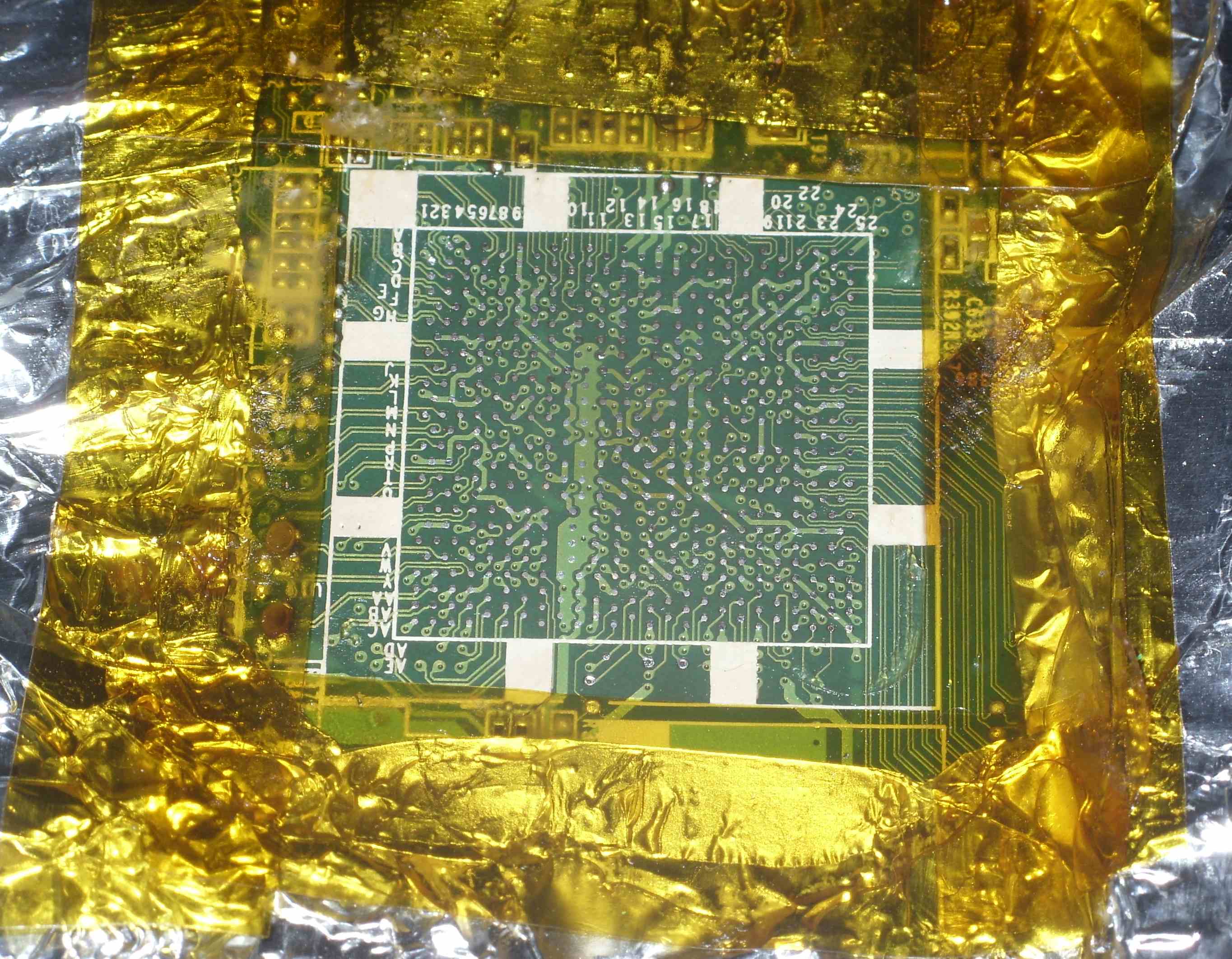

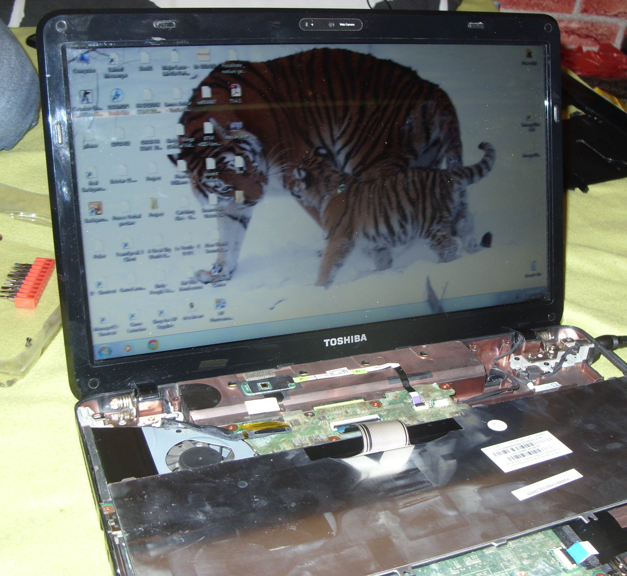

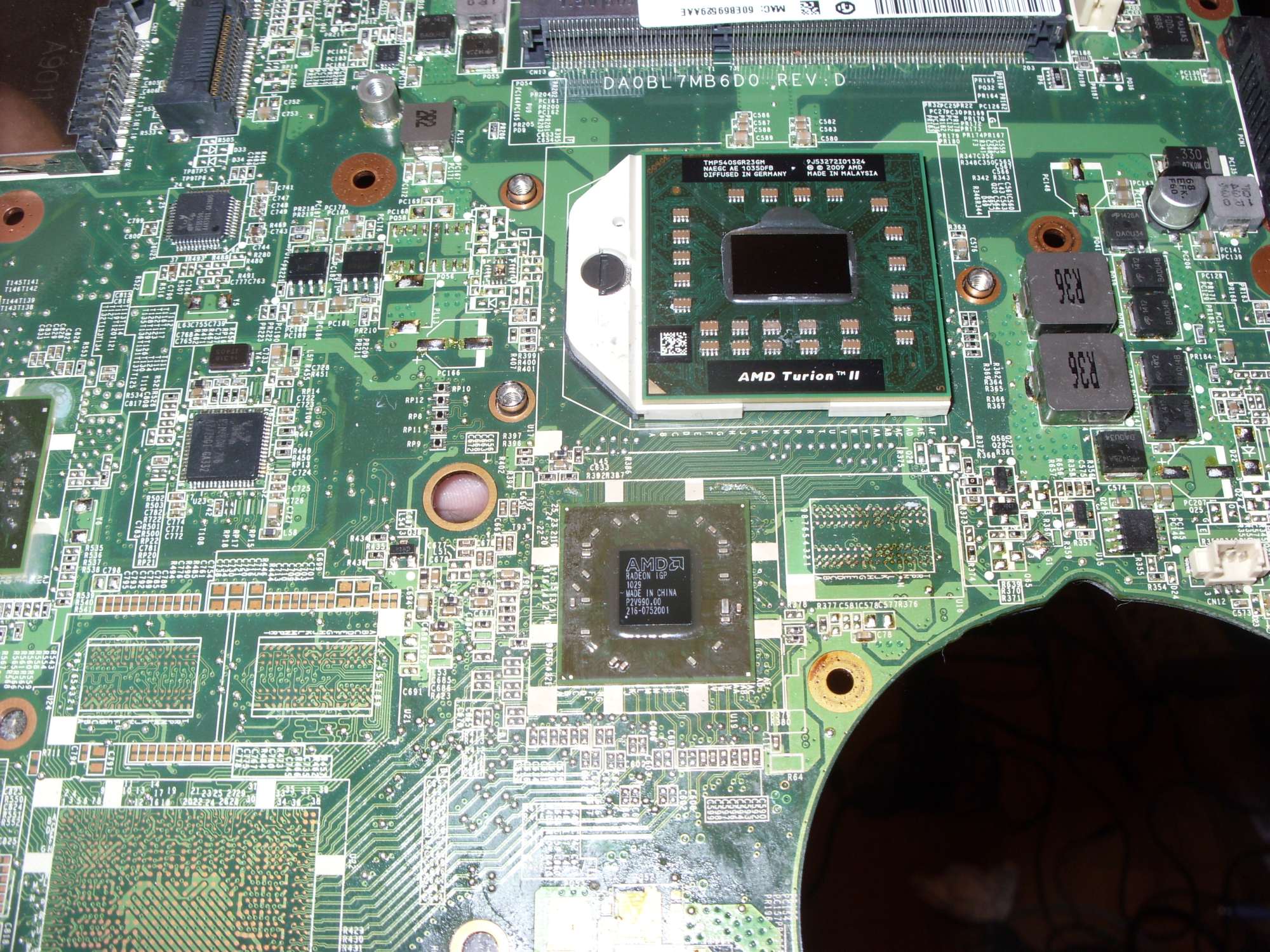

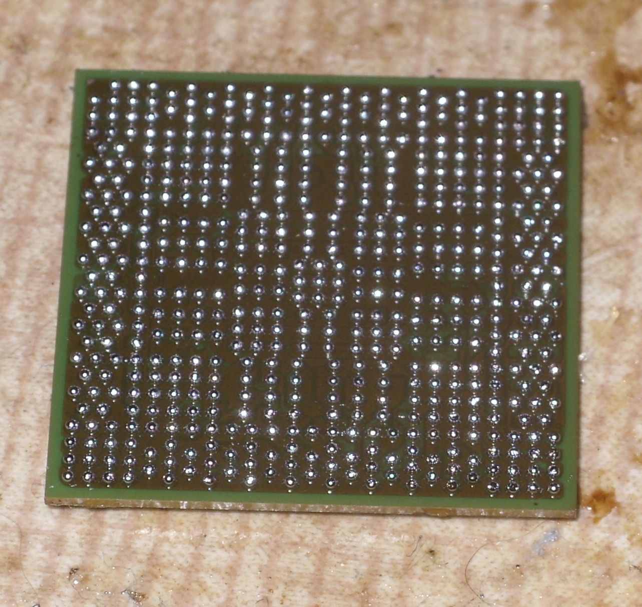

    Got asked about this one, no video on either internal or external, and no signs of attempting to boot. Googled it a bit and noticed "HD4250 Graphics". Our old friend the RS880M. Told the guy the price for reballing, he agreed, and he brought it in.
    I was happy to see that Quanta did the board, and that it's green. I've always found green boards to be nicer to work on than any other color. Better quality solder mask, and they don't discolor when subject to heat (like reballing).
    However, upon lifting the chip, it was nasty under there. These have gotta be the smallest pads i've seen for this chipset so far. Along with that oddly placed power trace, this made the board a PITA to clean from the old solder.
    I actually thought i damaged a few pads, but i looked closer and they were just "too clean" (all the solder came off). So i went thru with the whole process. Thankfully, all went fine, but i hope i don't see another one of these anytime soon.

    i'm really glad to hear that, good job friend, very nice to get this result i know it's very hard to get it. thank you for posting this,

            Thanks. There's nothing to like about this board, it's ugly. Well, maybe the solder mask. As you can see it didn't get a single scratch. But other than that, it was harder than usual.
            Btw, notice that on the unpopulated component pads they did not even add solder anymore. They went to the extent of making a special solder paste stencil for the integrated graphics version, to save on solder... interesting. I know i've seen this before, but i don't recall which board. Either way, it is unusual.

                            It barely takes any time at all. Either way, if you manage to balance the heat so that the underside of the board doesn't get cooked, either, more power to you.
                            I've noticed that blue boards always get discolored. Others less so. Green boards, hardly, if at all. Black ones... Well, they're black to start with.
