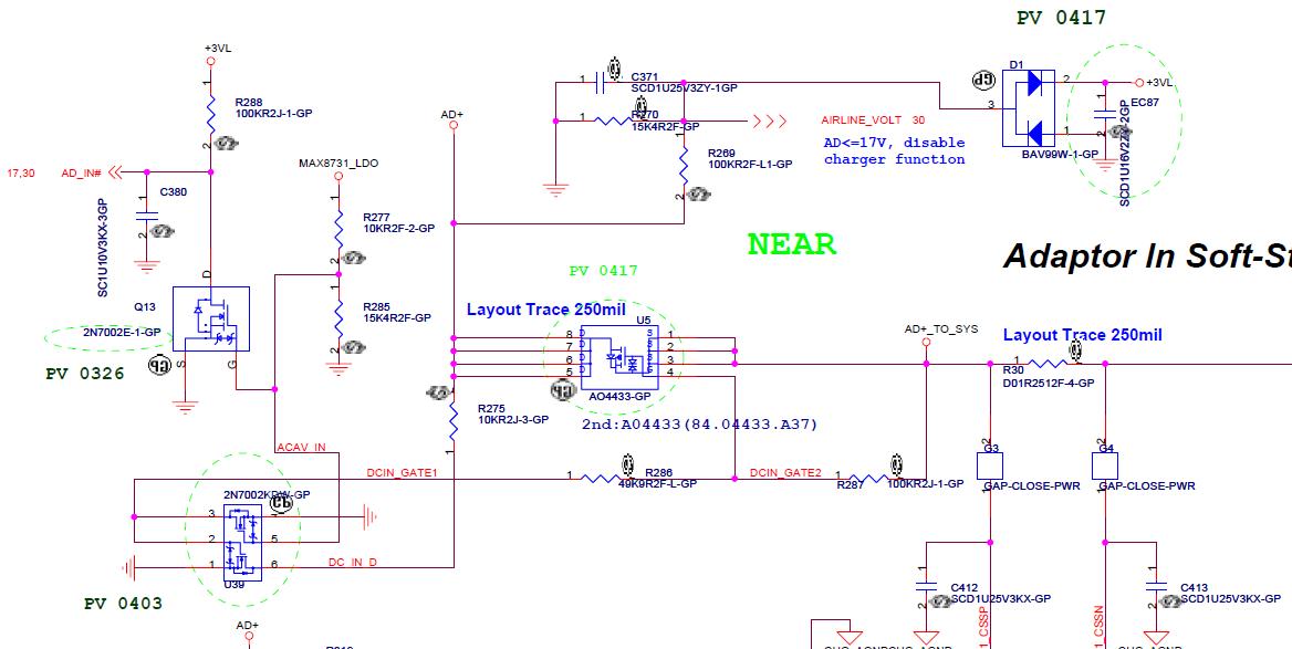

    No reaction when i press the PWRBTN
    HP CQ60-410SV
    WISTRON ASTROSPHERE
    07241-5
    KBC: WPCE773LA0DG
    1.3ALW, 5ALW presented
    2. PWR_BTN# = 0
    3. AVCC,VCC = 3.36V
    4. PM_RSMRST# = 0
    5. LID_CLOSE# = 3.3
    6. AD_IN# = 3.36
    7. X1,X3 = 32.76Khz
    8. PWR_BT# = 0
    When i start the measurements the PWR_BT# and AD_IN was 0 then I desolder the Q13 and the AD_IN came to 3.3V.
    KBC faulty or something else?

    some new measurements
    2. PWR_BTN# = 0,8V
    3. AVCC,VCC = 3.36V
    4. PM_RSMRST# = 3.3V
    5. LID_CLOSE# = 3.3
    6. AD_IN# = 0V
    7. X1,X3 = 32.76Khz
    I don't know what happened but some times i have 3.3V at PWR_BTN and start up (fully functional) and then shut down with PWR_BTN dropping at 0,8 -0,7V.

      look for corrosion or cold-solder. You can try to flash the bios with newer version.
