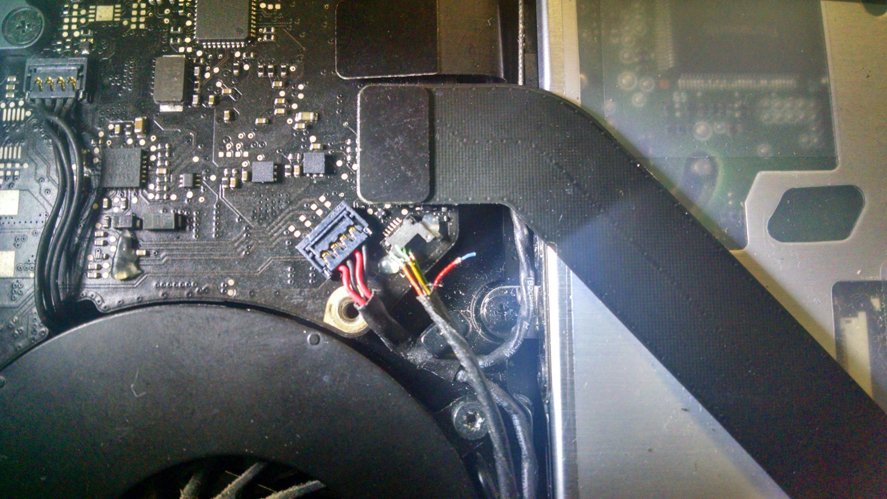

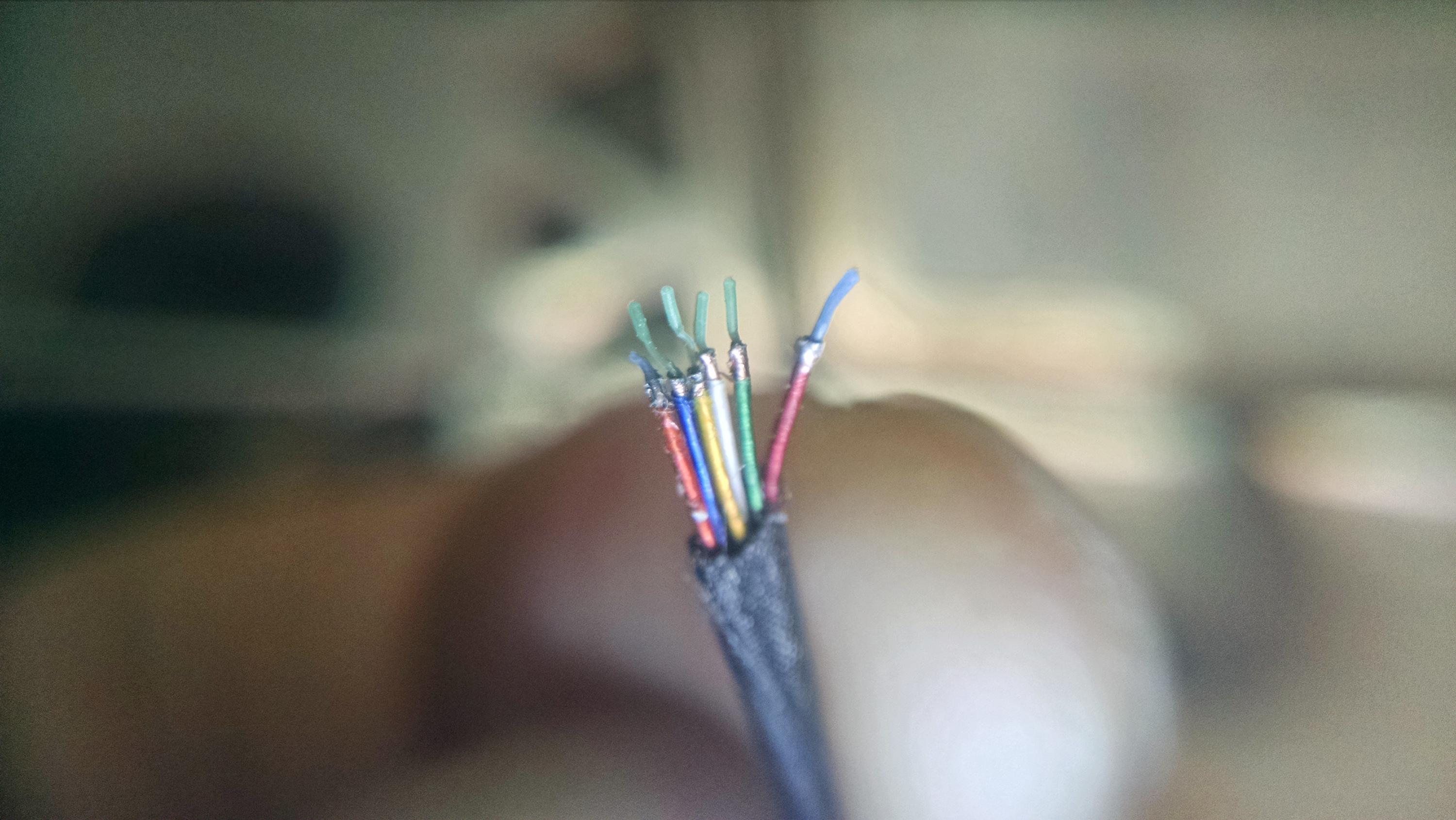

    Help with identifying a broken camera connector
    Help! Connector got broken down!
    It's an A1278 (MacBook Pro).
    With boardview, the pinouts are:
    1: GND
    2: USB_CAMERA_CNN_N
    3: USB_CAMERA_CNN_P
    4: SMBUS_SMC_A_S3_SDA
    5: SMBUS_SMC_A_S3_SCL
    6: PP5V_S3_ALSCAMERA_F
    I attached the photos. I need help identifying which colors belong to which.
