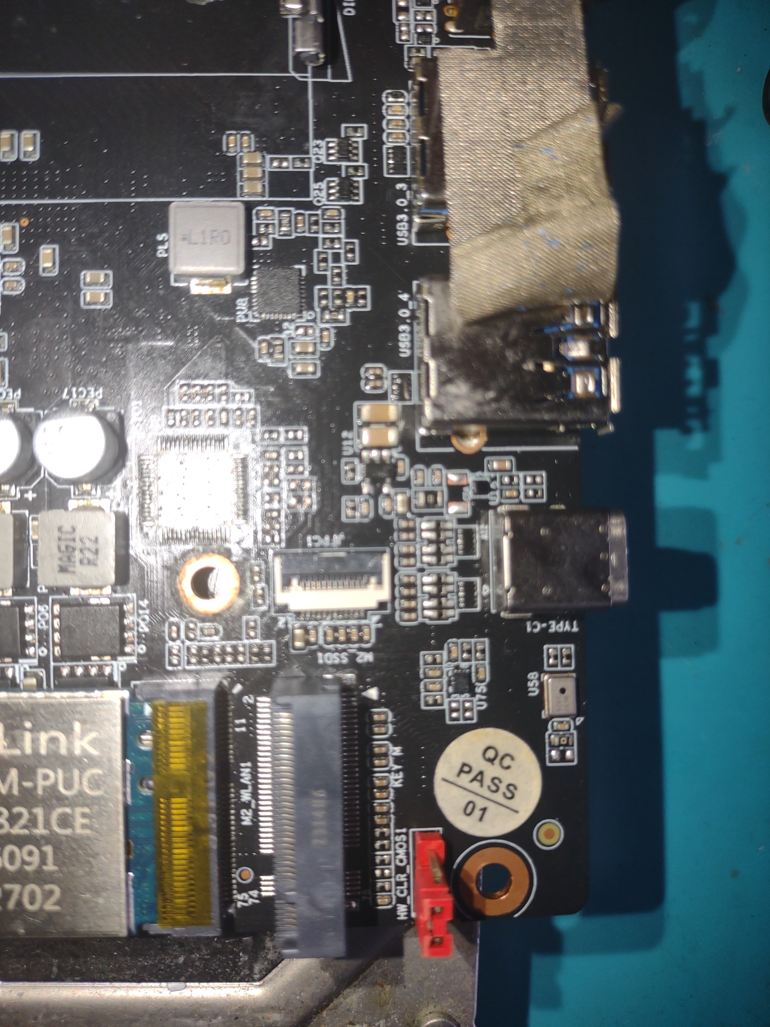

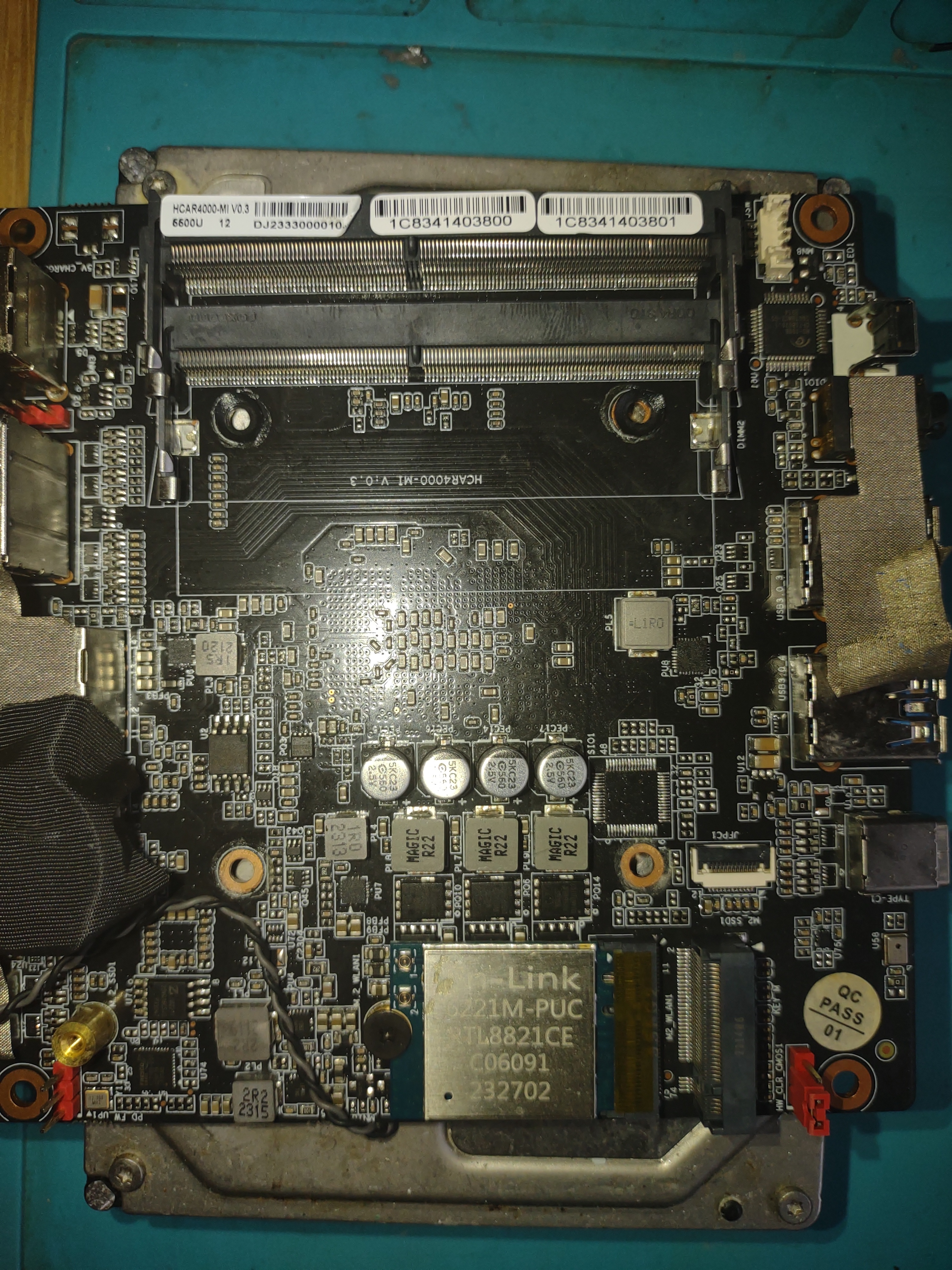

    I’m troubleshooting a Nipogi AM06 Pro mini PC (5500U model, also sold as the Acemagic AM06 Pro). The unit generally operates without issues, but the front-facing Type-C port fails to deliver power to any connected peripheral.
    I purchased the system new, so I can’t confirm whether this port was functional at any point. It’s possible the port was miswired during manufacturing. Notably, I did once inadvertently connect the Type-C power adapter to this port, which could have resulted in electrical damage.

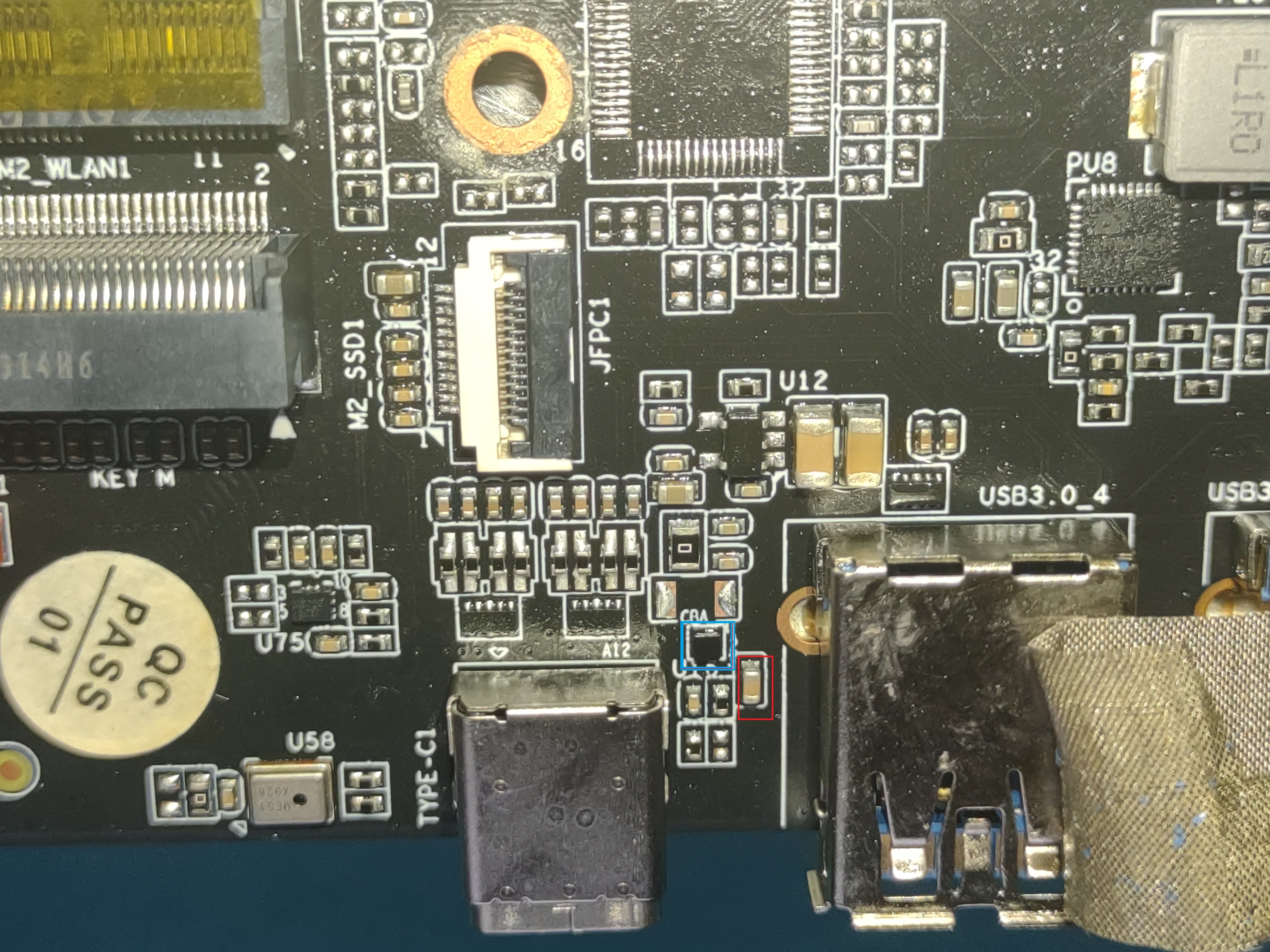

    To investigate further, I disassembled the device. My experience includes multiple previous hardware repairs, so I felt comfortable proceeding. I traced the Type-C connector’s voltage pin to a capacitor highlighted in red and to a suspicious component in blue (possibly a diode), both visible in the attached image. The Type-C connector itself appears at the bottom center of the photo. At this stage, I’ve been unable to trace the voltage pin any further downstream from the port.
    Click image for larger version  Name:	ACEIMG_20251030_133401361.jpg Views:	0 Size:	2.48 MB ID:	3755307

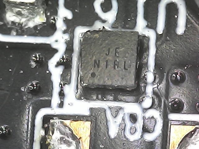

    I got out my cheapo microscope to have a closer look at the mystery component, outlined in blue . The text looks like JF N1FL or JF N1FL or something similar . My educated guess is this is at fault . However I have not yet identified it .
    Click image for larger version  Name:	mystery component.jpg Views:	0 Size:	246.4 KB ID:	3755308

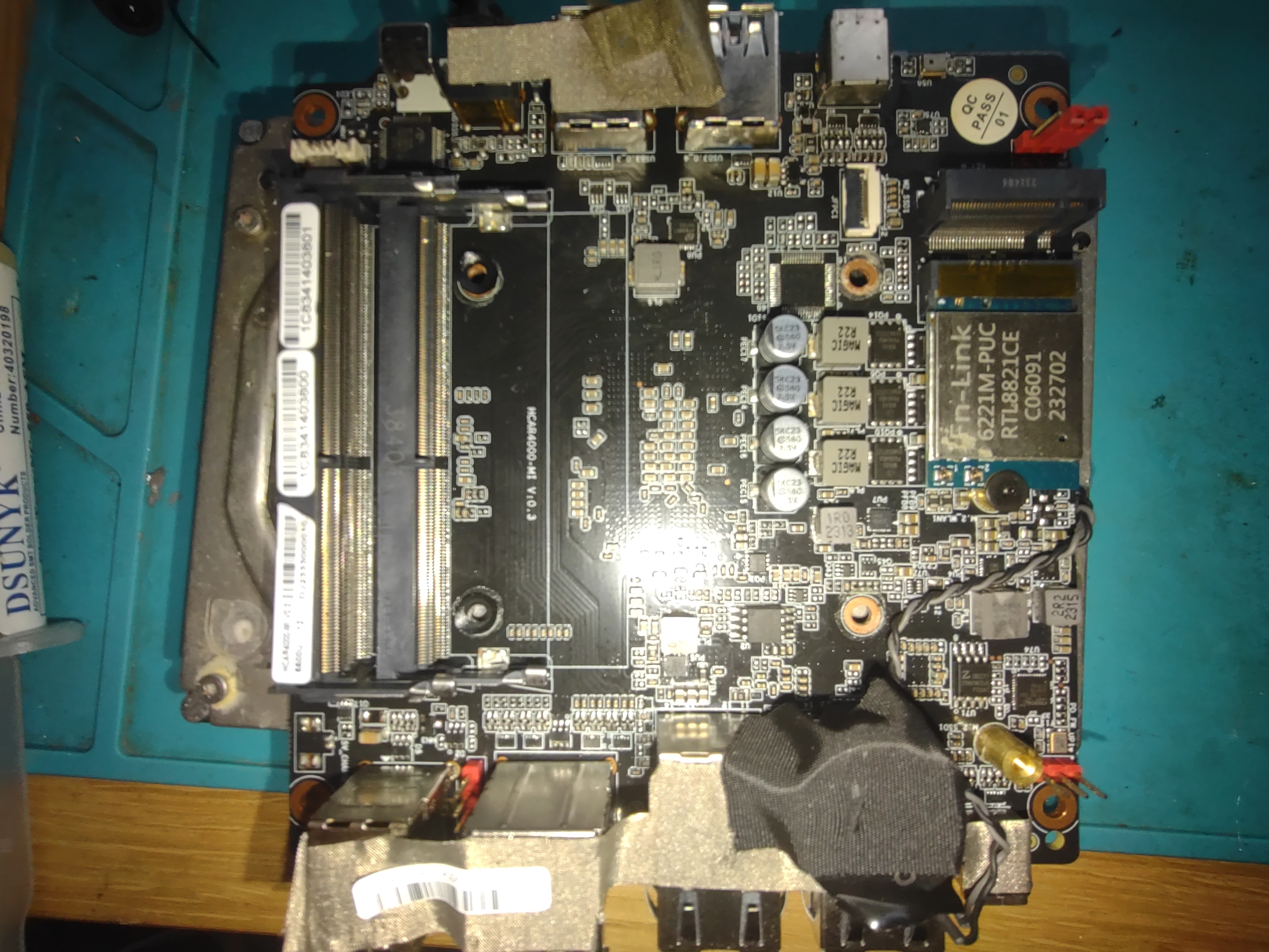

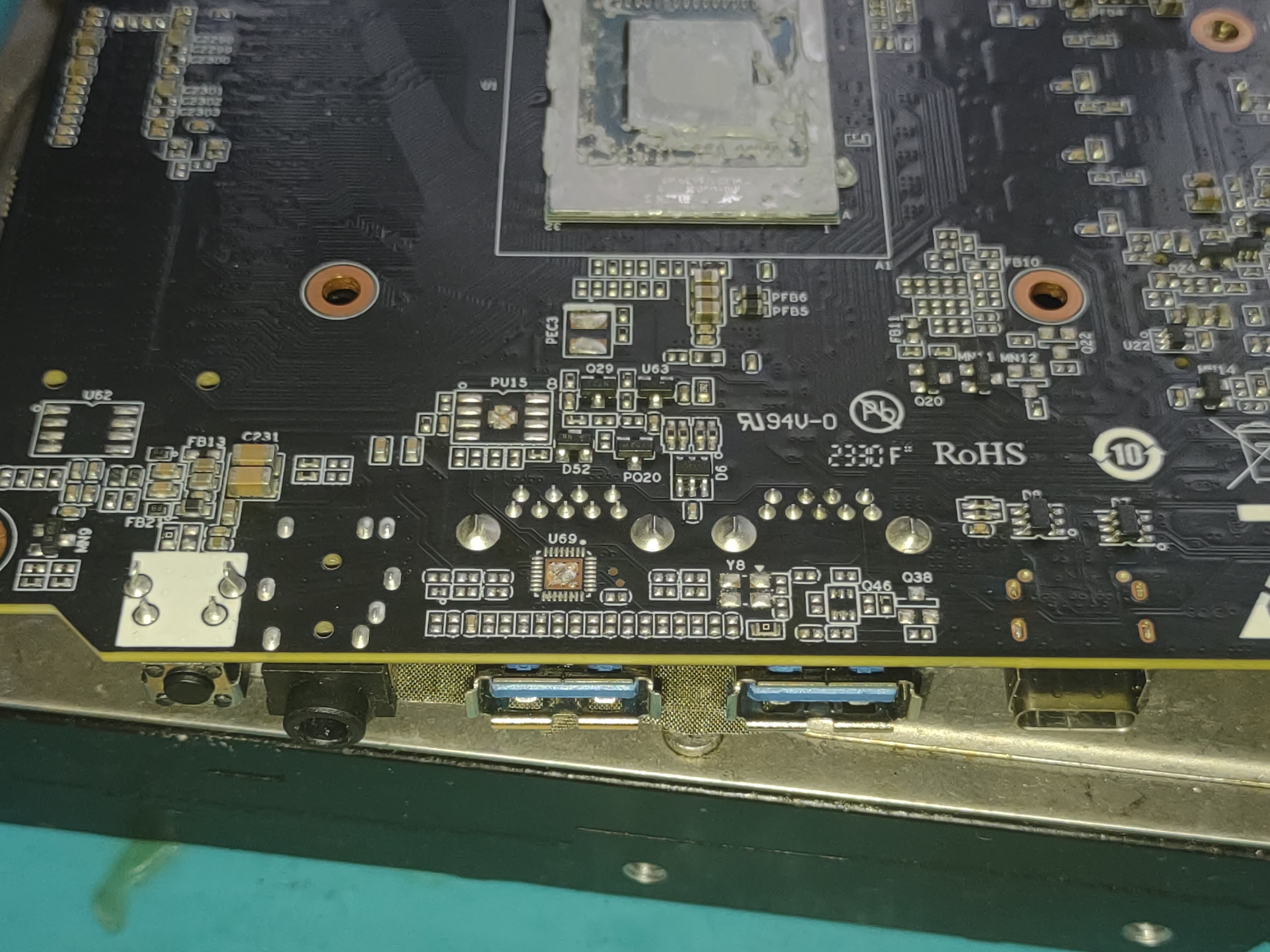

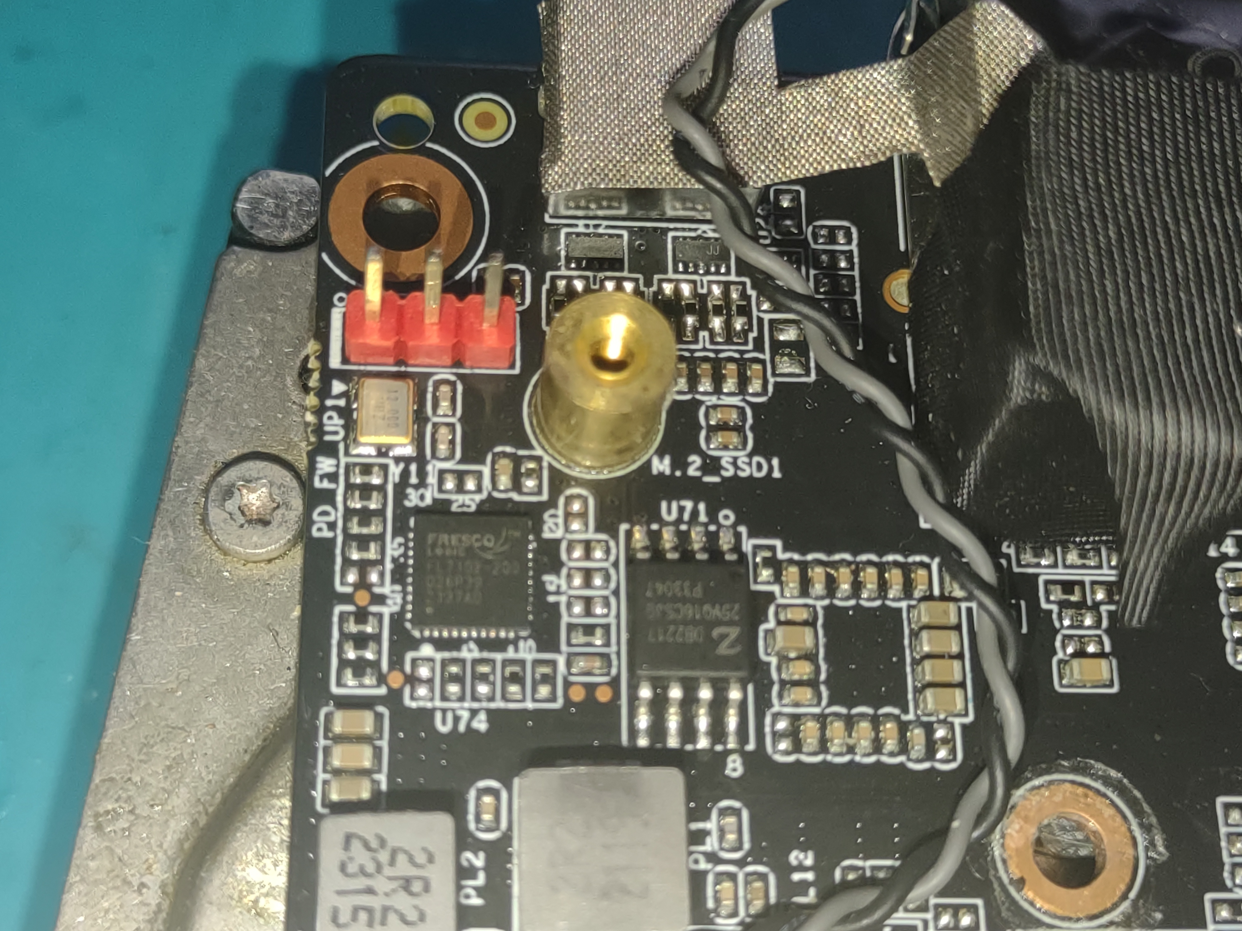

    Below are more pictures of the board inside this device
    If anyone has schematics for this board or insights regarding typical failure modes for these Type-C power circuits, I’d appreciate your input.
    Click image for larger version  Name:	IMG_20251030_133027717.jpg Views:	0 Size:	2.52 MB ID:	3755309
    Click image for larger version  Name:	IMG_20251030_133419873.jpg Views:	0 Size:	2.40 MB ID:	3755314
    Click image for larger version  Name:	IMG_20251030_133430693.jpg Views:	0 Size:	2.41 MB ID:	3755311
    Click image for larger version  Name:	IMG_20251030_133356665.jpg Views:	0 Size:	2.82 MB ID:	3755312
