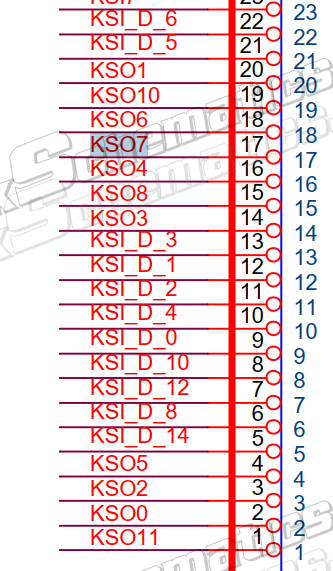

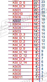

    Hi Guys,
    I have this board that is not reacting to power button and not charging the battery. Every standby rail is up and running (3.3v 5v, 1.8V), lid sw and all the rest ok but "RSMRST" is never gets high and no short on the board. I suspect the EC but I cannot get to it with my programmer.
    Can anybody take a look at my made up config:
    da0x8imb8e0 KB_pins=42 LEFT DOWN 05MM FLASH=256 JENK=17 TCK=2 TMS=20 TDI=3 TDO=14 CHIP=NPCX797HA0BX
    Maybe i have missed something.
