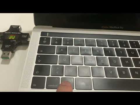

A1989 820-00850
  • pascable
    • Feb 2018
    • 41
    • France
    A1989 820-00850
    Dear friends,
    Below is the link to my YouTube video.
    I have an A1989, 820-00850, which has 20 volts, its amperage, and which boots up without displaying anything on the screen unless I press the "Option" key.
    External drives can be seen if they are connected, but I can't access them.
    I can't do anything except that.
    I don't have your knowledge to resolve this problem, if a solution exists.
    Can you help me please?
    Sincerely, Pascal
    https://youtu.be/LtVKceAksyM
  • gugutm
    a1989 820-00850 stuck at 5v 0.041a Help
    by gugutm
    I'm new to the forum,sorry english is not my first language too, i got a basic plus knowledge, but now i am in this situation where i need some help , i spend good few days reading forums , here and outside , to help my problem solve, with no luck
    long story short, i bought macbook pro a1989 820-00850, clean no water damage which was stuck on 5v 0.200/300a i read a lot of forums what that could be , it indicated to faulty corrupted t2 rom
    of course before jumping to conclusion and connected to DFU , i believe i done basic checks...
    01-04-2025, 09:35 AM
  • tommy97
    MacBook A1989 No power
    by tommy97
    I’m having an issue with an A1989 board after water damage, it’s stuck at 5V 0.20A. I’ve checked the measurements, and all readings are the same across all four CD3215 chips. I replaced them one by one (using chips from a donor board), but nothing has changed.
    I don’t need a fully functional board, as the repair is only for data recovery purposes.
    • PP3V3_G3H: 3.3V
    • PPBUS_G3H: 12.26V
    • PP20V_USBC_XB_VBUS 5V
    • PP3V3_UPC_XB_LDO 3.3v
    • PP1V8_UPC_XB_LDOA 1.8V
    • PP1V8_UPC_XB_LDOD 1.8V
    • PP1V1_UPC_XB_LDO_BMC 1.1V
    Can the A1989 work with just one master CD3215? What would...
    10-16-2025, 01:57 PM
  • obelix24
    A1989 - replace SSD
    by obelix24
    I have one A1989 that have not internal LCD (there was water damage on LCD connector) but macbook itself was working fine.
    After some time it stoped working and starts in Recovery mode. When i try to restore in DFU it always fails with error : AMRestoreErrorDomain error 75 - Failed to handle message type StatusMsg (Missing data volume))
    Is it possible to just swap SSD from some other macbook ? (or it have some dependecies ? A1989 only, some special possition from donor to correct possition on my macbook ? or i can take any SSD chips from any other macbook (with T2) and put...
    05-11-2025, 01:53 PM
  • ErinV
    MacBook Pro A1989 820-00850-A not powering on
    by ErinV
    Hey everyone!
    I have a MacBook Pro A1989 with a 820-00850-A board that recently stopped working. I used it overnight to charge my phone, in the morning it didn't turn on, I assumed flat battery but now won't charge and doesn't start at all.
    I have fully dissassembled it, when disconnected the battery reads at 0.012V. Even with the battery disconnected the laptop doesn't boot.
    The diode voltages around all 4 CD3215's seem fine.
    For all CD3215 (UB300, UB400, U3100 and U3200) I read just above 5V on PP20V_USBC_TA_VBUS, 3.3V on PP3V3UPC_TA_LDO, 1.8V...
    09-30-2024, 10:21 PM
  • Madoy104
    Macbook Pro A1989 - No image, working fine with external monitor
    by Madoy104
    Hi everyone,
    I have a MacBook Pro A1989 that was likely exposed to liquid. It doesn't display an image on the built-in screen, but the screen is backlit (you can't see the Apple logo or any other elements when held up to light). The laptop provides 20V and 1.5-2A, and it works fine when I use it with an external monitor. Currently, the connector for the display (J8500) is disconnected. I'm writing to ask for help in diagnosing the issue. I've heard that when the J8500 is exposed to liquid, the processor pin responsible for the display might short-circuit, and I'd like to know...
    08-15-2024, 10:01 AM
