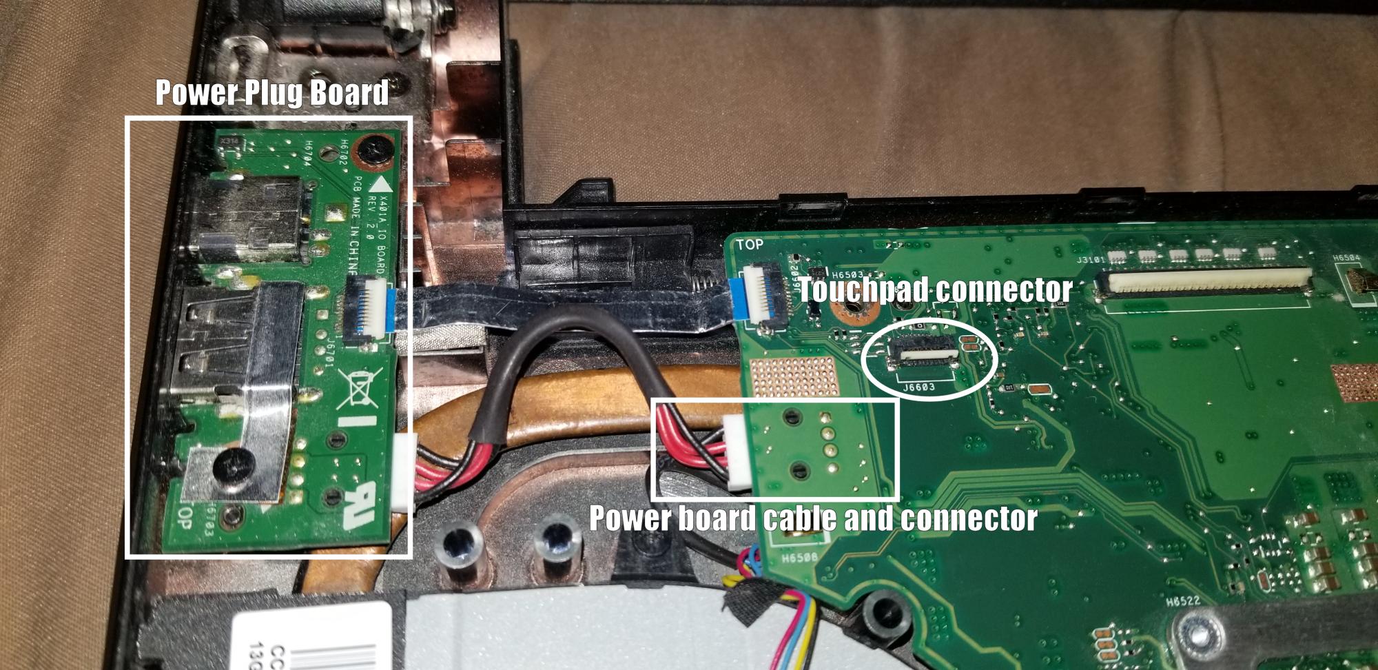

      Well i'm back, six years later. With another X401a, given to me by somebody else. A touchpad working the same way again.
      I now have more power adapters. Still the same, damn, thing.
      I can keep one finger on the touchpad completly still, and the cursor starts shaking around 2-3mm from the point
      I unplug the adapter and go on battery...works fine. Back in...starts shaking.
      Is it, just he power in the house? It was built in 2000. Wiring well grounded. No other problems with ANY other laptops or PC's i've worked on in this house
      I'm just, going insane again. Guess i'll take this to someones houes and it will work perfectly.
      can ANYONE explain this?

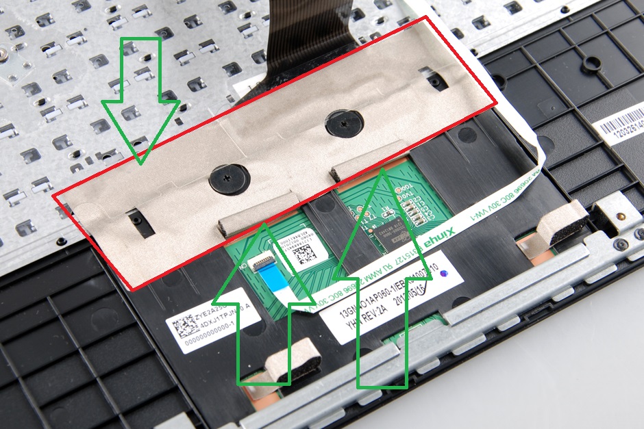

                          • c.daniel
                            • Mar 2017
                            • 108
                            • Romania
                            #33
                            Re: Asus X401A, crazy touchpad...and I now know why
                            Just another guess.
                            Do you have that sticker in place, that i surrounded with red?
                            And, can you please be sure that sticker make good contact where green arrow point.
                            Good luck.
                                          Well I did it and it was fairly successful. When I get the lid fully down, it doesn't boot. When it's loose, it does.
                                          the sticker C.daniel mentioned above is hardly staying on. I'm guessing something is shorting. I got a little adhesive and it's keeping over that loose space
                                          One thing mentioned above is that sticker being responsible for the touchpad issues. Well, I would say maybe except we forget one thing. It ONLY does it when the power is plugged in. On battery, the touchpad acts like it should. I might have traced a possibility, but have no way of fixing it, or even tracing down the specifics of the problem. Again, it does it ONLY when it's plugged in...
