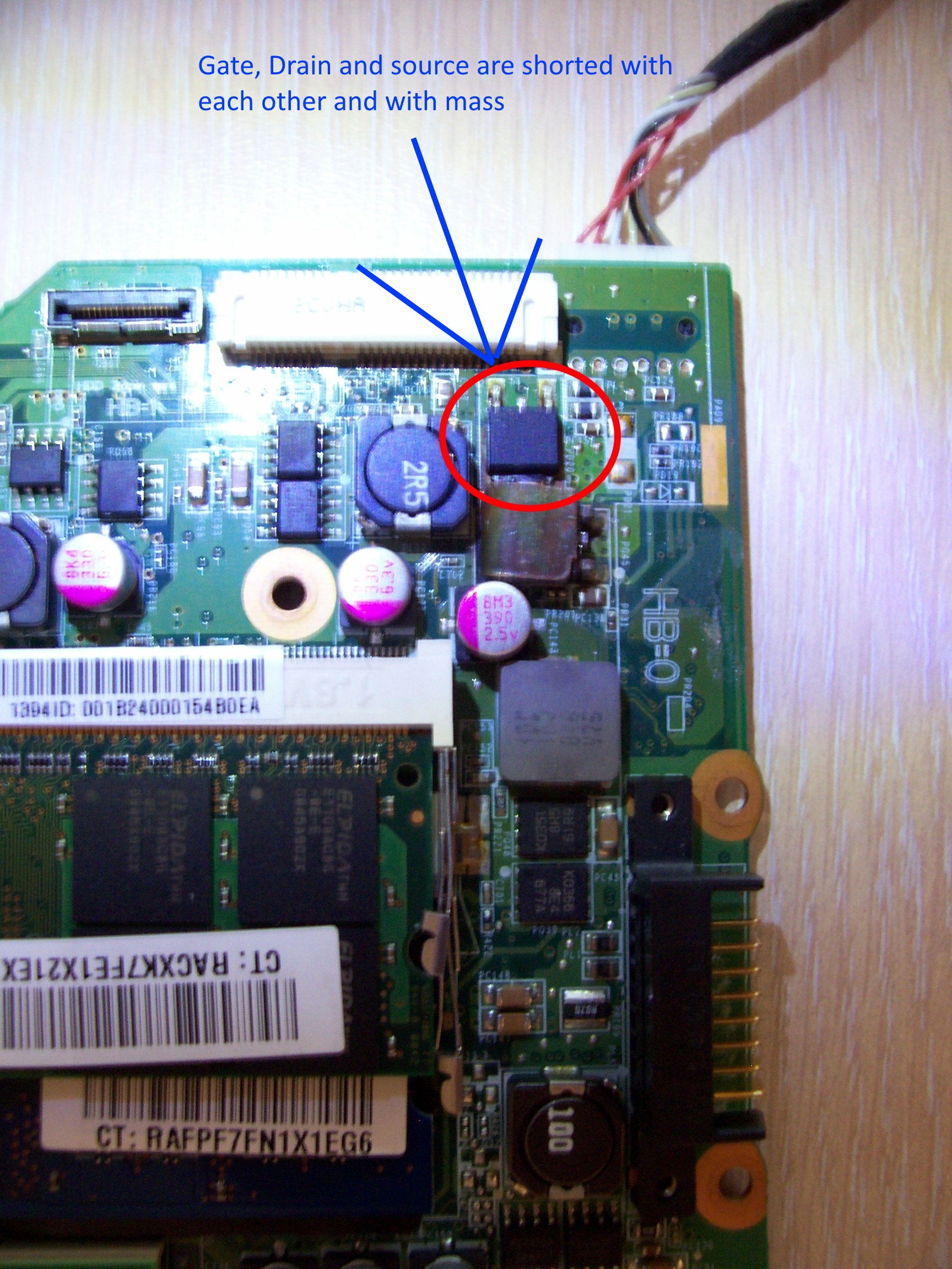

      Hello again. I have replaced the capacitor and the mosfet displayed on the picture attached above, the problem persists.
      I've found out something new though : On the attachment below, the highlighted mosfet is shorted with mass ( PCB Ground ). Is this normal or this presents a further investigation and or replacing of the highlighted mosfet?

        Re: HP Pavilion DV5-1210EQ Power off after 1 second
        dont replace mosfets until u know where is that short. remove coils or jumpers to locate the short
          well my friend , if you don't have a good ESR meter i advise you to locate in which line is located the mosfet were its shunted to ground , and see which voltage line it it . if you don't have a good ESR meter , remove cpu and ram , and imagine for EX it was the 1.8 volts line for ex .. lift one leg of the coil in that circuit part and with black probe of multimeter on the GND and with the RED probe touch in contact were the coil stand (use OHM scale start with 2k and see which values you got on both sides of the coil (with coil lifted) and you should have a higher value in ohm ... if you have for ex 2 or 3 ohm , there is a short and were you notice a very low ohm value solder a wire to that pin(were the coil stand) and start applying a minimal voltage FOR EX (if its 1.8volts line) start applying 1V and give a good bit of current(you must use a good power source (lab source) and start to chek were you found a spot were you will notice some more heat , usually it will take you to the bloody component (attention) this is not the best method but if you don't have a good EST meter to follow the circuit , its the best chance you got to found out were the culprit is .. and in major cases if you reflowed the chipset , you might ended up merging some balls under the bag's making it to give you false encounters with components. it requires time keep us posted of the thing you will found out
            well checking also now the image you showed us there is no problem with that power mosfet , if computer turn on and off , you still have 19volts power line working , and this powermosfet is on the really beginning on the main 19 volts DC in . focus on the first picture , i really don't have schematics at home , all is at lab to help you out better with this , but if this started to happen after reflowing chipsets , its most probable you damaged on of the chipset , now only checking with schematics i can tell you what have you damaged. so don't carry out more test , until we give you correct answers. i hope it help you out

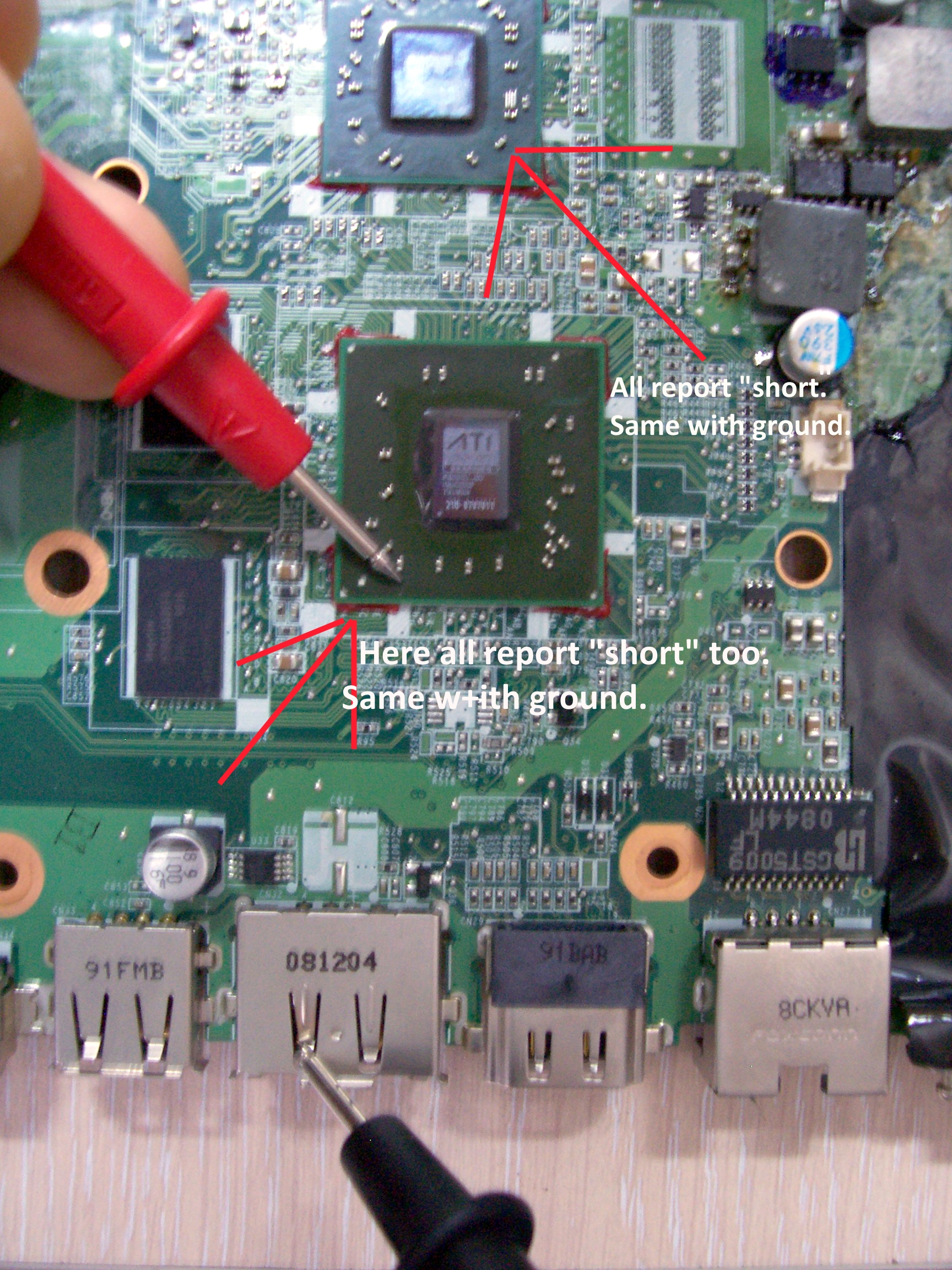

                          I tested as Th3_uN1Qu3 said. The tiny capacitors on top of both BGA Chips report a short. They are also shorted with ground ( as seen in picture below). Just for reference i've tested the distant AMD south bridge who wasn't touched at all or heated up. All of his tiny capacitors report 30+ ohms.

                            Change the shorted cap with a good one, see if you get the same reading.
                              If all caps read short, then one or both of the BGAs are dead. They share the same power supply so if one is dead then the other will measure that way too.
                              If you don't have reballing tools i would write this one off as beyond repair.
                                Indeed. I wrote this one off. Wasted too much of my time on that already when i have more important projects ahead Thank you everyone for the support on this one. Helped me alot .
                                  attention that what you showed us in the picture dont tell that cap is in short , some of the capacitors have one of the sides turned to the GND so its normal that there is continuity , alltough if both sides are making continuity than its not good .
                                  bether to test between each sides on scale of 200ohm , it you have less than 1.1 ohm , then very possible there is a problem with the capacitors or the powerrail that feed that line.
                                  very common on DV5 series , i have now one in the bench with similar problem . cheking very carefuly the 1.2v line
