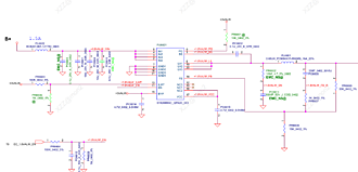

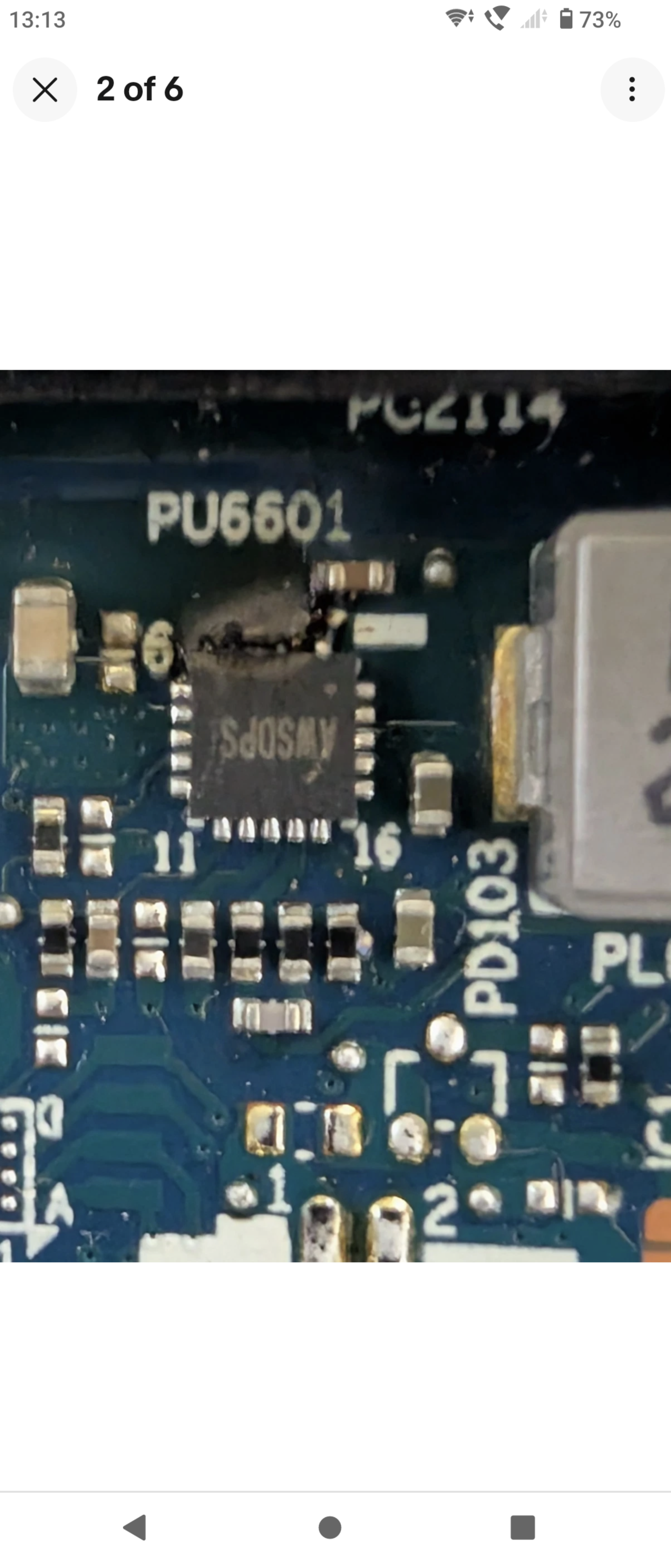

    Lenovo Legion 15ach6h ic chip fried
    Can anyone help with id for it please
    Pu6601 location on board

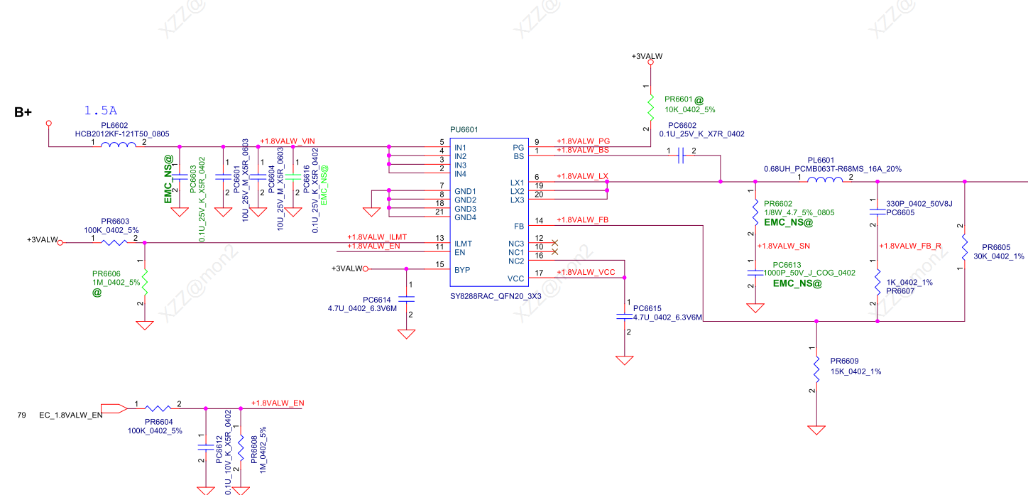

    Silergy SY8288RAC AWSxyz IC

        Correct. Flux and remove first. Clean the pads - be patient and watch lots of YT videos. Not wanting to burn the board nor remove the small PCB pads that keep this QFN package onboard. Practice on donor boards to get a feel. You will need hot air tools for sure or work with a good local cell phone tech.
        Once the regulator is removed, test the resistance to ground on the output pins to confirm there is no shorted part onboard. That is, this part did burn out for a reason and it may be due to an excessive load.

            Measure the resistance to ground of PL6601 (without power to the board). Is it with a very low resistance? Trying to understand why this regulator fried.

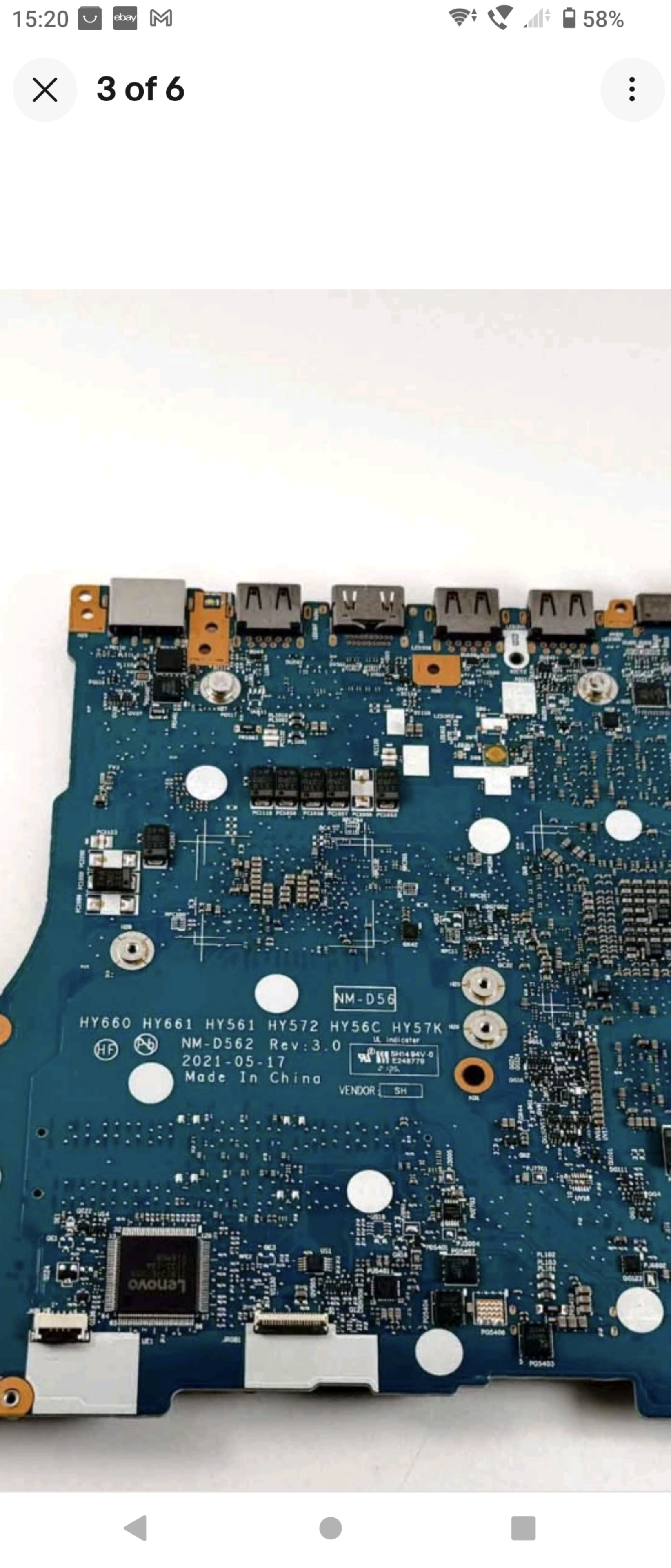

              Thanks for your help. Unfortunately upon chip removal there is evidence the chip exploding has caused irreparable damage to the board surface.
              So I have ordered a second hand board with. Same part number etc,
              This has a fault of its own but I don't want to but new just yet,
              It goes no display but displayed on hdmi previously apparently if swap my old bios chips from old board to new, will this retain the s/n etc from the original laptop.

                  It is indeed an Nm-d562 rev 3.0 Both are Ryzen 7 5800h motherboard with 3070s

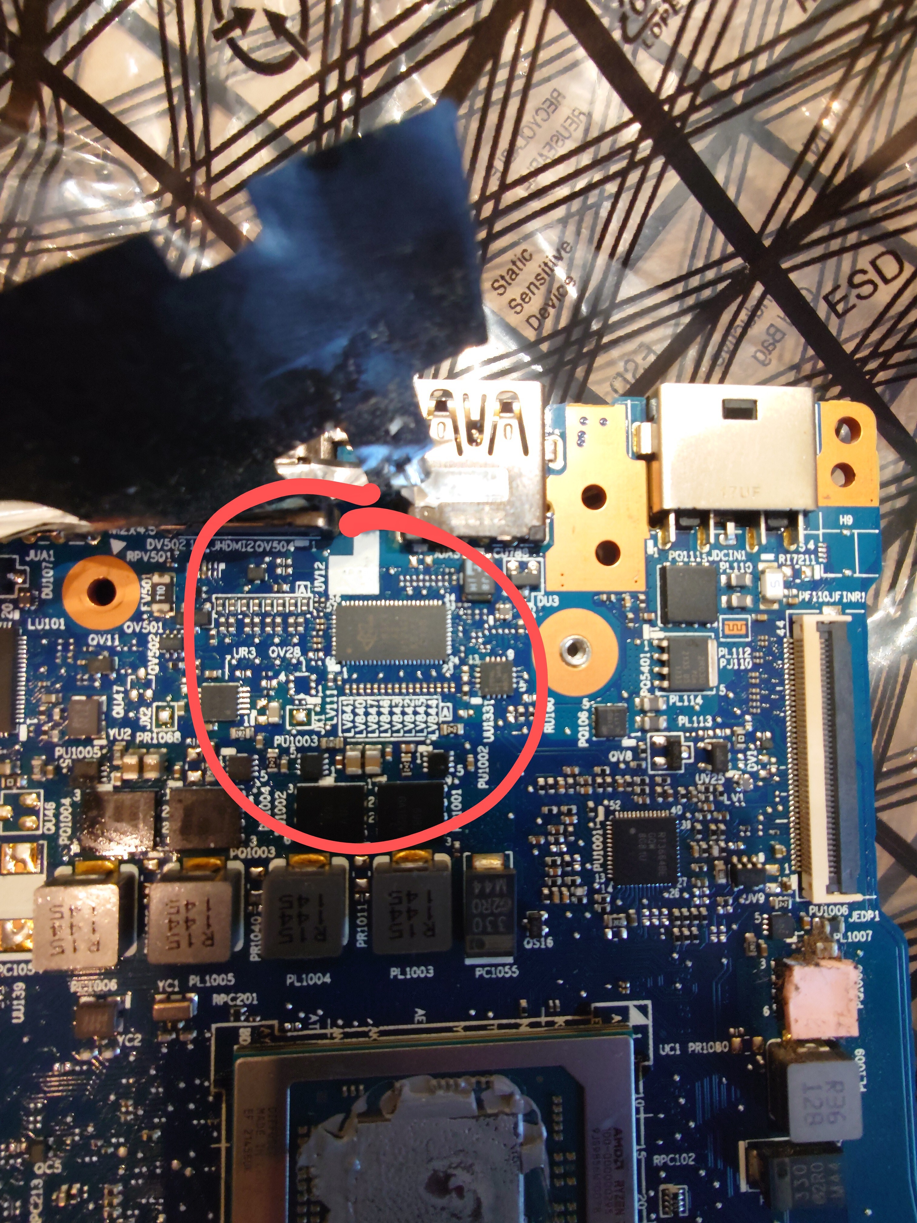

                            I don't have a great understanding of schematics, I did have look and all it did was confuse me.
                            I can't seem to find uv12 on the board or the temp ic chip for the apparent shut down issue
                            Am I looking in the wrong place,
                            I've attached pictures of the old board could you circle the area I should be looking in. Sorry to be a pain.
                            Thanks for all your help.

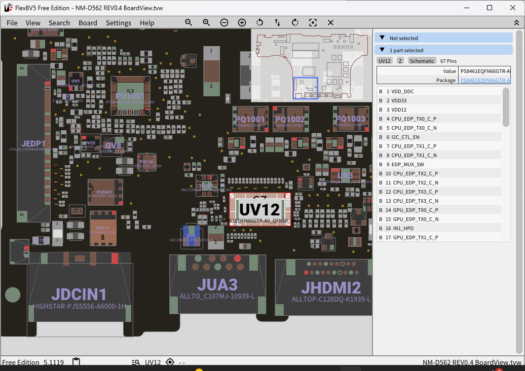

                              The boardview should help https://www.badcaps.net/forum/troubl...10#post3178010
                              Open with FlexBV Free https://pldaniels.com/flexbv5/
                              UV12
