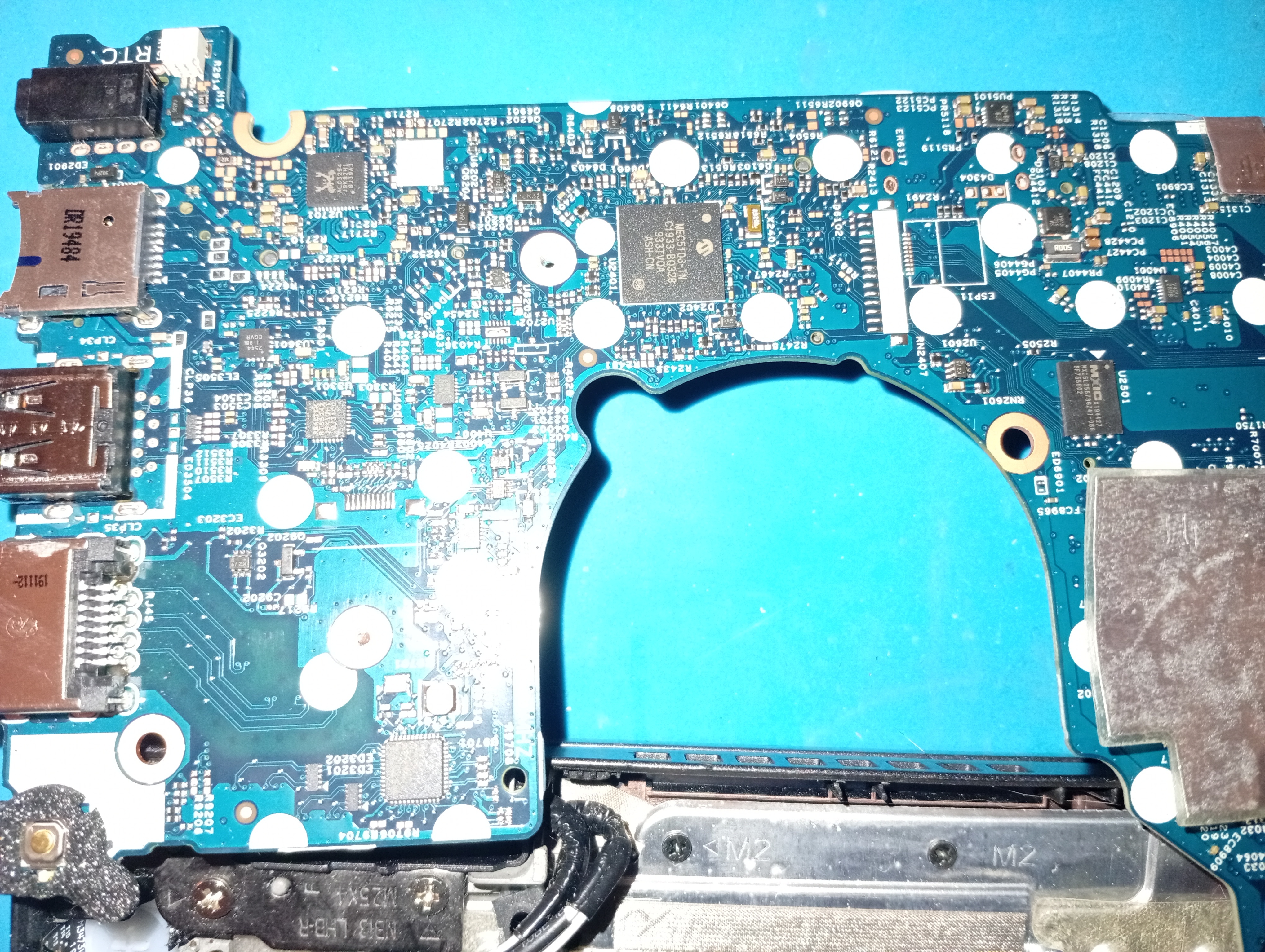

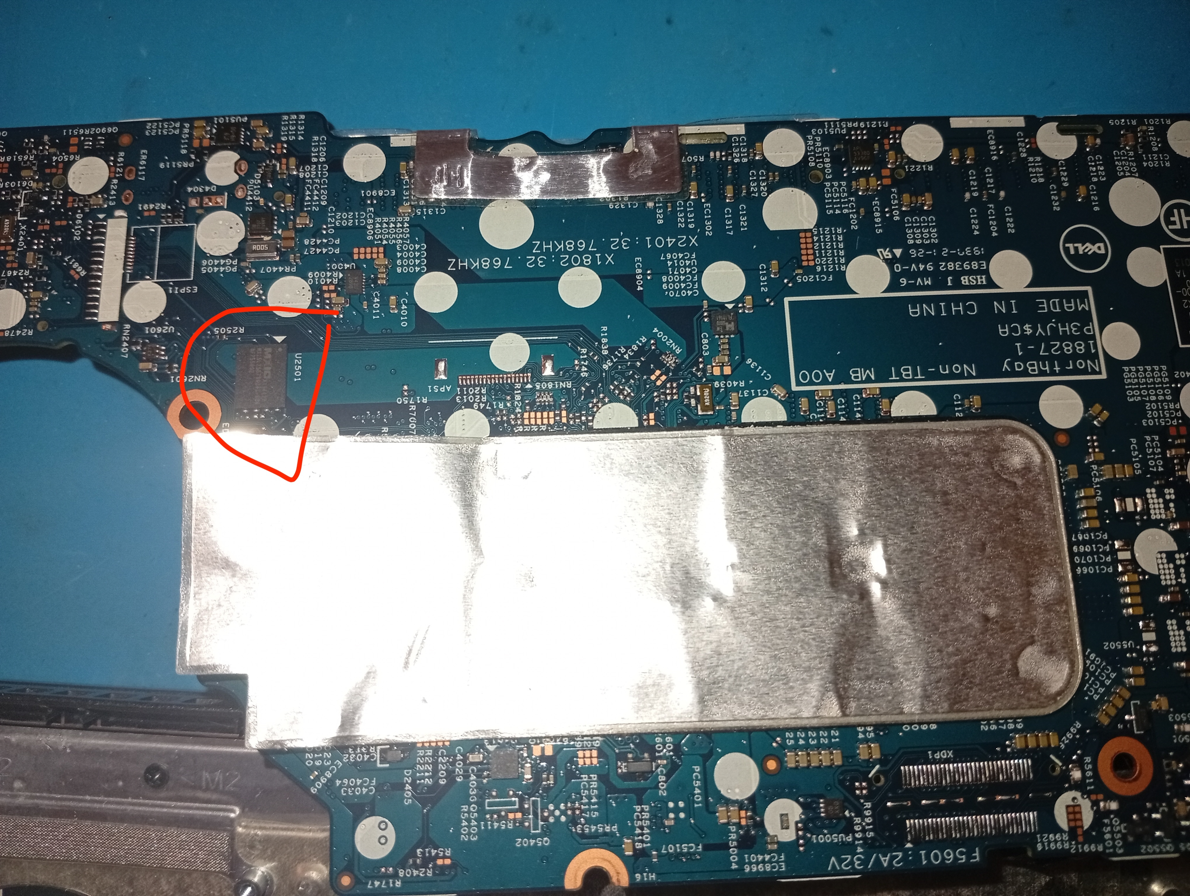

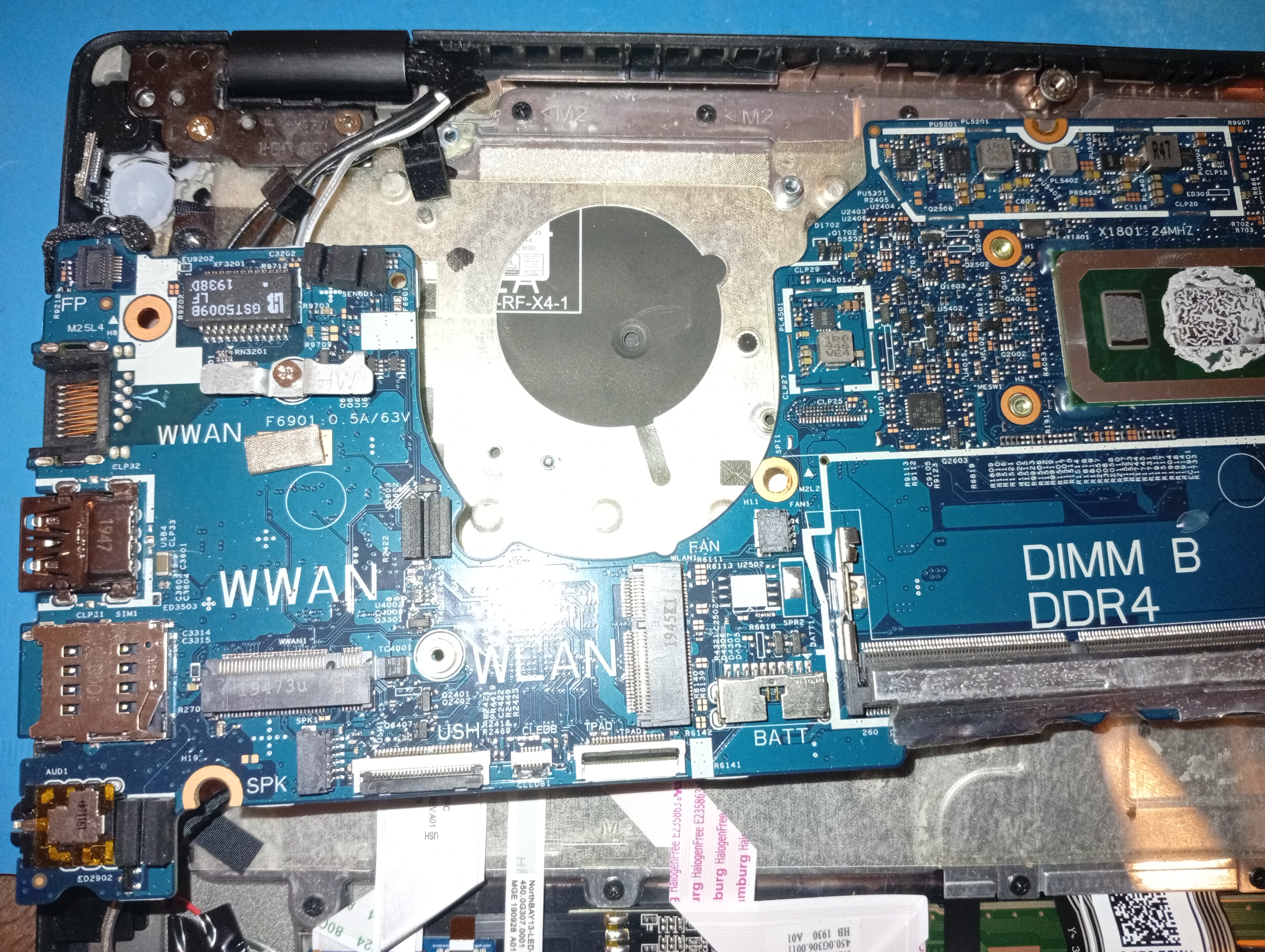

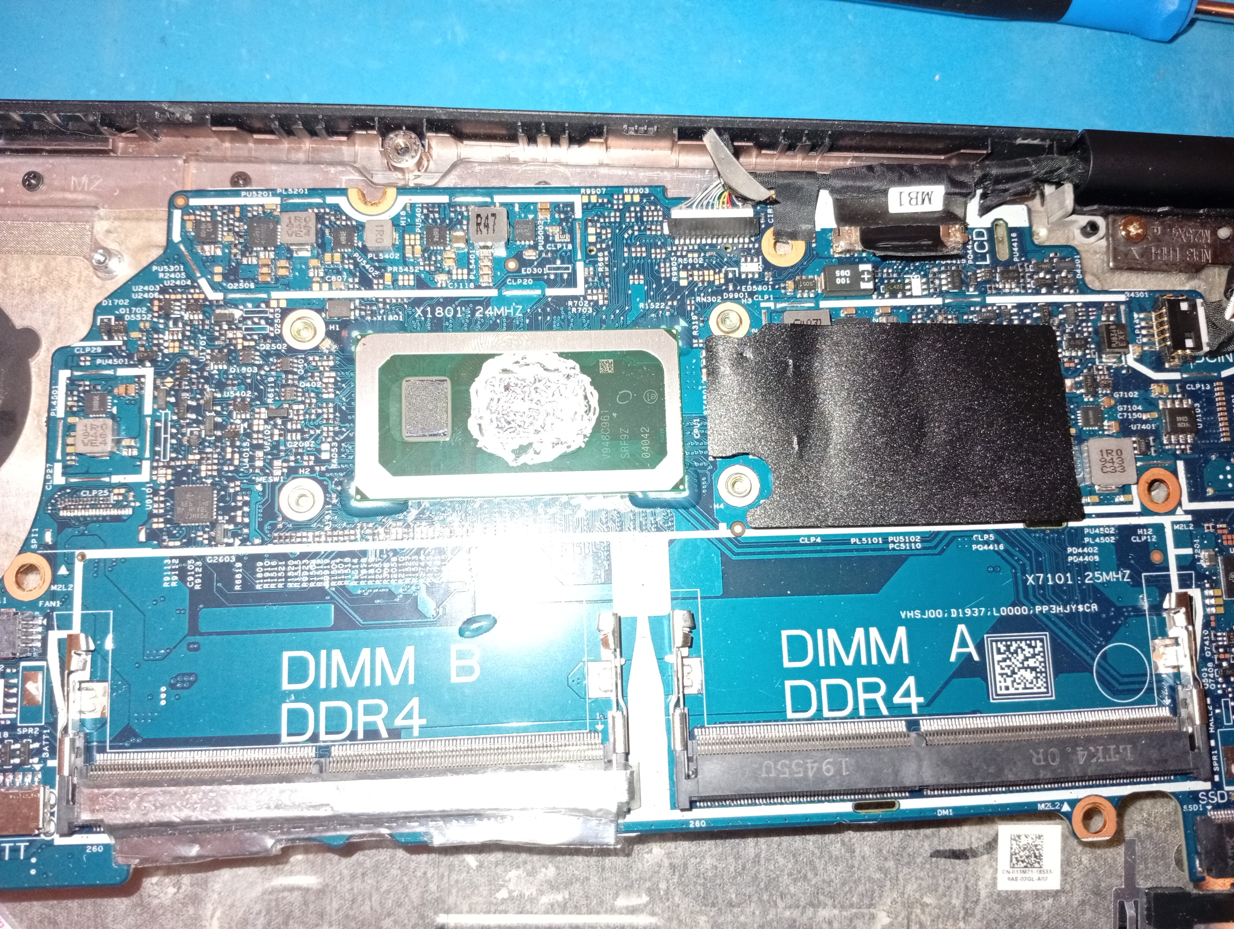

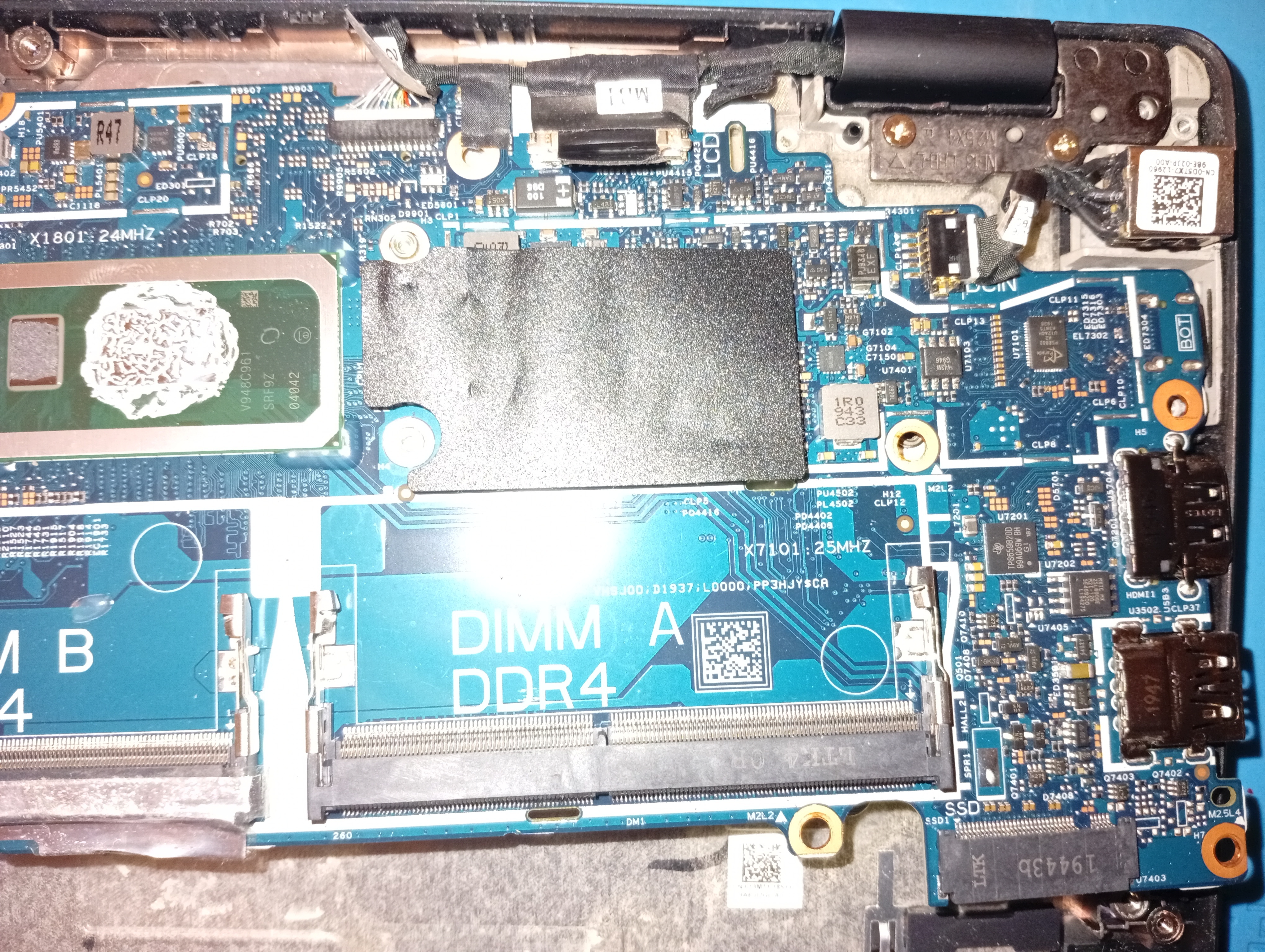

    Hi!

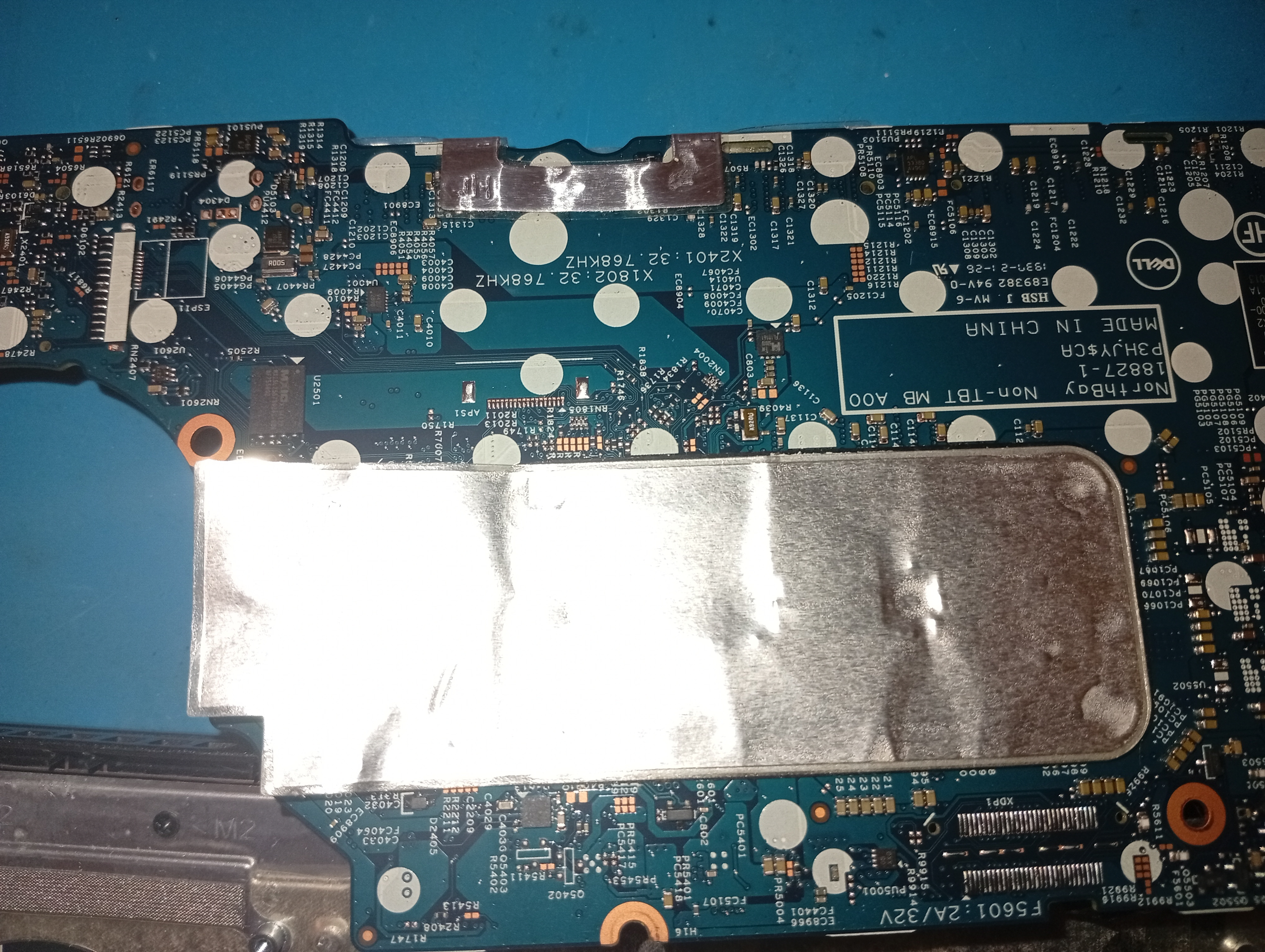

    I have BIOS locked by admin password in laptop Dell Latitude 5300. I already disasembled laptop and i can't find BIOS chip. Can someone help? I attached motherboard pictures.

    U2501

      U2501

        Originally posted by anhbanxoi
        U2501
        thanks

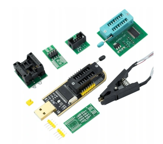

        Another question.
        I have this programmer, Click image for larger version
Name:	Zrzut ekranu 2025-07-05 081832.png
ID:	3675262 is there a adapter for that chip?

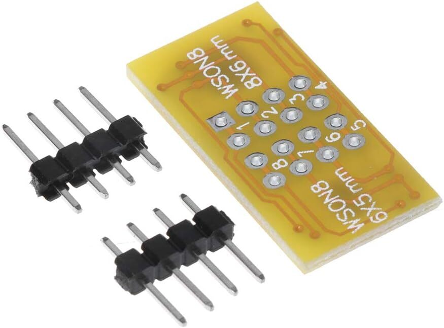

          Hello friend,
          No, but you just have to buy WSON8 to DIP8 board like picture attached.

              OK i flashed It I was using hot air to desolder and some kynar wires to connect to progrmmer and NeoProgrammer for programming. First i was strugling with tiny wires mostly used for trace repair but i was to hard to solder kynar wires was better idea.
