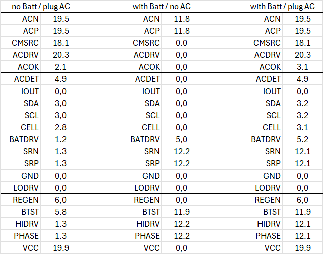

          Thanks, really, the battery on the tester is dead. Here are the correct readings.

          • mon2
            • Dec 2019
            • 14307
            Can you link a schematic (if available)?
            The measurements are better but there are still some issues.
            Review the VCC pin on the charger IC. There should be a SOT-23 packaged (3 pins) dual diode (common cathode). When you apply only the adapter, VCC is powered OK.
            When you apply only the charged battery, VCC = 0 volts. There is something wrong here. Most likely the dual diode is defective and needs to be replaced.
            Remove all power. Meter in resistance mode.
            Locate the 2 x DCin mosfets that mate with the charger IC and will be before the ACP / ACN pins.
            Measure their resistance as follows:
            source (1-2-3) & drain (5-6-7-8)
            source (1-2-3) & gate (4)
            gate (4) & drain (5-6-7-8)
            Post each measurement. Each measurement must be hundreds of k ohms or higher else could be a defective mosfet.
            Concerned about the ACDRV voltage which is about the same as the power adapter voltage. Often this means the DCin mosfets are defective. Most likely it will be the first mosfet but do measure the resistance of both mosfets. If the mosfets are NOT defective then ACDRV voltage = adapter voltage + REGN voltage = 20v + 5v = ~25 volts on the gate pin of the DCin mosfets.
              You're right, the first mosfet was breached. I replaced the mosfet, everything worked! Thank you very much!!!
