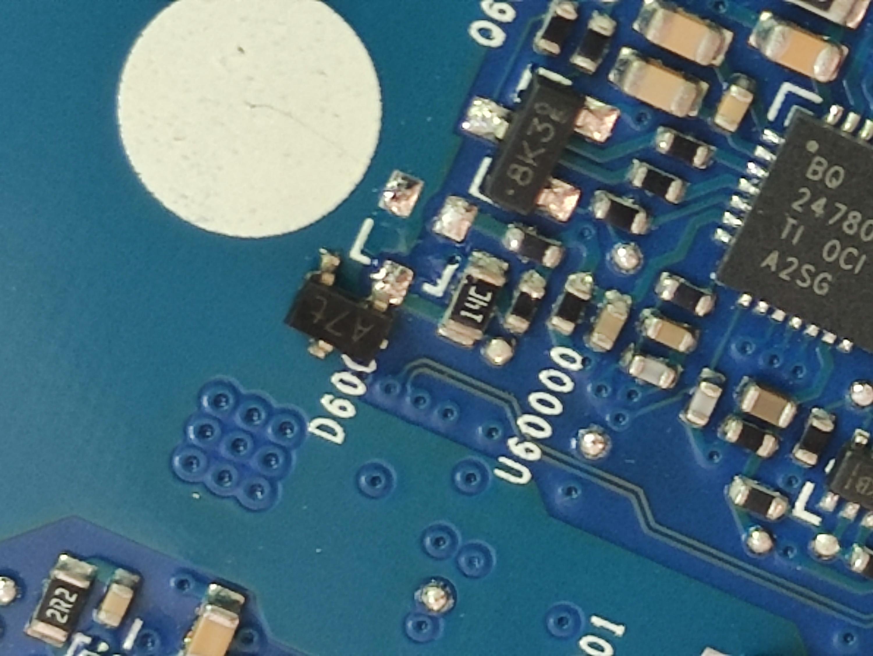

    Just need a sanity check on this one. I have an Asus G513 ROG lappie here dead as a door knocker. No volts getting past the first FET. Has a BQ24780S charger IC at least, but no schematics or board view.
    So ACDET is low at 1.7V, REGEN is also low at 5.4V. On the ACDET pin, there's a few resistors etc and also a SOT323 package marked A7t. Now in my searches this is a BAV99W dual diode. But the datasheet doesn't actually confirm this marking either. I haven't found this diode on any other board either just to compare to. It definitely doesn't meter right, I drew this out, and it seems to be some kind of clamp on the ACDET pin.
    As I don't have schematics, not sure. I don't have any other dual diode package in this config on any other board. Can anyone confirm that A7t is a BAV99W? I've desoldered and moved it over on this picture to check it, definitely reads bad.
    Motherboard number is G513-6050A3249301-MB-A03

    With that out of circuit, my ACDET is spot on 2.6V, REGEN is 6V. Haven't gone any further than that, Guess I'll just order it.

        Re: Asus G513 dead
        BAV99W in SOT323 package. Sure about it

          Re: Asus G513 dead
          Many thanks. ACDET was fine after removing it, but still no ACOK. Realised pretty quick there was a short on the +19V rail. Was a shorted cap under the heatsink near the CPU (that Seek camera has paid for itself many times over).
          I don't have that diode but it works currently without it. Pretty sure it's some protection device although I'm not clear what the reasoning is.

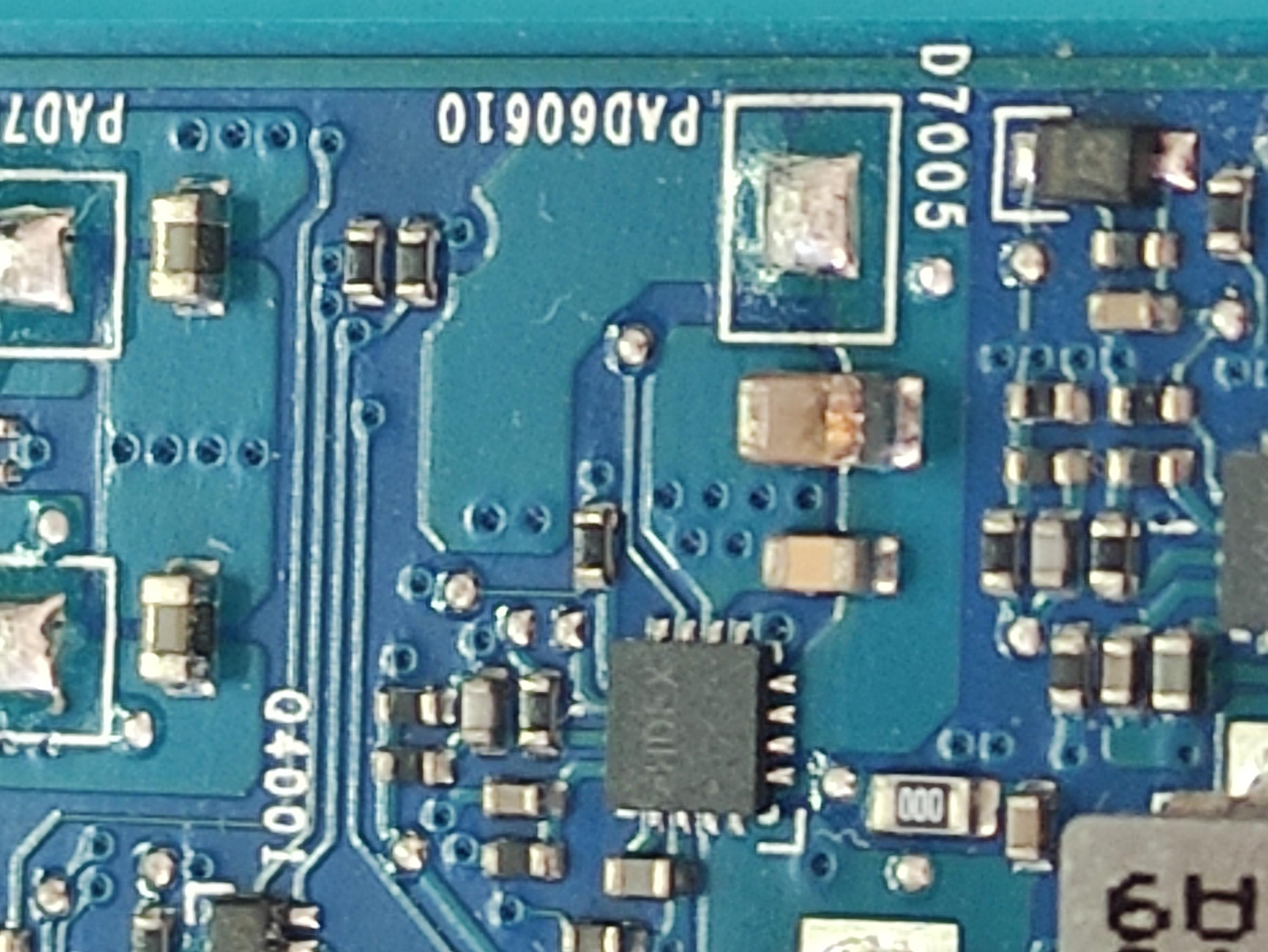

                  • reformatt
                    • Feb 2020
                    • 1507
                    Re: Asus G513 dead
                    Was a cap on the edge of the board. Heatsink needed to be removed to get at it. Can't tell you a component designator, closest point of reference from the silkscreen was PAD60610. As it was a just a decoupling cap for a buck converter input and no schematic etc, a 10uf would probably be sufficient, but put in a 22uf 0805 to be sure.
