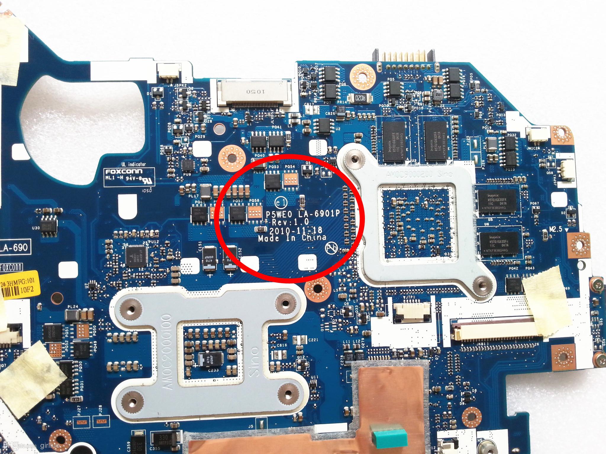

    Hi guys,
    I bought a Packard Bell TS11, which have the same motherboard as the Acer Aspire 5750 which is the LA-6901p.
    I received it wit the folowing problem: No display on lvds, display on HDMI
    Somehow the jlvds1 connector get shorted and the coils L1 and L2 got blown away, including the pcb islands. In the schematic you see the both are drawn in a separate section op page 31, W=60 mills.
    I fixed the board as good as possible, but I do not know if from these islands something is connected to another layer (I don't see any signs) and I miss one coils.
    Do I need this to get a display?
    Can somebody pls direct me how to approach this problem. I was very happy to buy this laptop, given the specs, but now I'm afraid it might be onsolvable.

    does it power up?
    what voltage do you got on the lvds connectorr?>

        Re: Acer 5750, packard B TS11, la-6901p no display
        Voltages on lvds connector.
        pin 1,2,3, invpwr B+ = 18,80V
        pin 7, invtpwr = 3,32V
        pin 23, +3VS = 3,32V
        pin 24,25 LCDVDD = 3,32V
        Those were the results .......
        pin6, bkoff = 3,3V
          ok!
          do you see DAC_BRIG pin 26
          I see you did not put the value.
          its 0? maybe we can trace it back!
            DAC_BRIG pin 26 gives 0
            Finally find them:
            Schematics for V2.0, which is the version of the board

                    • italy
                    with or without should be the same.
                    chip u20, kb controller. pin 105 voltage with pc powered off and then when turn on.
                        page 31 of schematic. check
                        bkoff line ;
                        capacitor C8 is if ok (no short and voltage 3.3 present at one side.
                        resistor R18, if voltage present both side and resistor value. should measure 10k (when pc is off).
                        check also chip u20 pin 68 DAC_BRIG if 3.3 volt are present.
                          U20 pin 68 powered off 1,10V and powered on 0,00V
                          Do you have a way to find the components, because most of the C's and R's are not printed on the PCB, see picture above
                          Think I found them, both is from pin 6 of jlvds1 to ground.
                          C8 no short, 3,31V at power on
                          R18 , 9,87k , 3,31V at one side and 0,00 at the other side (=gnd?)
                            dac_brig if 0volt give max bright to lcd when inv power is ok.
                            when dac_brig is 3.3 it give low bright so 1.1 is in the middle and is ok.
                            the command that turn off the lcd is that bkoff. if 3.3 volt are present it power off lcd.
                            for me or a bga video problem, or dunno what component sent the signal to switch the lcd off. kb controller commanded by keyboard combination or hdmi is present signal ?
                            edit to trace that c8 and r18, look at pin 6 of lvd connector, and found them. one resistor and one capacimeter and i suspect they are ok, as the signal start from chip u20 .

                                  • hansie55
                                    • Dec 2013
                                    • 254
                                    • Netherlands
                                    I think I have to put back L1 and L2, because now I do not have +INVPWR_B+ anymore on jlvds1--1,2,3,.
                                    Do I have to use the precise same ones or can I use any kind?
                                    • cyberhack
                                      • Feb 2013
                                      • 466
                                      • Uk
                                      L1 L2 are the inverter supply if they are missing then no inverter ok page 35
